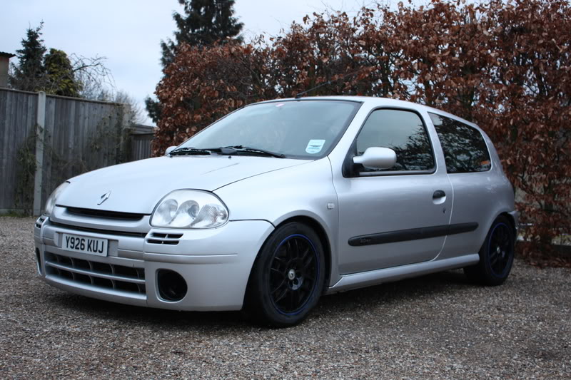

Fk coilovers fitted
My god how awesome. Have them hard all the way round for now, as it was going dark.
May have slammed it to much on the front as its rubbing a little when turning and going over bumpy ground.
Did an educated guess at making sure the height and camber were the same at the front.
However, going to get it set up properly.
Any ideas on cost of this? And should i get it done straight away, or wait for them to settle?
Pics to follow when daylight :)
Coby.

I put 10mm spacers either side anyway and am now running full camber. It was hard to set up an exact degree so just ran full negative, it doesn't look odd though, it looks how it always did on standard suspension and running pull positive the wheels look like this \ /

This is mine on full neg camber, doesn't look more than what it was standard

I was going to just cut it off :) It loked spot on how low it was :)
