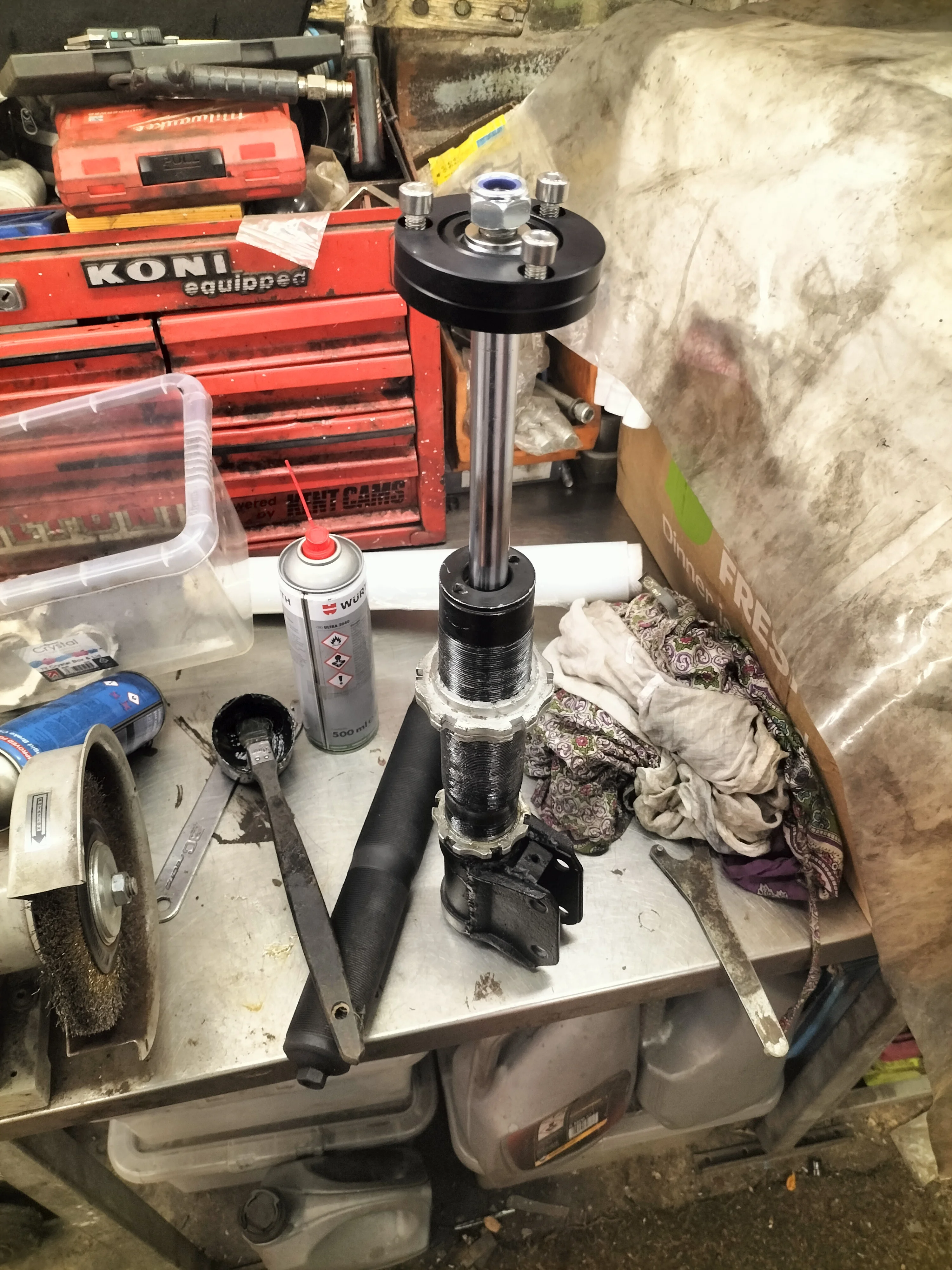

Last year I thought I'd make it very low, so I did. I made some very short coilovers for the front, modified Lupo coilovers to fit the back, raised the engine and box and chopped and plated several bits that were in the way.

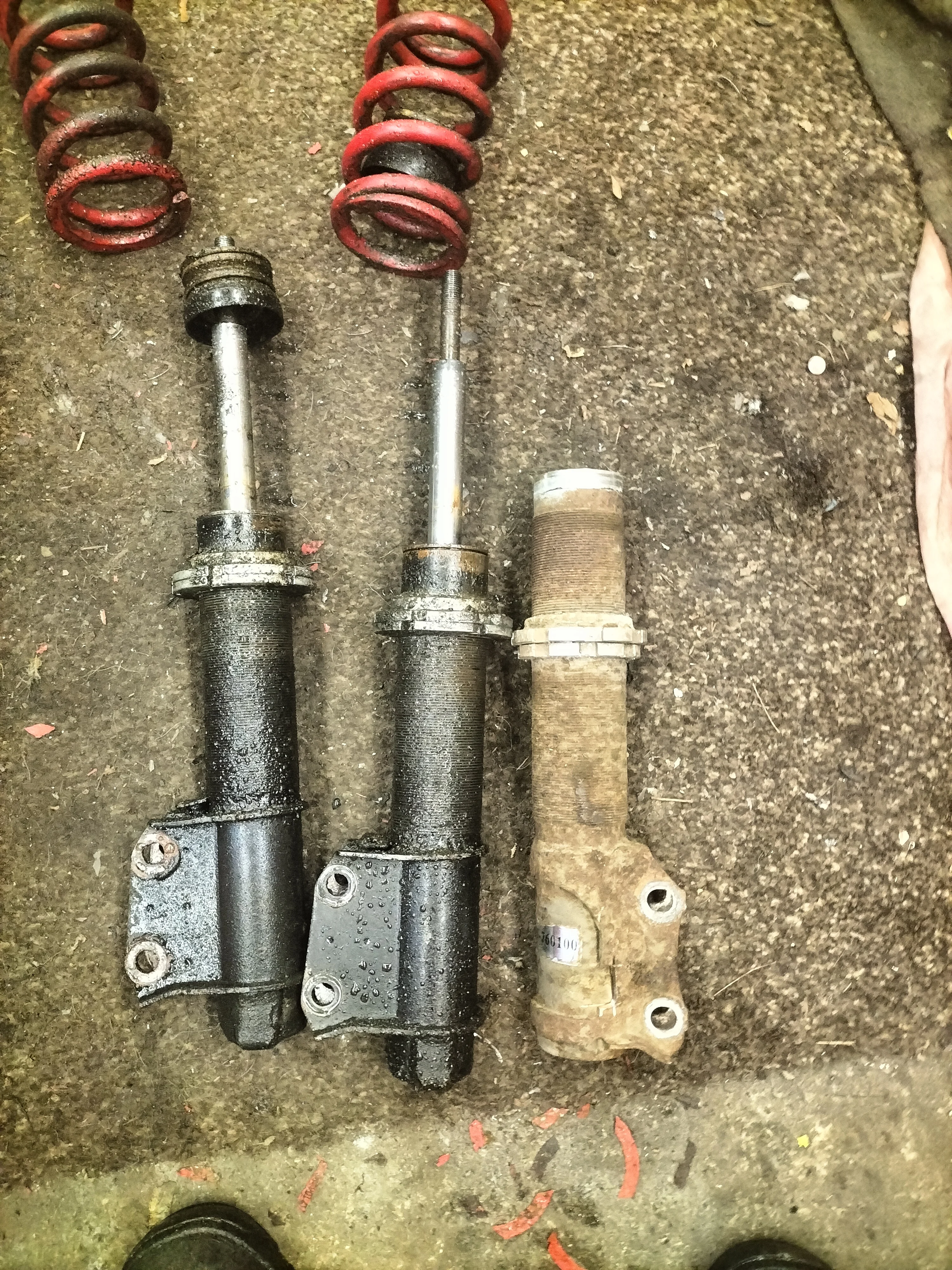

I've had several silly low cars and they don't do well in standing water at motorway speeds so decided to raise it up autumn/winter and go back to 195/50 tyres so I could put Rainsport's on. Tried raising the suspension that was on it, but to clear I had to wind the preload up that tight that the car had no rebound travel at all, which as I expected was properly terrifying. After a couple of months my bum hole couldn't take it any more so I built another pair of front coilovers with separate preload and ride height adjustment, added some adjustable shocks and some Mike Arter top mounts.

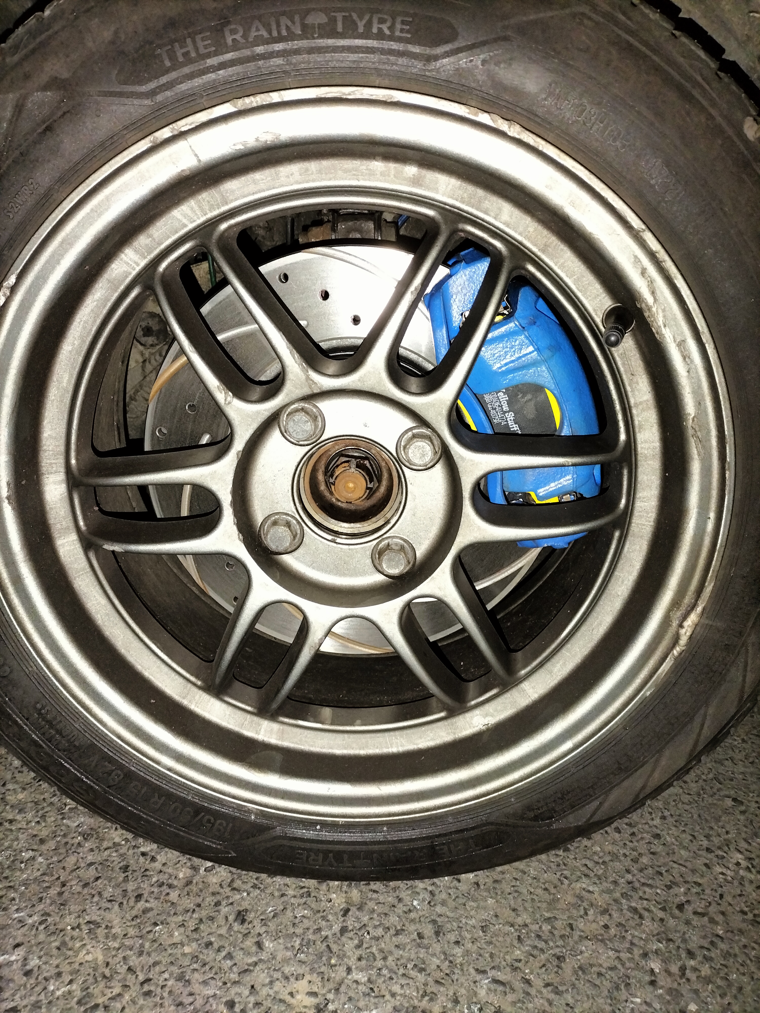

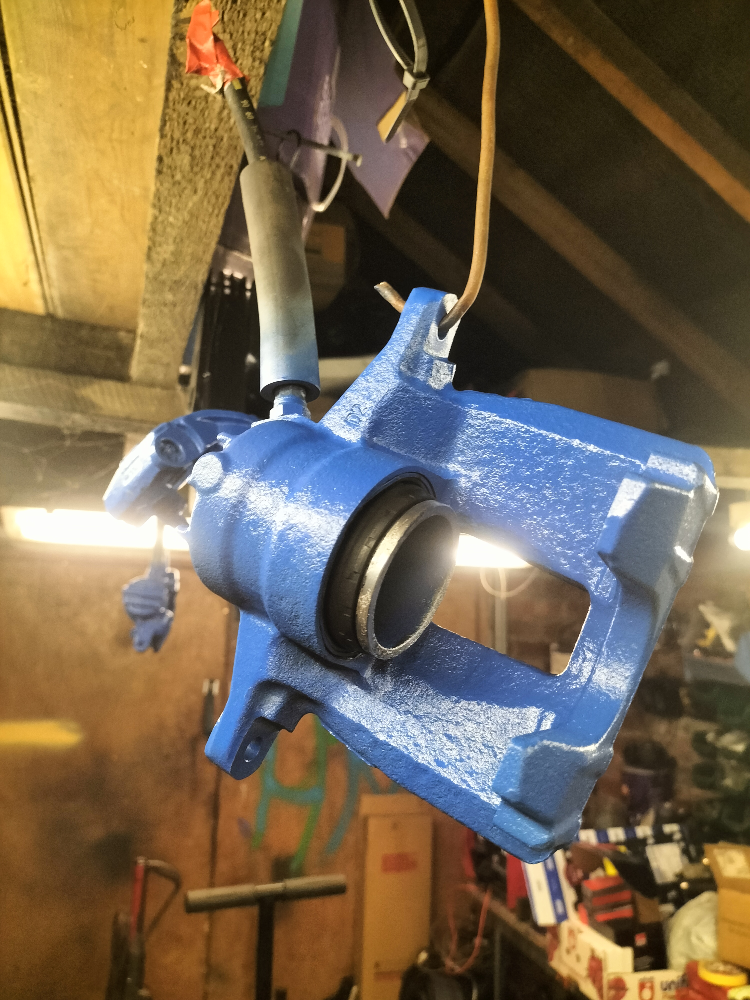

My "easy" commute is 35 miles each way up and down the A1 which the car was great for. However some evenings when I feel like it I can also use pretty much only white roads to do the same journey. Even with good discs and pads I was overheating the brakes so after speaking to a guy called Adey who did a F4RT 1.2 Twingo he pointed me in the direction of Peugeot HDi calipers and 280mm Clio disks working with the non Sport hubs. I've done it on the cheap for now, but thought I'd clean and paint the calipers before I eventually get round to fitting them. Got some drilled and grooved discs because they were £20 on FB marketplace, Yellowstuff Pads because I get a mega discount on them at work and braided lines but should be plenty.

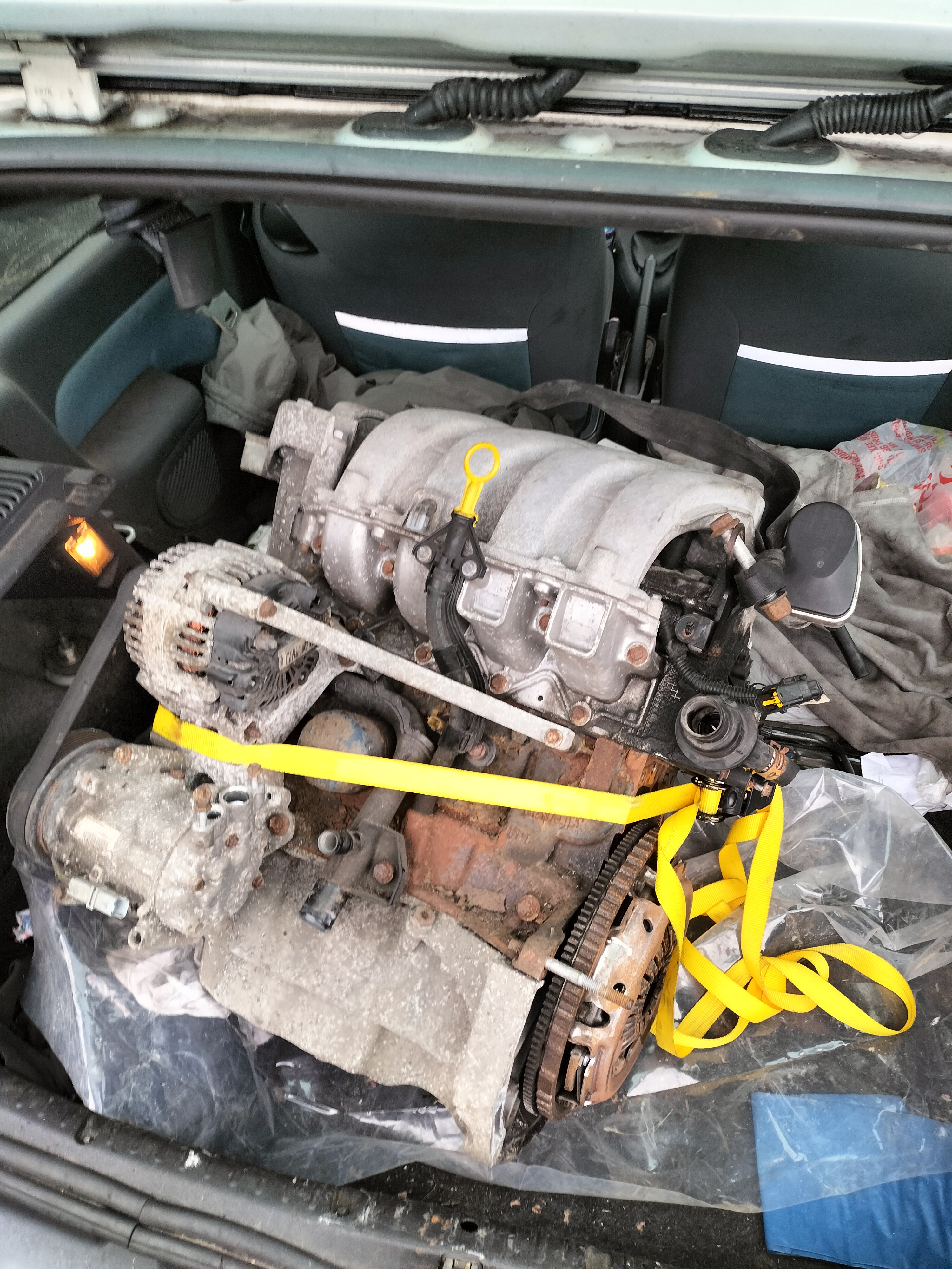

And then drove up to Newcastle and picked a engine up. I've got set of very specific requirements for what I want this to drive like, and a F4R swap doesn't fit that, plus at my age if I wanted a F4R I'd just buy another 172 as insurance is cheap as chips.

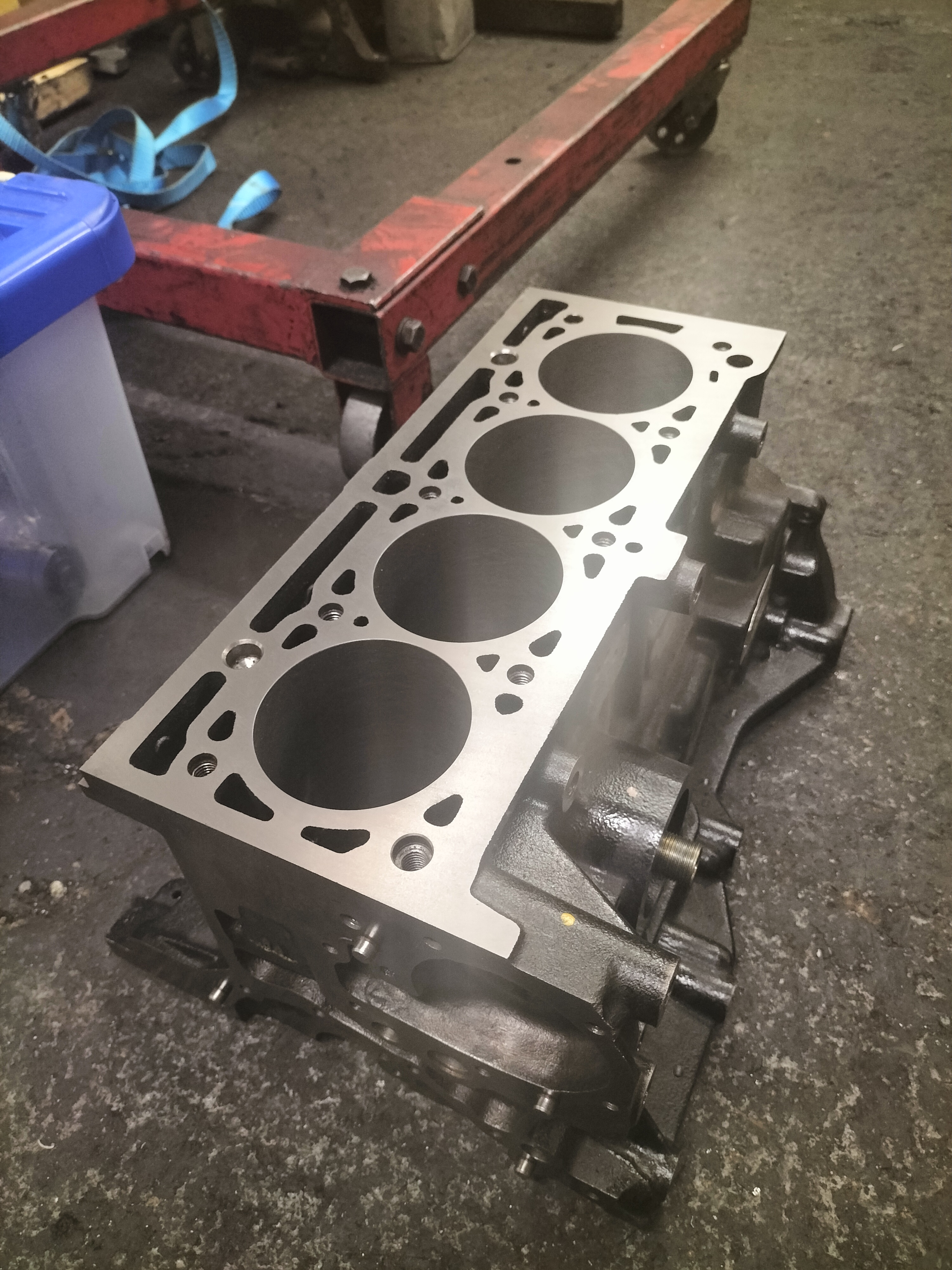

I can't use the Twingo block as the bell housing end is wrong, so I pulled a brand new (yes really) Mégane block out of storage, gave it a fresh hone and my colleague fly cut the deck face as I wasn't happy with the standard finish.

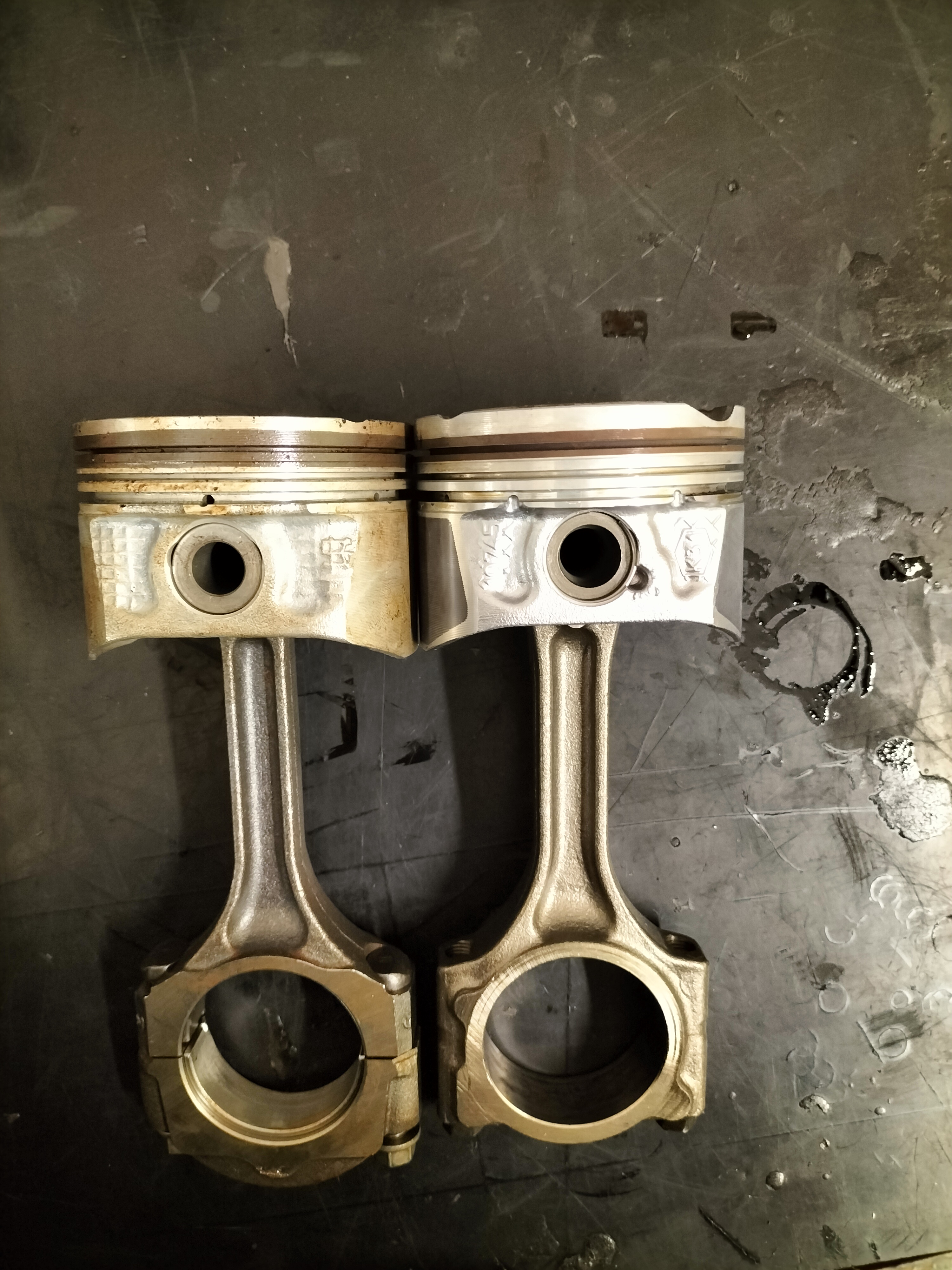

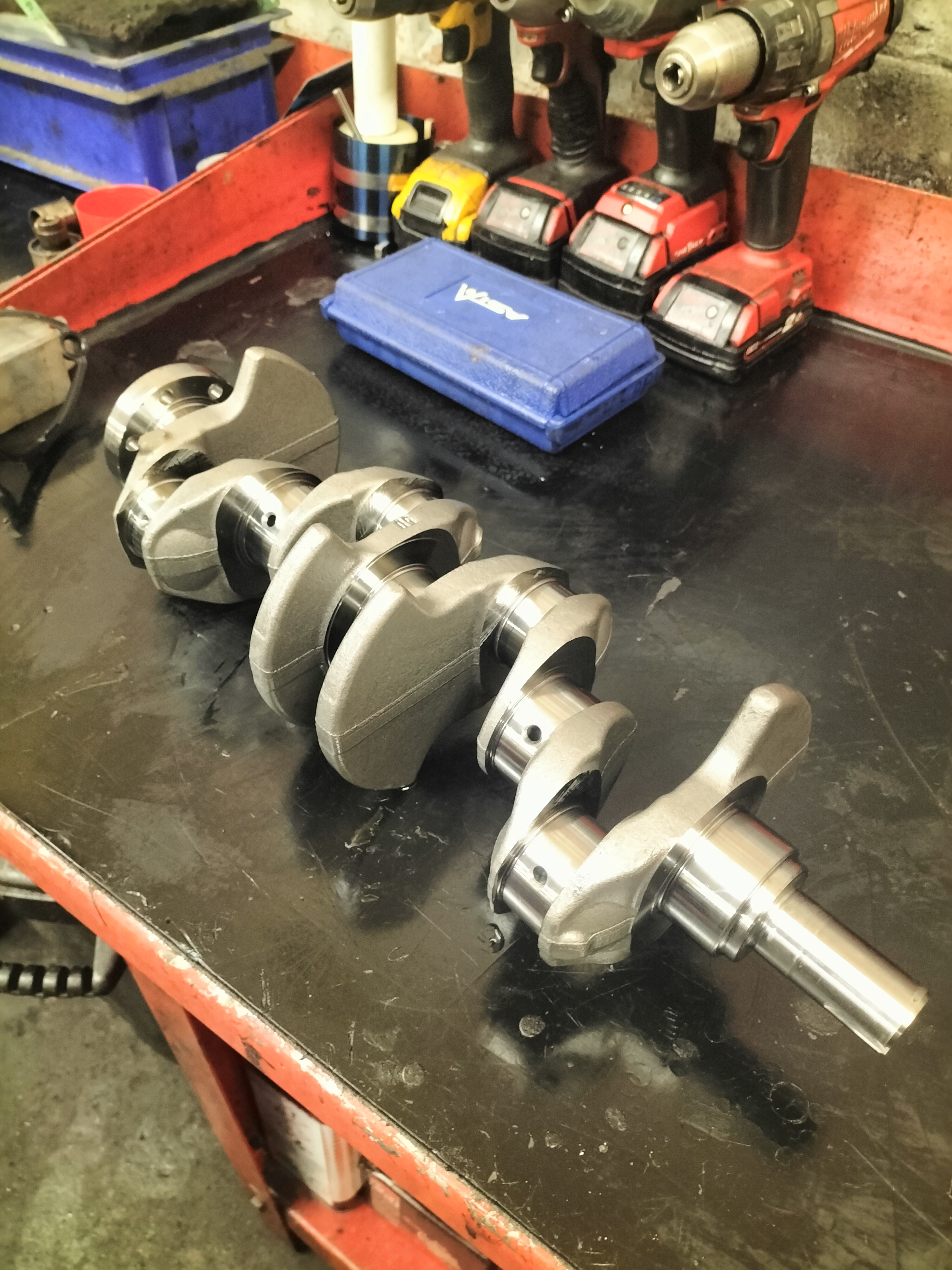

Got the Twingo rotating assembly cleaned and polished ready for balancing. Will do final clean up once that's done. The Twingo rods and pistons are quite a lot different/lighter than the stock K4M stuff so should help it rev. Think I'll stick with new standard bolts for now, they'll hold up to a M9R piston swinging round on them so should be fine.

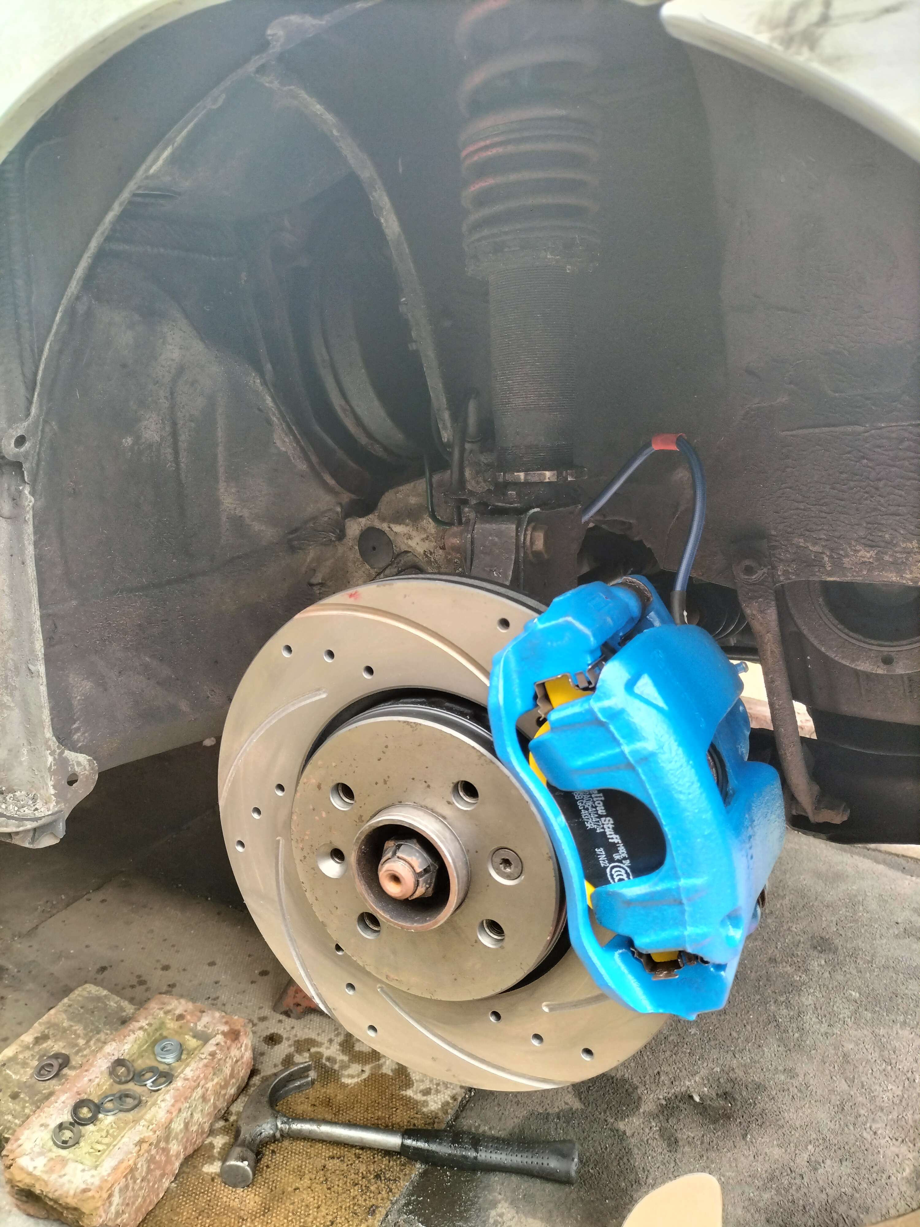

Got the brakes on, they work great but I'm not a fan of the longer pedal travel required so going to upgrade to a Sport master cylinder when I get round to it.

Much more confidence inspiring now, can really scrub speed off quickly.

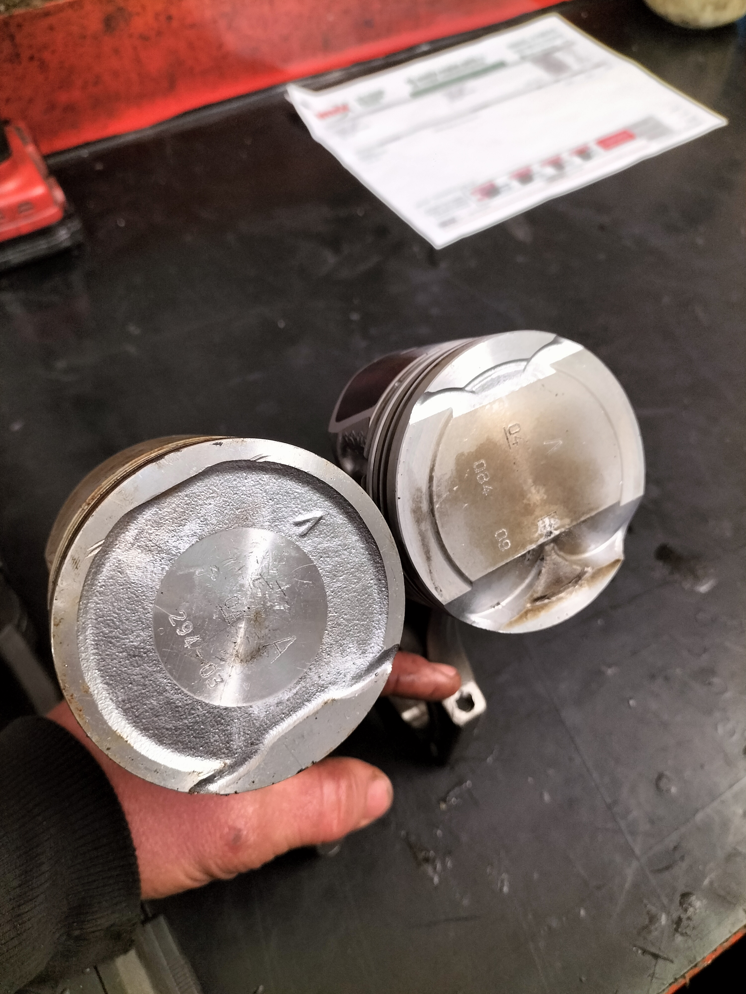

Just seen the new piston pics. Should give a fair increase in compression, interested to see how it all comes together, keep the updates coming mate (y)

@stealthstylz After doing the 280mm brake conversion the brake pedal feel is different ?
Yeah, the caliper pistons are much larger than standard so require the master cylinder to move more fluid to achieve the same pressure, hence you have to push the pedal further to do that. The brakes are actually more progressive than standard, but because you have to push the pedal further it makes it harder to heel/toe downshifts during heavy braking as the pedals get too far apart.
@stealthstylz have you had chance to change over the master cylinder?
I have been running this conversion for a couple months and getting on well with it. Prefer the linear feel so much more. I have 182 MC ready to go in and was wondering how you got on
No I haven't swapped it, and I don't think I'm going to. Now I've got used to it they're really good. General driving they're much nicer to use that the sharp feeling stock brakes, and then they're very progressive when you need to stamp on them hard.
That's what I was thinking... If MC fluid/pad pressure is the same as before and the pedal progression from the bigger calliper cylinder feels good why mess with it 🤷‍♂️
