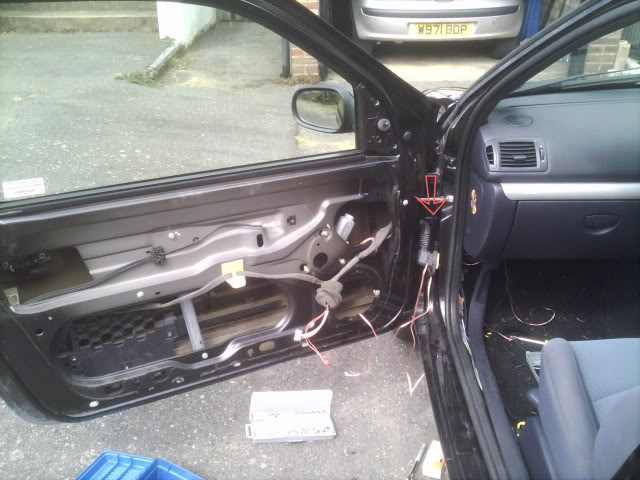

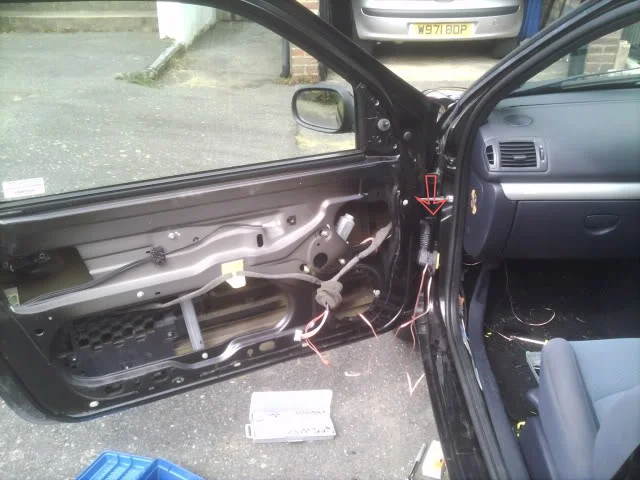

How did you feed the wiring to the doors?
Basically, I wired it through the rubber door loom thing using a straightened coat hangar. Then to get it through the plastic connector into the actual car shell, I found two holes in the connectors that didn't already have pins in them, then forced a tiny screw driver through, careful not to move/damage any existing pins and then threaded the new speaker wire through it all, before putting it all back together again.
Probably the most complicated way ever, but it meant I managed to get it through the existing connector, leaving all the existing pins/wiring intact and not have to cut any of the rubber cover thing!
*Photo doesn't really show much as I was halfway through, so hadn't threaded it properly, but still.
