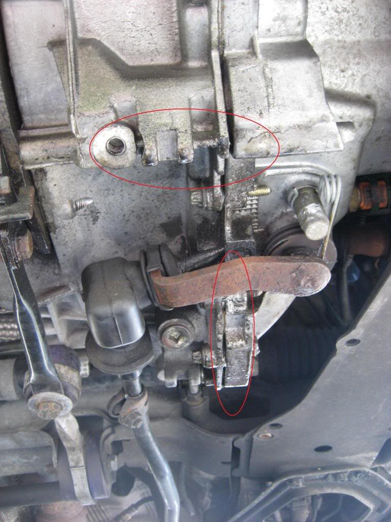

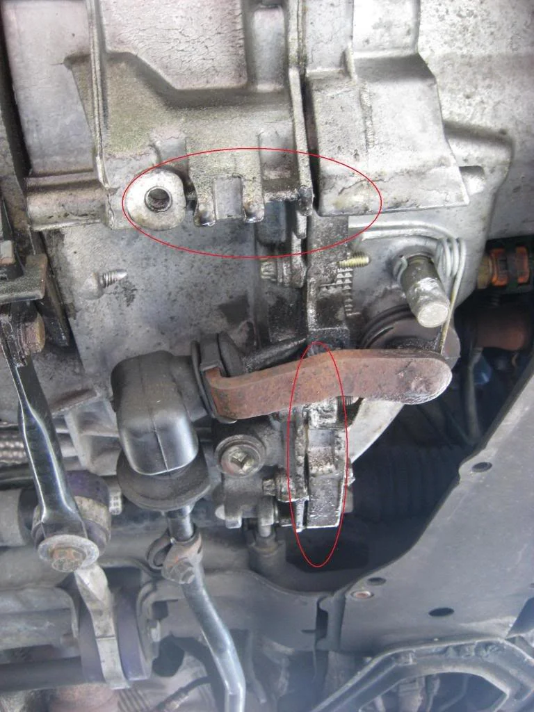

Here's a picture I robbed from the internet for reference (Ignore the circled bits)
Ah I see the circlip now, it's under the rusted selector in that picture above and you then pull down the ball socket and remove the rod.

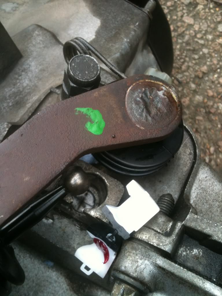

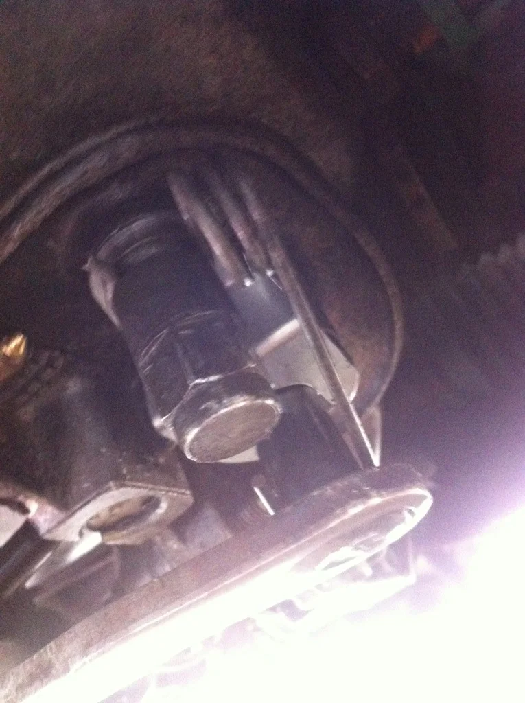

Again, robbed picture from the interwebs!
The gaiter shown int he above pic, is that the one you remove? Not the one at the end of the long selector?
stretch the gaitor over the selctor shaft and do the same to refit it once the seal kit is fitted. you also keep the spring (don't bin it)
the u shaped part is for pressing the two half pieces in. the old seal needs to be popped out of position(i used a blunt 1 1/2 chisel to pry it down) tin snips or similar is ideal for cutting the old one out watch you don't damage the actual shaft whilst prying and cutting it..

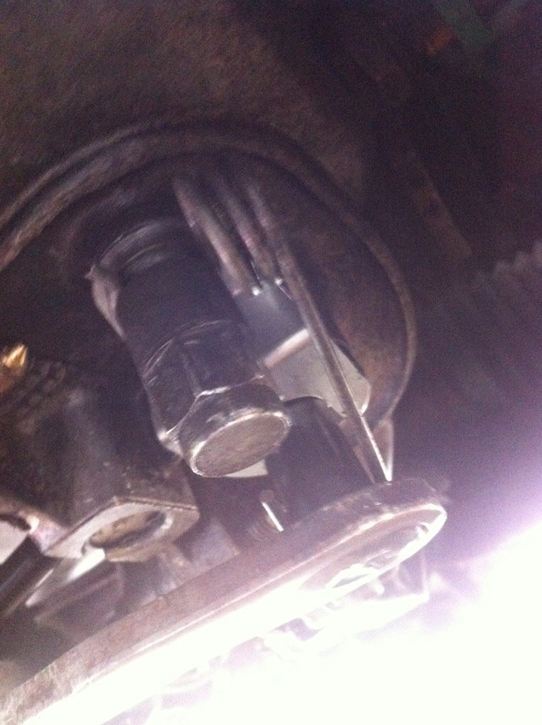

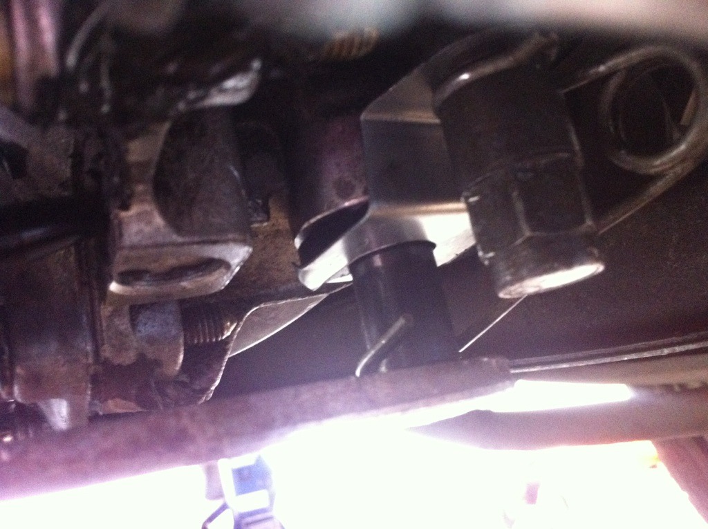

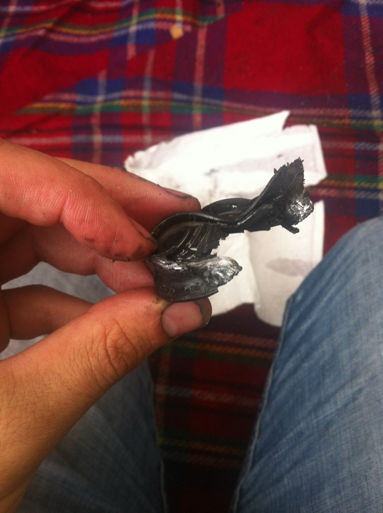

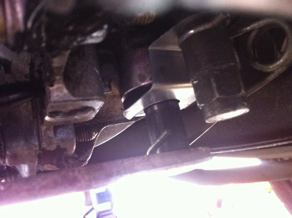

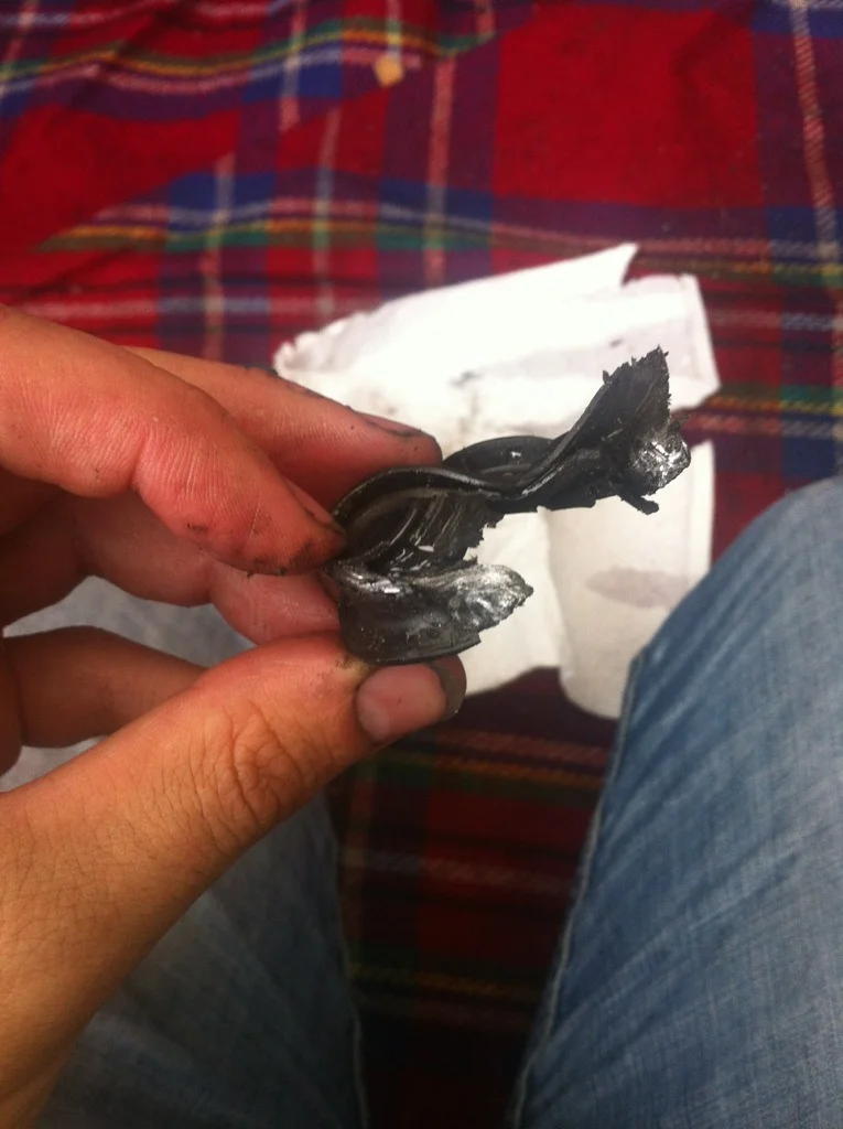

Hey Martin, I did this at the weekend and wow, that gearbox seal is a right nasty piece of work to remove. I didn't realise it was metal inside! I had to get a hacksaw to remove it!
Apart from that the only problems were getting the 2 plastic pieces back into the hole, that took a fair bit of time and patience, and I had to drain the box, I've no idea how you would attempt this and not drain it. As soon as you undo the bolt holding the spring oil comes flying out!

Glad you sorted it mate. So in the second pic that bolt that the spring locates in started leaking oil once you undone it?? I never thought the box oil came from there?
Yea oil started flying out, made a right mess of my garage as I wasn't prepared for it. Strange it has no washer though.

For others doing this, a spanner below the pacman shaped plastic piece to knock the new seal in helps!
