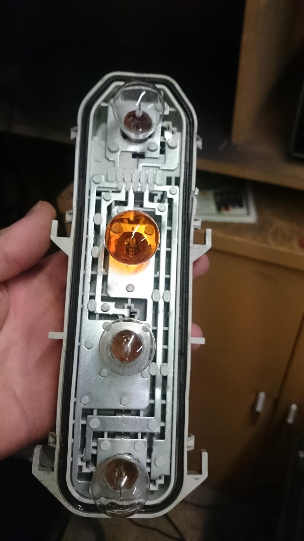

Hi when i press my brake pedal or turn my indicator arm the rear orange fog light on the display flickers.Now ive read a good few posts about poor earth on the clusters etc and ive checked everything and cleaned everything but it is still doing it .the earth wire is making good contact with bolt as when i rub it on the metal i sparks so its making contact ,ive checked both lights and cleaned all plugs.any help most appreciated on this please.
  clio v6

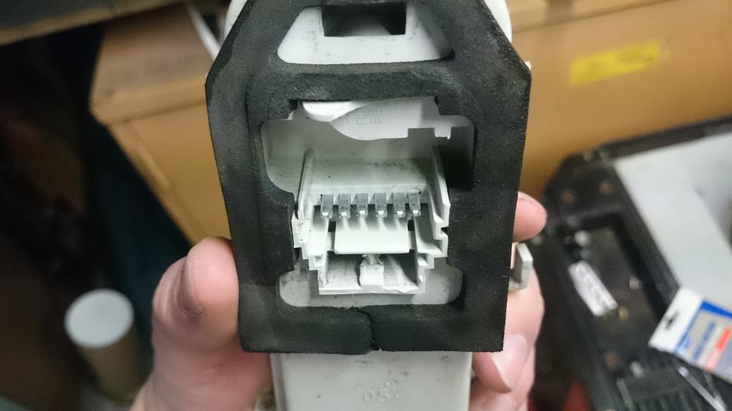

Its ok ive sorted it lol.bent the contacts a bit further on the plug on drivers side and is ok now.:spanner::up::smile:
  clio v6
The plug that goes onto the bulb holder i closed the pins tighter and all is ok now .so if anyone has this problem it can be either a bad earth contact or the pins in connector not contacting tight enough.but im sure most will know this.

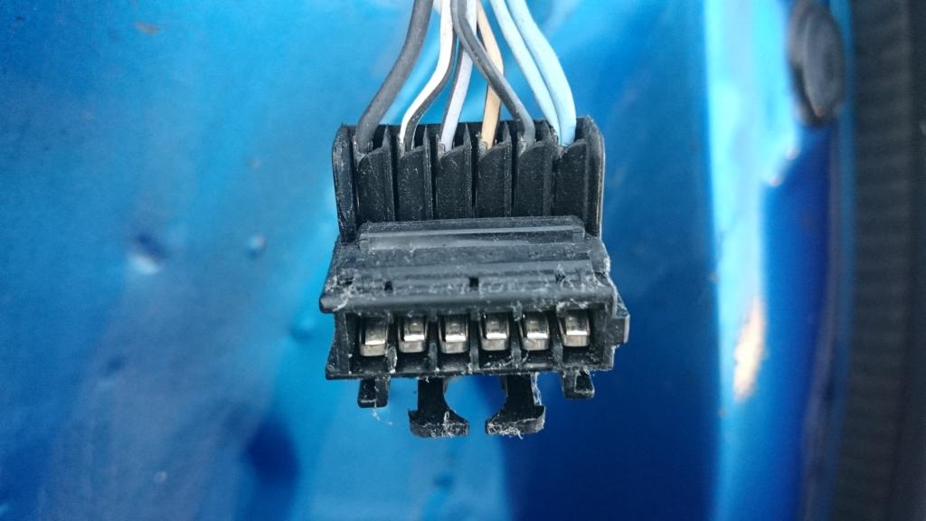

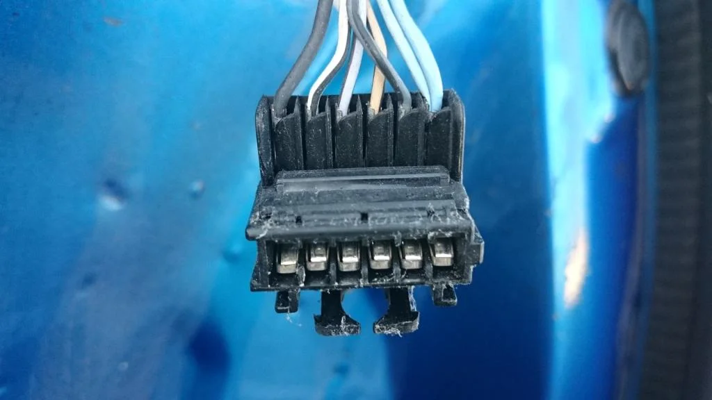

got a photo of exact pins, detailed info is very welcome
  clio v6
Yes see the black plug, get a thin screwdriver and close the the prongs tighter together then this should sort it out.
