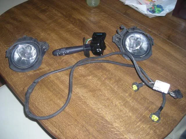

No thanks mate, just checked the clio and its already got the fog light option on the stalk, of course it does, all cars have rear fog lights.
Dont happen to still have the loom and lights do you? :approve:
  R5 GTT EFI Clio.
I thought the foglights switch, which i have, was for both front and back, same as when you turn the lights on, it does front and back. it wouldnt be a seperate stalk just for the front?.... ill take a pic of what ive got now ... gimme a sec :)
  R5 GTT EFI Clio.
Oh right, fair enough, how much you want for it? ... will it just plug straight into my connection? ... how do you fit them, ect?
  R5 GTT EFI Clio.
Went to the scrap yard today with my father so he could fetch some bits he needed for the trike we built, so i decided to tag along as i knew there was a new ish 182 in there, So 1st thing i do is get in there and find it, Blue 04 model, front ended which was a shame as i could have had the loom for the lights, but the dash was fully intact, 1st thing i set about doing was getting the stalk out, which was easy as i could see someone else had already removed the steering wheel surround. Bearing in mind these things aint cheap new, i took it to him, bearing in mind i knew him, also got the fag lighter out of there (not that i smoke) but this one was unused, so replaced mine with that, remembered the fuse blew for my cd player/fag lighter port (same fuze) so i took all the fuzes out of the clio, took it to him, he said just take it, Got home, was fitted and peiced back together within the hour (Lunch inbetween), Heres 2 pics when i was half way through thinking it wasent all gonna go back LOL..
