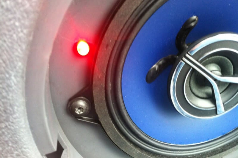

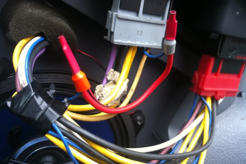

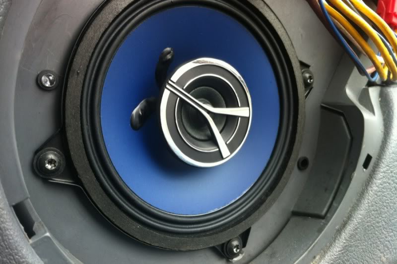

I'd personally wire them to my dipped beams switch on the steering wheel on the stalk like I have done with my speaker lights (yes I put red LEDs behind my speaker grill ) looks funny like my speakers are on fire

got a feeling that i am to,going to have to have a go at putting leds in my speaker grills and under dash lighting :)

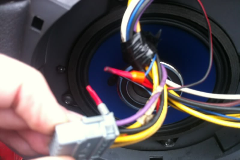

How the are fitted (I would advise 2 more they aren't all that bright enough to illuminate the whole footwell) I have lost one inside the door card too which I hadn't noticed lol... Super glue next time ;)
Wired into the Sidelights on my Window Switch... When the switch lights up so does the LED's
Another Shot
With side lights on...
