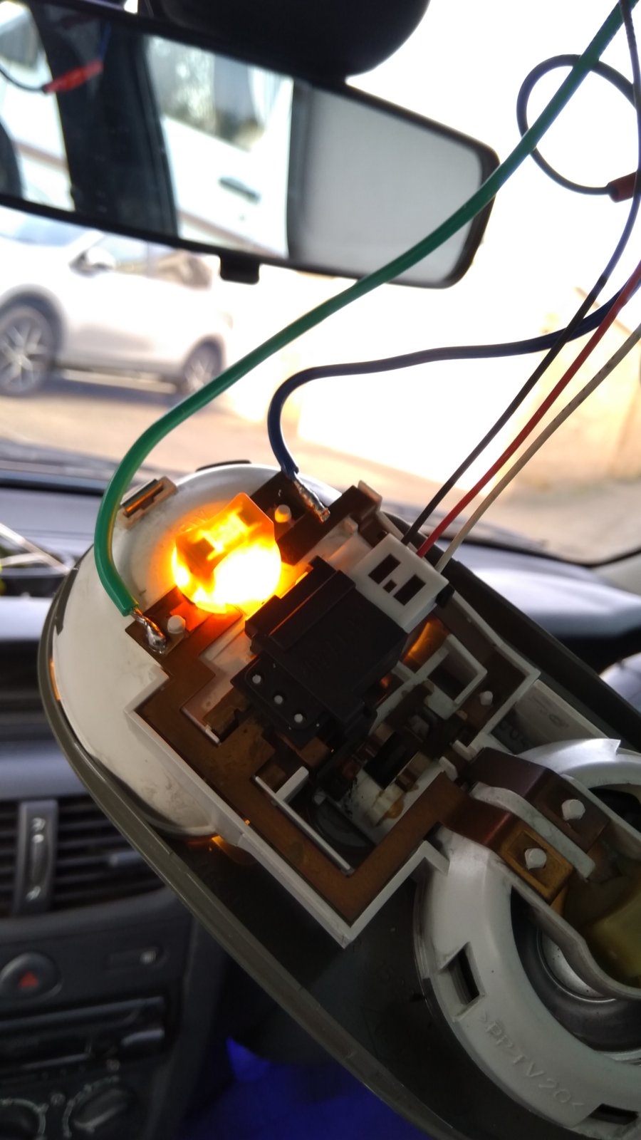

I have recently added footwell Lighting to my Clio and thought I would show where I wired it up from.
I have soldered the two wires either side of the bulb. I've also added spade connectors to the wires so that I can still remove the light fitting from the car.
