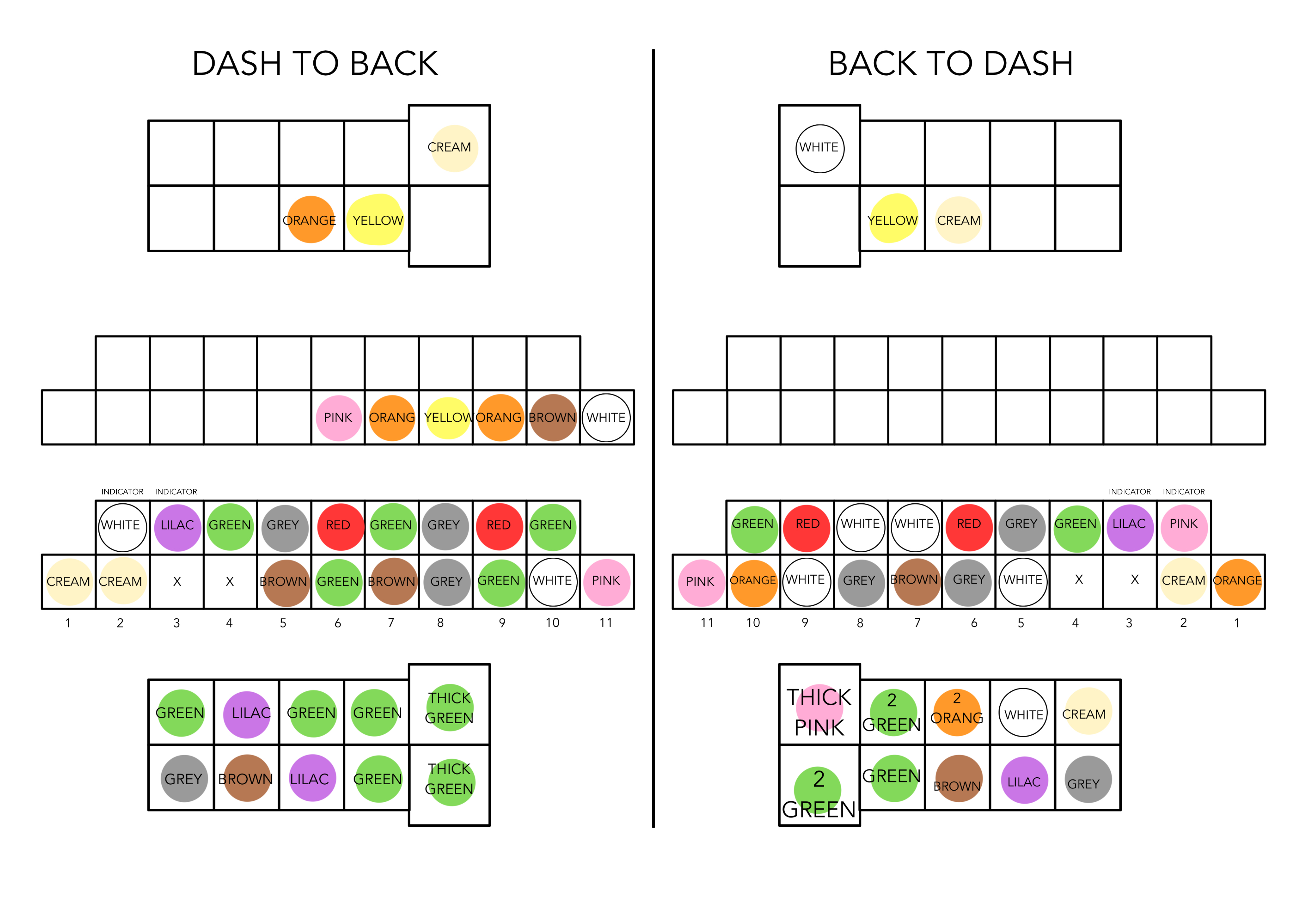

So the dreaded r2 connector in the passenger footwell was submerged and all the wires, apart from maybe 1 or 2 fell out of the R2 connector.
I managed a few. can anyone identify the function of these wires? any help appreciated.
clio mk3 2007 - 5 door.
