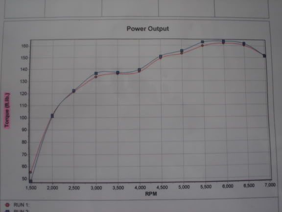

For all that didnt believe 202bhp

I thought people where more on about your claimed 180bhp at the wheels?
202bhp at fly would translate to (with at least 17% - 20% transmission losses) to 168bhp at wheel with only 17% loss...your 180bhp is a bit OTT

Agreed, but I was just going by what the blokes told me!
Oh and please dont forget the .3 on the end of 202, all makes a difference, haha!

Unless the engine was taken out and bench tested the power at the wheels is the only one you can say is accurate.

What mods m8? Thats the kind of reading youd expect from cams headwork etc
Chris
Oops just seen it on the printout...seems v high for those mods imo...so does the peak power of 7k...but hey its there in b+W (and colour lol) Have to get it on the strip to see

Correct me if Im wrong but isnt that graph a little too linear!?!? Looks like someones got a ruler and made it up...

Do you really think i would go through all that effort just to post a pic?!?
Chill little Jonny.. Not pointing the finger at you but for all you know that rolling road could have printed a ski slope and told you it represented your car.

No one is questing you have a RR prinout showing 202hp. There a famous tunning company who can supply 210hp RR printouts to show the effects of there tunning.
Ive got a 190hp printout for a 150hp red top Corsa all it had was a IK and exhuast. Ive also seen 190hp RR printouts from stock 172s.
All we are trying to say in the real world we cannot see you realy having that much power. RR arnt that accurate a Australian magazine did tests all day with a 350Z on a RR and got figures which varied by over 10% all though the day.

True i suppose as i have no idea what it could look like
But its when people say ive drawn it on, i mean come on, use your noddle!
Fair point it could be wrong, but all i know is it goes like stink and can keep up with my mates 285hp 200sx from the lights up to about 130!

As Martin says, you should be running 13s up qtr mile with that sorta power and a 286bhp 200sx will certainly run 13s. Only way is to get it to Pod, spend 25 quid and see. I reckon youll see 14.5 best if you strip it out.
Fair play.
At least the lad has put up the facts to back up his claim. Whether the R/R is accurate or not he can only go the evidence hes been presented with.

No-one is doubting his word but when you have seen a fair few printouts you will realise that this one looks like a 5 year old has been left alone with a ruler.
Not being funny, but what rulers do you use?! i swear that line curves slightly?!

Its true, ive never seen an f4r powered car produce a graph like that except roamers.
They suffer (well a few mine included) a power loss between 4-5k/rpm (cant really remember exactly but i have my 189bhp graph from PE somewhere i will try and dig it out.

peak power is very, very high up the rev range for a F4R on standard inlet surely!!
i thought the F4Rs had a trough at around 4k???.....
run it at the pod matey...should embarass some quick cars.

Go and look up the word "Linear"...

ive just figured out 202 @ fly is 160 at wheels using a 20% tranny loss
180 @ wheels = 225 @ fly
John, you do a sub 14.5 1/4mile, ill buy you a pint
