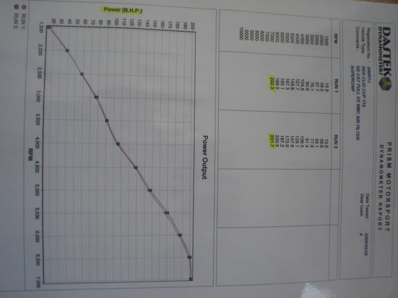

For all that didnt believe 202bhp
Christopher
  Z4M

Quote: Originally posted by Fred2001Dynamic on 04 July 2005
ive just figured out 202 @ fly is 160 at wheels using a 20% tranny loss
180 @ wheels = 225 @ fly
John, you do a sub 14.5 1/4mile, ill buy you a pint
You said you had no comment!! ;)
Although if that car makes 202 bhp and 165 odd ft/lb Ill bear my arse in Woolworths window. On a Saturday.:D
Not doubting its quick, but the figures seem ridiculous for those mods from what Ive seen from other cars on here.

This does happen sometimes Fred.
My last run at GDI i was told i had 140bhp@the wheels which was 182bhp@the fly. Perhaps some rollers are just slightly out :eek:

Can you just explain.... without being agressive...
If quite a number of people have had the same work as him done...(chip, full de cat, exhaust) and all got 189 / 192 bhp @ fly, how can he have 225?
People with 215 @ fly have had all the above work, plus cams, inlets etc?
We are talking the SAME cars. 172 CUP, so how can it be possible?
Please just explain for me....
Mine is full decat, powerflow exhaust, and induction (all same as jons, except my induction is different)
So i am probably running about 180 / 184 max i think???, if i superchip mine i jump to 225?

Some of you have very odd opinions on RR. You simply cant take 20% and say it works. A RR ONLY measures power at the wheels accurately. They dont simply use a mathmatical equation to gross it up to the fly. If youve ever actually noticed when they hit the redline they dont just take off the throttle they take it down slowly. This way the machine tries to work out the tranny loss. This is still a very un-acurate way of measuring.
I find it odd that the graph has no wheel power lines or figures. Why does it have Dastek printed on it when you have a superchip?
Is it a normal plug and play superchip?
Also - to suggest it could match a 285 bhp SX turbo from 0-130 is proposturous (sp) And I dont care WTF you say. Id stick £50 on it now that my 276bhp MR2 would be so far away at 130mph itd be out of site.

I still wouldnt take a RR printout as gospel. They are a tool for fettling engines and ironing out problems IMO, and cannot accurately reflect conditions on the road. Some reputed companies also have their own axe to grind.
Its a nice power curve though. Quite linear.

Not all RRs use coasdown losses to calculate total absorbsion figures. ANd in any case, i dont like the method because your fopwer figure varies considerably in all the different gears. Its a very poor system as some people come away telling you that you have 15bhp lost in the rolling losses.
  300bhp MR2 Turbo
I had 66bhp lost on my last time. 210bhp atw 276 atf.
210bhp atw is the only part of that Id take for gospel.
But 276hbp and 280lbs torque sounds better.

/\ Most printouts give you at least some indication of power at the wheels as thats what they measure.
  GDI ???BHP Cliosport172
Yes i agree.
But it doesnt help matters when you go to two different rolling roads & come away with two completely different readings, which is what happened to me.

bmc cda, decat, powerflow exhaust and superchip, those are his mods, and he was told that his rolling road was 180 bhp @ wheels
