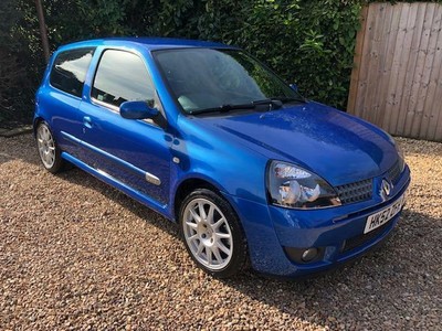

Forged Engine on eBay?
I think its worth a look. It could be a good buy at £4,200 ish.
Don't know much about forged engines. Anything else I should be on the look out for?
I'll be going through the service history with a fine toothed comb, that's for sure:)
Although from the advert there is no evidence of belts having been done recently.
