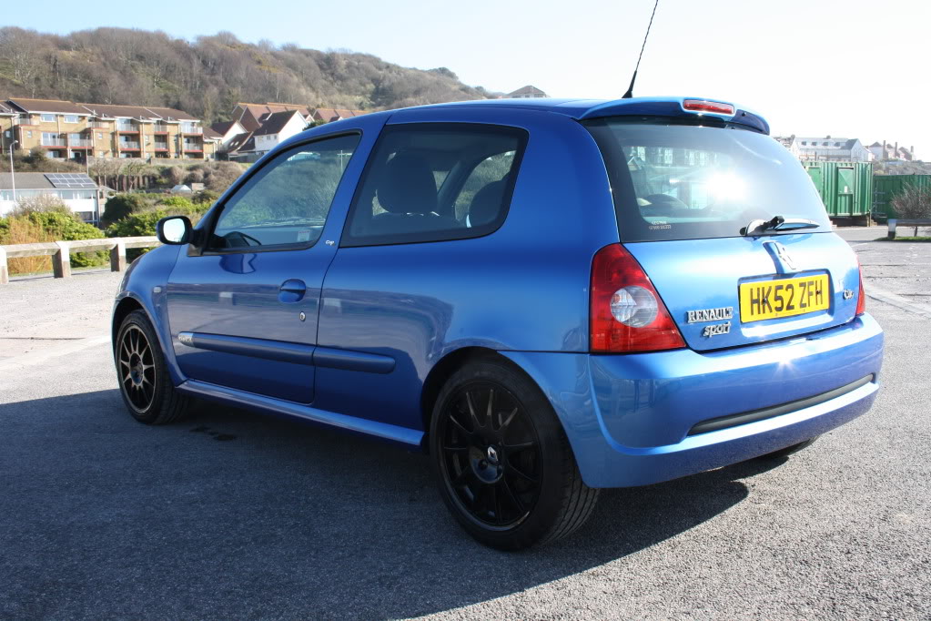

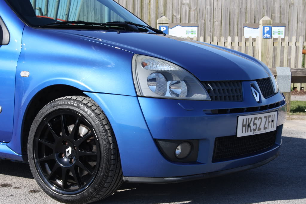

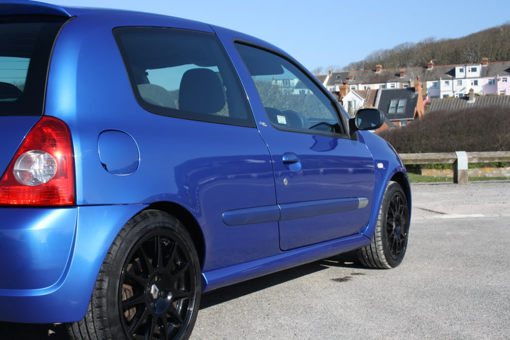

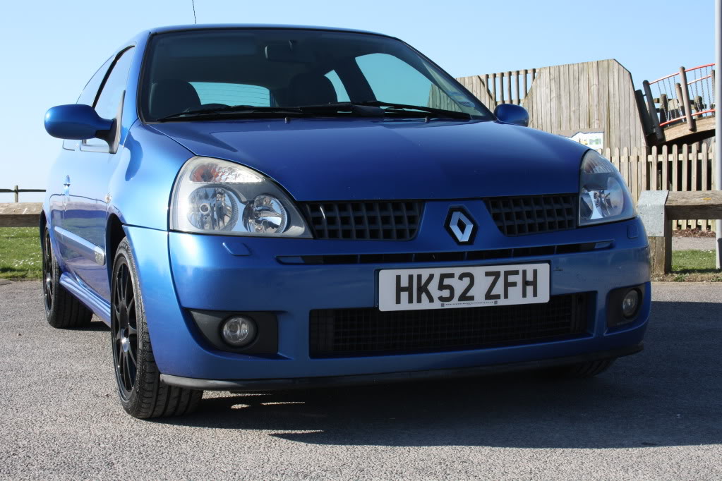

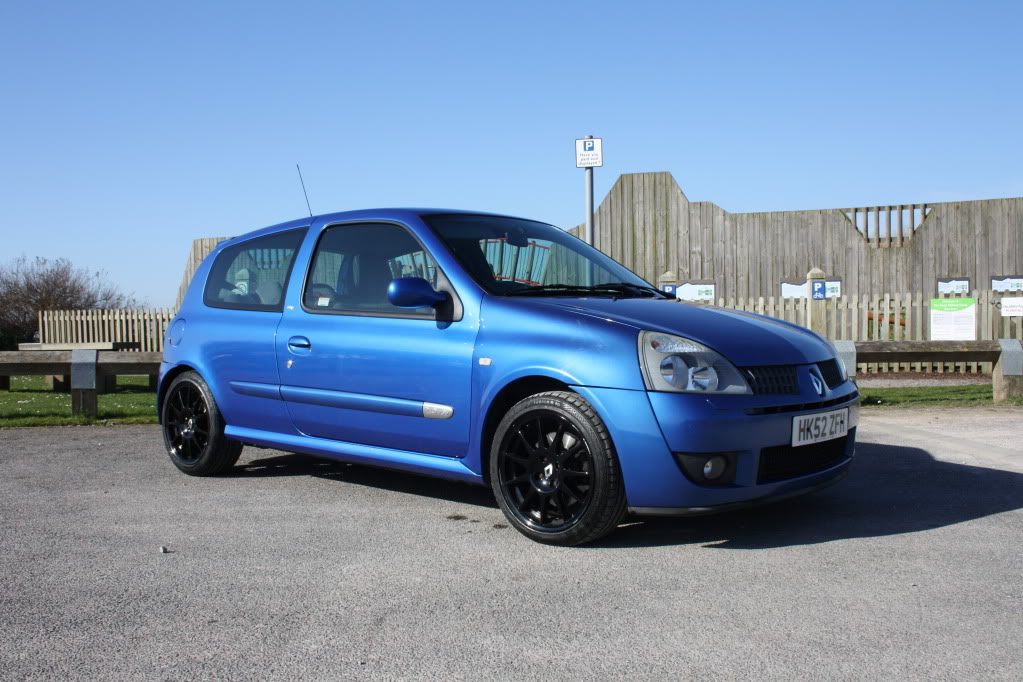

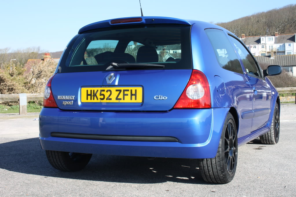

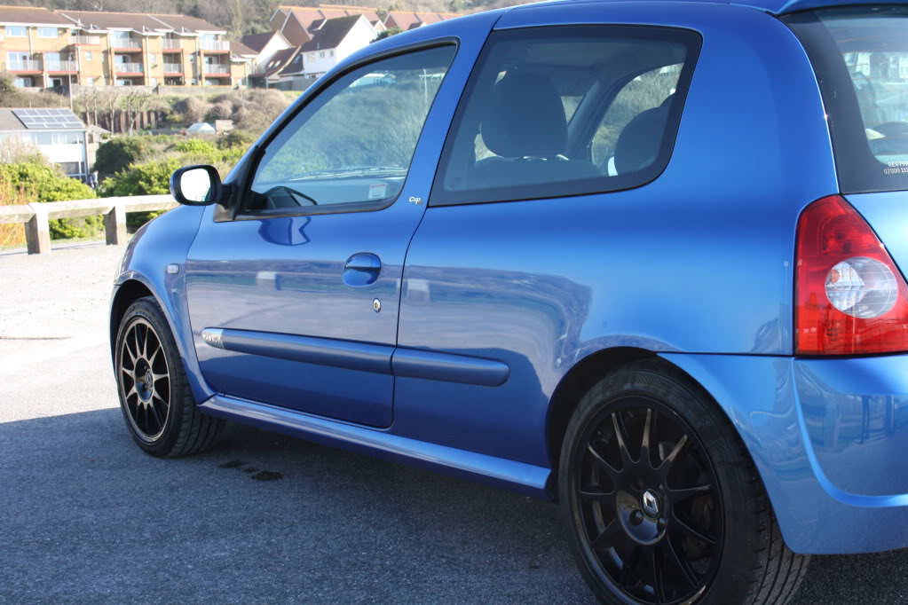

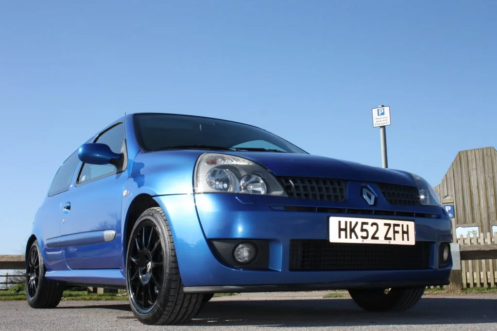

Ok Gents pics of my new 172 cup – couple of things to note - I HATE the black turinis and need them redoing in either standard silver or anthracite as soon as funds allow, the bumper wants painting and it wants a detail (the below is after a £6 polish wash!)
As it goes it the best spec Clio sport I’ve owned and this is now No8 Clio. Nothing for the money is as fun and provides great Power:MPG
Below is the spec, I am now wondering what should be my next avenue regarding power.

The Obvious idea would be to go ITB’s – but realistically what sort of power should I see with the High compression? Does the high compression really add that much?
I’ve sat and read lots of threads about running just cams and then cams/ITB’s and ‘how can I make 200bhp’ but none with a high compression build. I believe what I have is a very good base to go down the ITB route.
