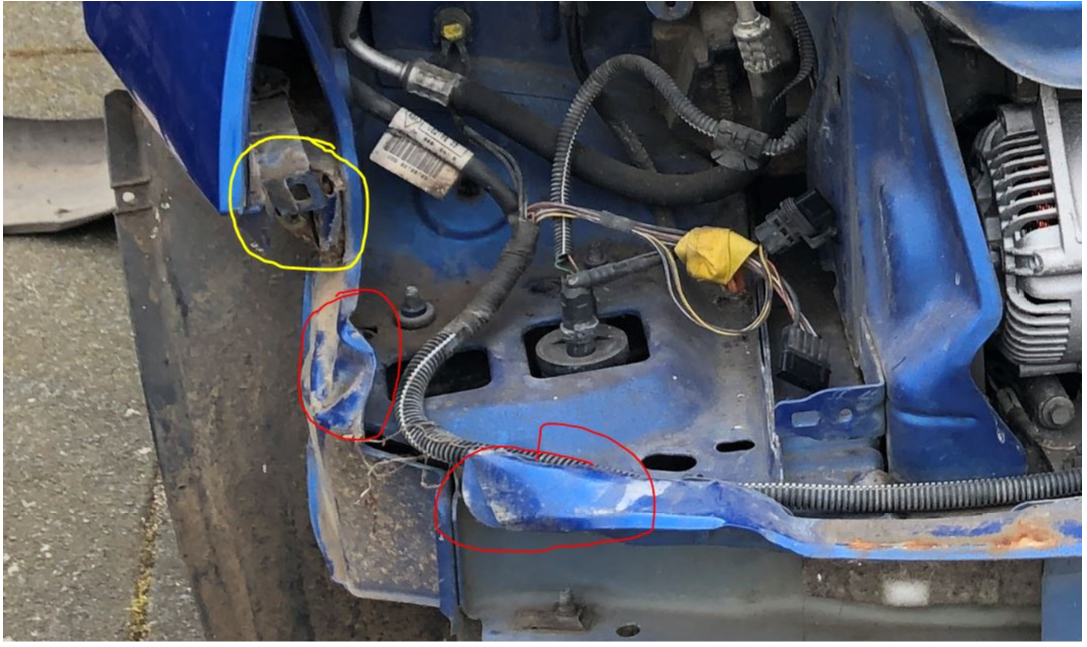

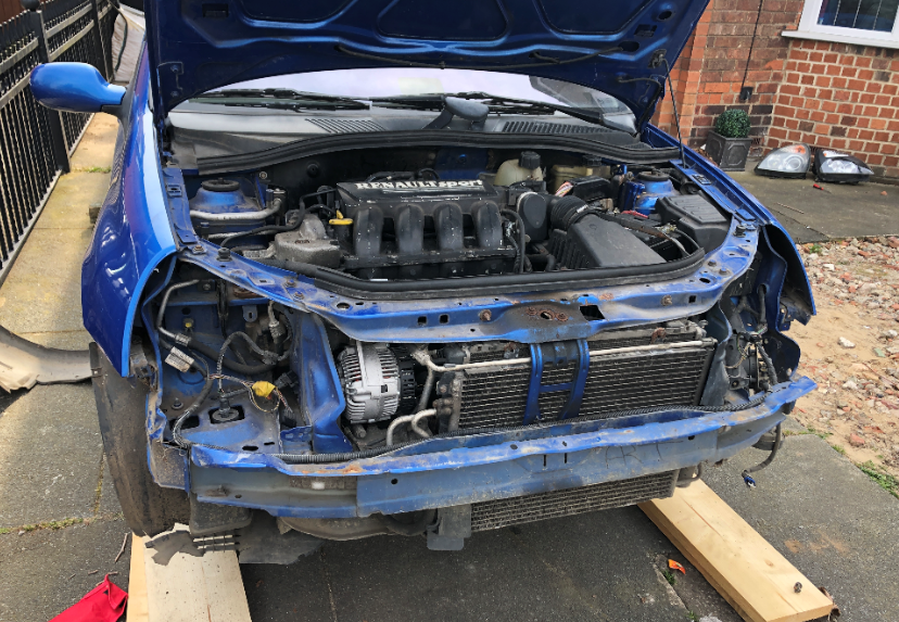

Ok, so I've managed to get a little more time and started to strip back the front end of the Clio so see why the wing doesn't fit properly. I had a feeling but wasn't sure when i bought it but had HPI checked it before. Anyway its got some bent bits.
It looks to me like its had a light bump front right, followed by a chimp with a hammer trying to bodge fix it. So the circled red bits i think got bent in the dink and then the bit circled in yellow (still with the headlight bolt attached) has been hammered back nearly flat cos the bolt is rusted. Any ideas on how I could sort this out? Guess its going to be somewhere between professional repair and lump hammer.
Think they let the chimp lose with the trolley jack as well as they've also bent the front jacking points which i also need to sort..
Thanks in advance.

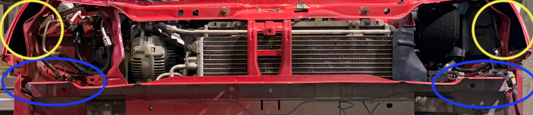

Yellow circles show how it should be along with the Blue circles.
Looks like yours has had a hit on the O/S/F
