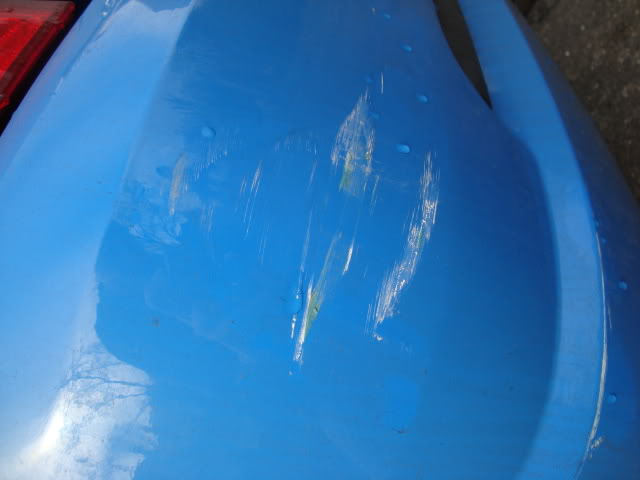

Found this upon returning to my car the other day. Removing mark off my rear bumper.
Came back to this on the back of my bumper the other day:
Just wondering if anyone knows what the best way to try and remove it is?
As far as I can tell its not actually scratched into the paint, but rather paint off whatever went into it sitting on top of my paint?
Excuse the dirt :p

I'd give it a good going over with some Scratch X, if it's not cut into the plastic it should clean up a treat...

Autoglym Super Resin Polish. Will be off in no time. Scratch X would be a bit too harsh imho as they would probably come off with a cloth, warm water and elbow grease (don't do this though as it will more than likely scratch the paint work)

Sweet. That's what I thought. I'll wack out my SRP. Cheers.

Try using some t~cut ive used it for a few marks on my car just like that. Took them right off.

i very much doubt srp will sort that out. try the scratch-x looks like it will only improve it though i dont think you will 100% remove that

Well Its not actually gone through the paint as far as I can tell. Its white paint sitting on top of my paint.
Obviously will probably not be perfect, but should remove the white I'd have thought.

If its not gone through the laquer its reparable with polish mate. yeah the white will go and it will look much better than that.

Try SRP first. It's always best to start with the least abrasive product possible.

I always thought srp had no abrasive properties and was mostly filler. but yeah try a less abrasive product first although judging by looking at that it wants a decent cut and then finish it off with a low cut

SRP has some minor polishing compounds in it, I got out a mark very similar with SRP.

Farecla G3 liquid compound on a microfibre cloth, bit of elbow grease. Bit of SRP or similiar over the top if you actually care about swirls.

I used SRP in the end. Came off easily, apart from a few marks where its actually damaged my paint.
