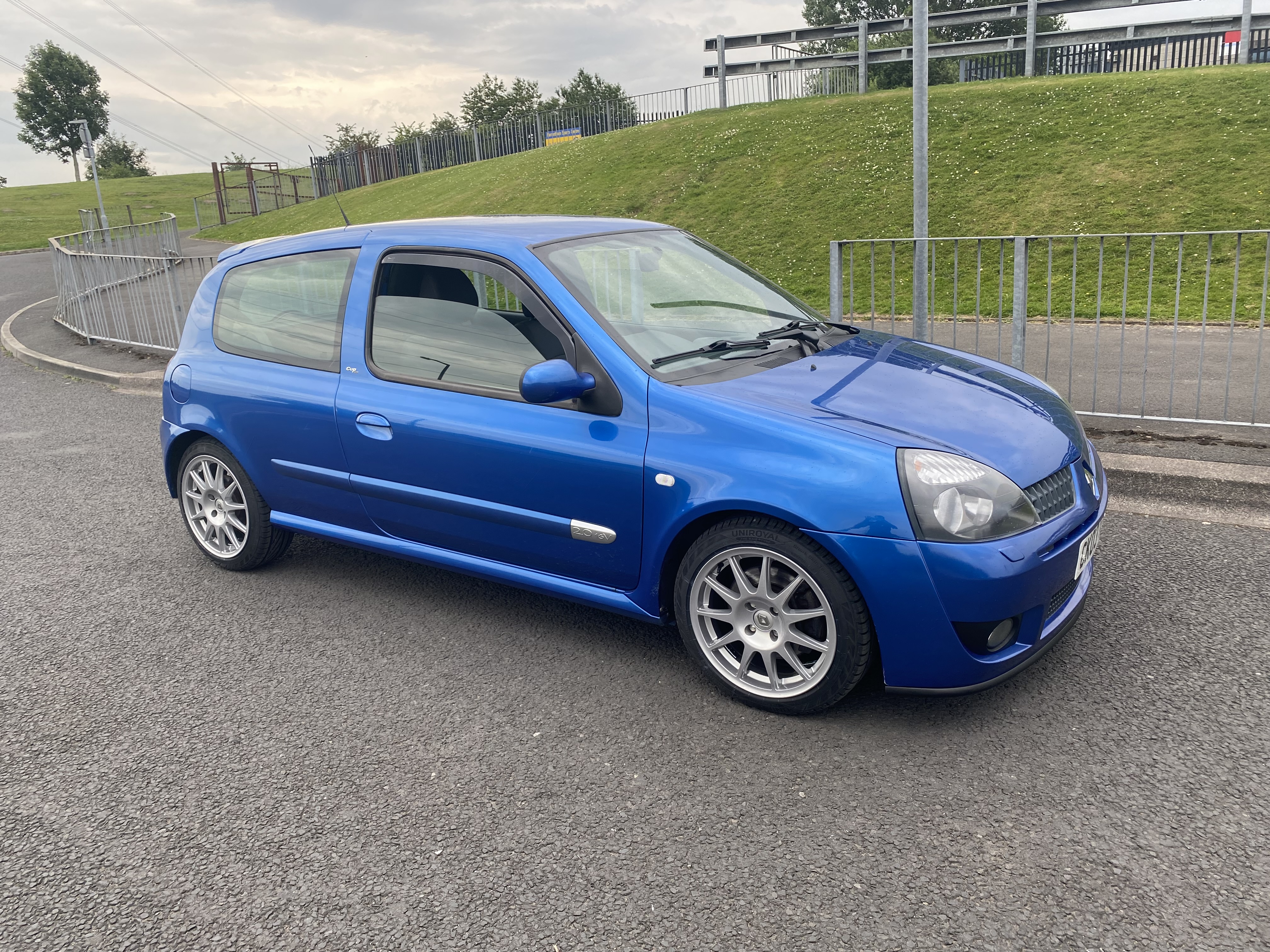

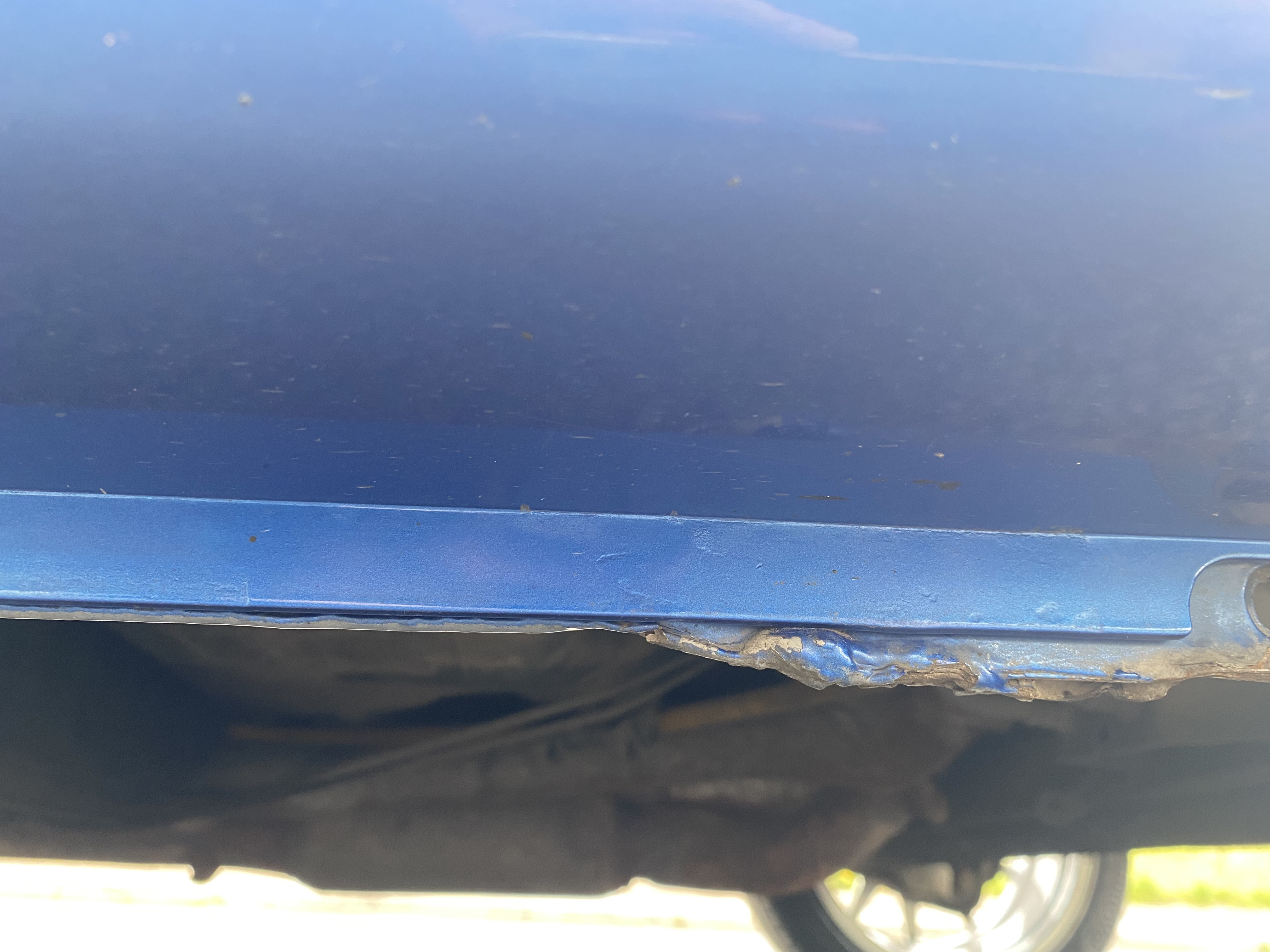

You can see the road rash. Still need to protect the rear jacking points.

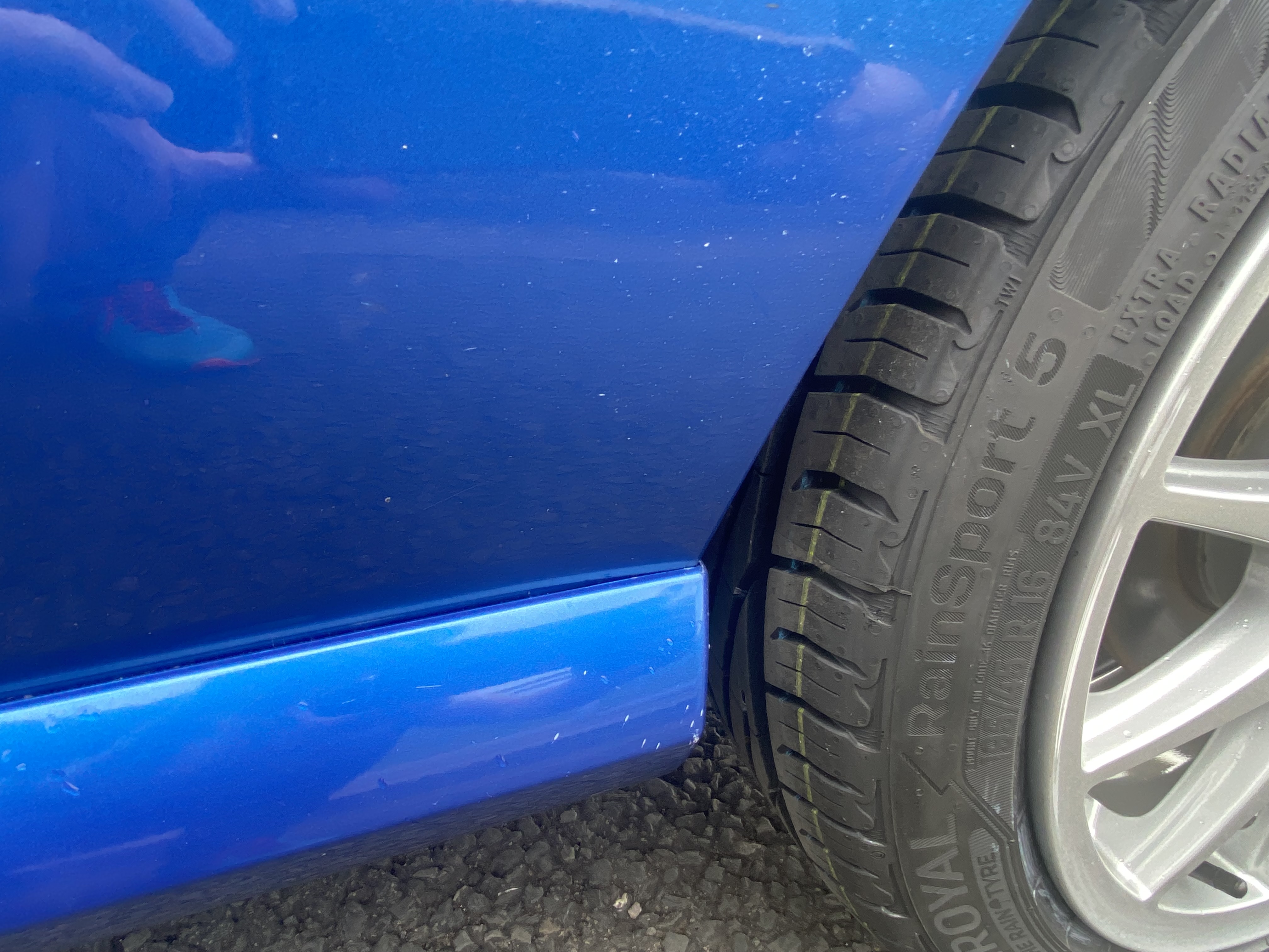

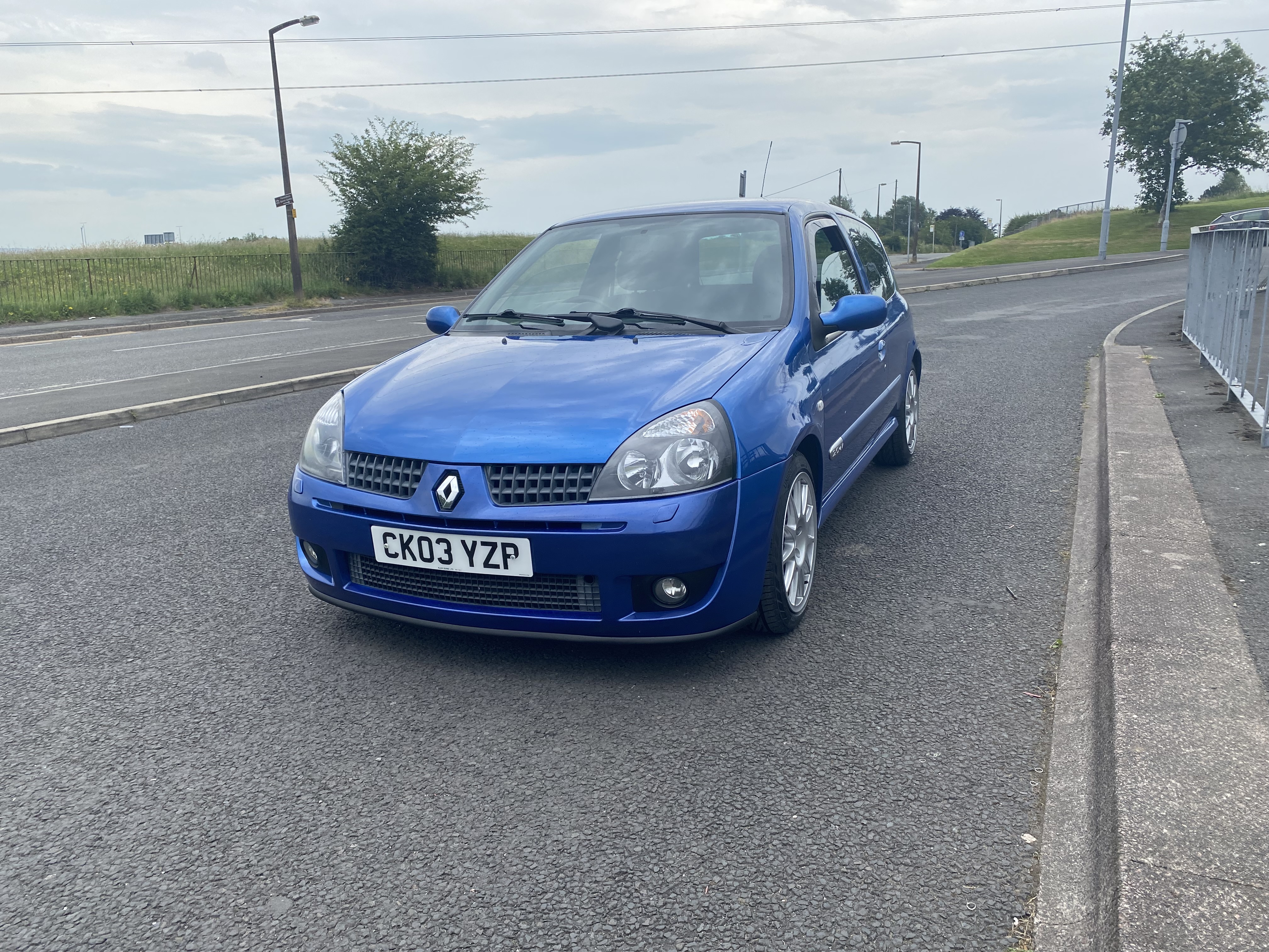

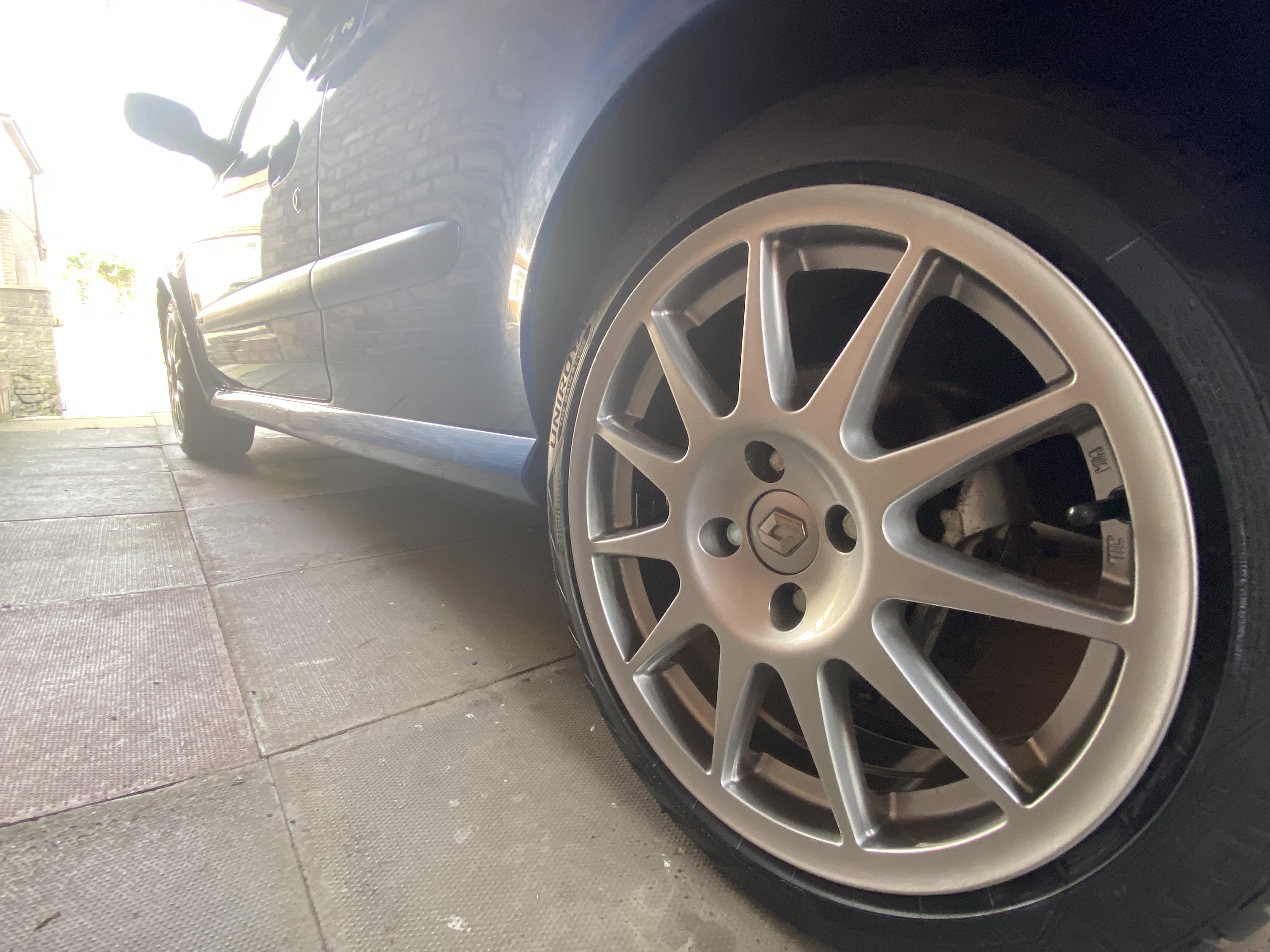

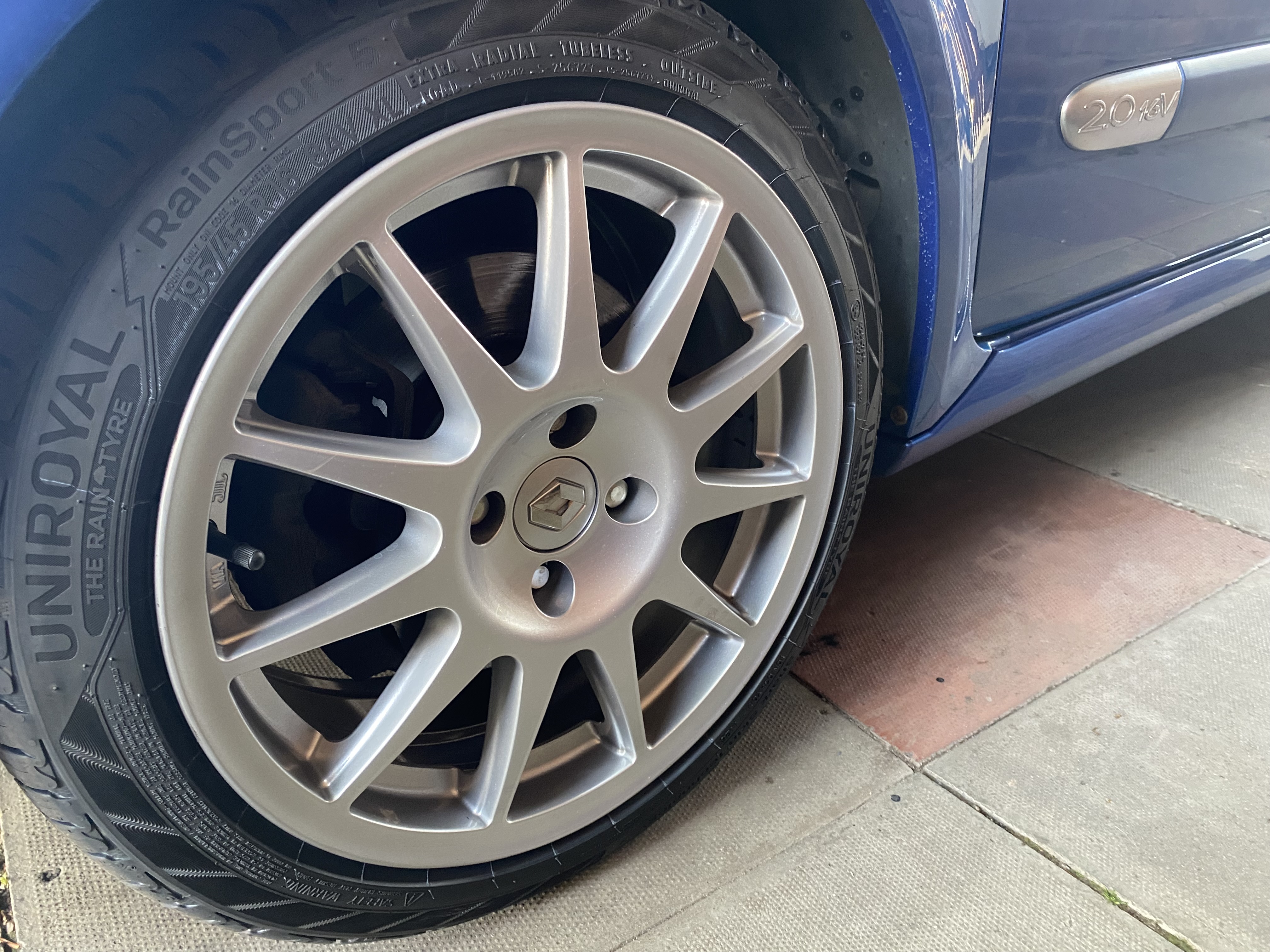

New tyres fitted. I was going to do this last autumn but there was a lot of tread left on them. However, with tyres being THE most important thing on a car it was long overdue. They look much better, too.View attachment 1748506View attachment 1748507
Nice! I had the Uniroyals on my 172 for about a year and a half and recently switched to PS5s. I noticed a bit of a "floating" sensation on b roads at speed with the Uniroyals, perhaps due to softer sidewalls. It definitely went away after switching to PS5s. Mine were 205/45/R16 load index 83 though. Good value for money for sure.

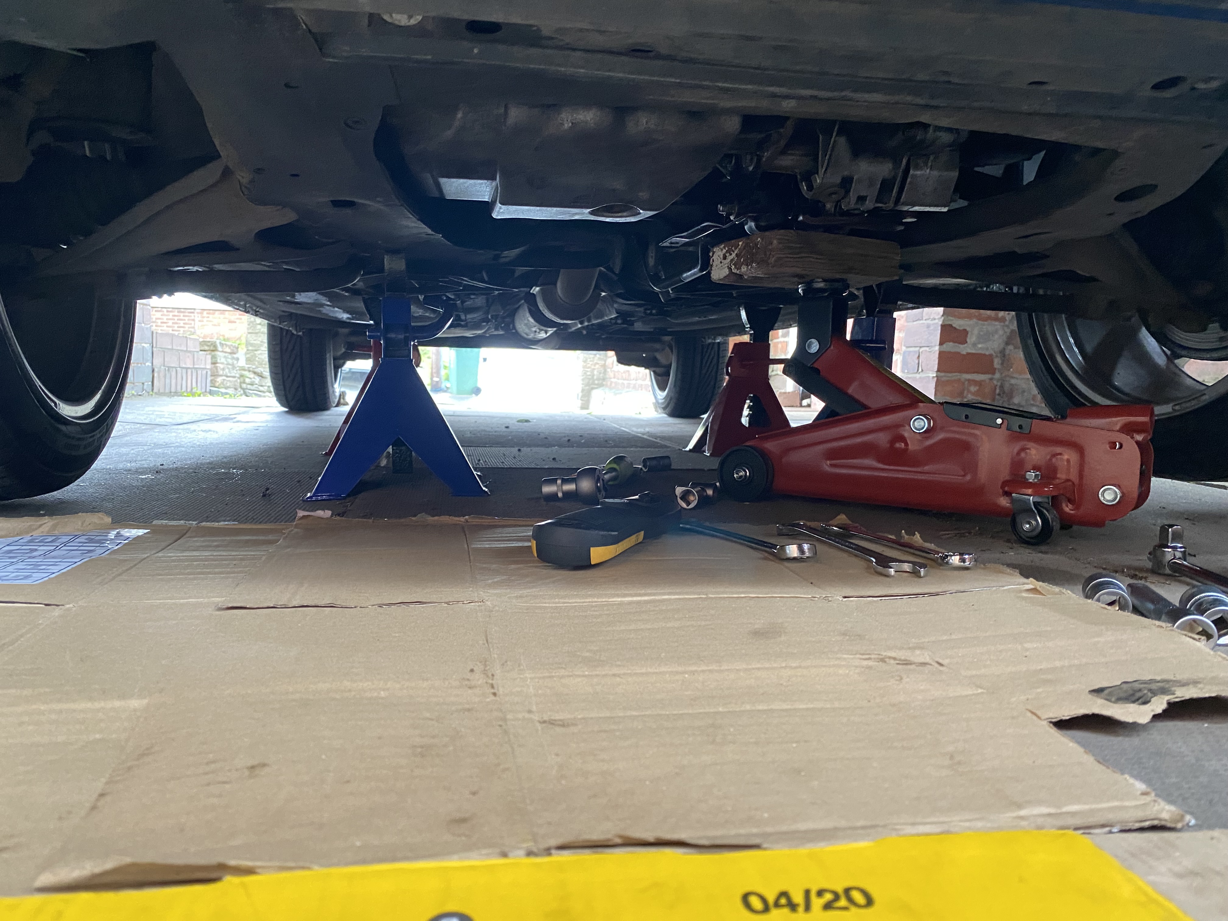

Another Saturday free so a chance to do a bit more....

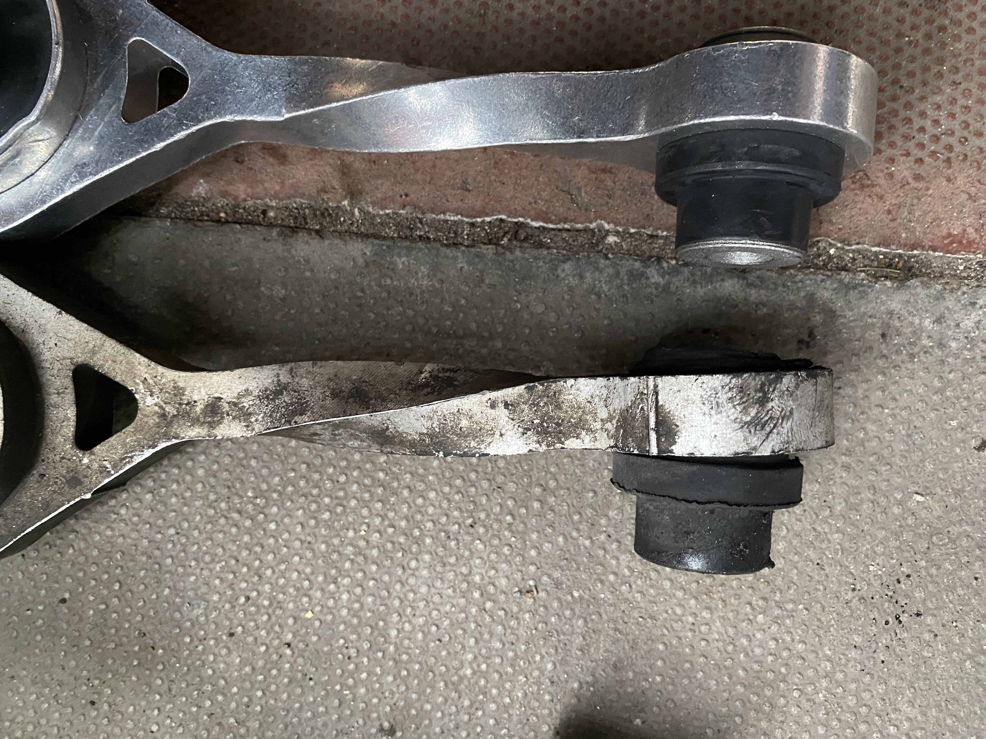

I have the choice of sanding and polishing the headlights again to a better finish, removing the front bumper to align the n/s headlight correctly with the bonnet or try and replace my dog bone which I think is shagged. The dog bone should be the first job but I'm not sure how easy it will be even if the car is jacked at the front onto axle stands. I'm not sure I can get it high enough to work under it and I don't have a long bar to crack the nuts, only a standard socket set. It was off a few months ago if if torqued up I may not be able to shift it.
Decisions, decisions....
Thanks guys. I’ll see how I feel in the morning as to what jobs I do. The car is at Birchdown in about 3 weeks so if I don’t do the DB they can.

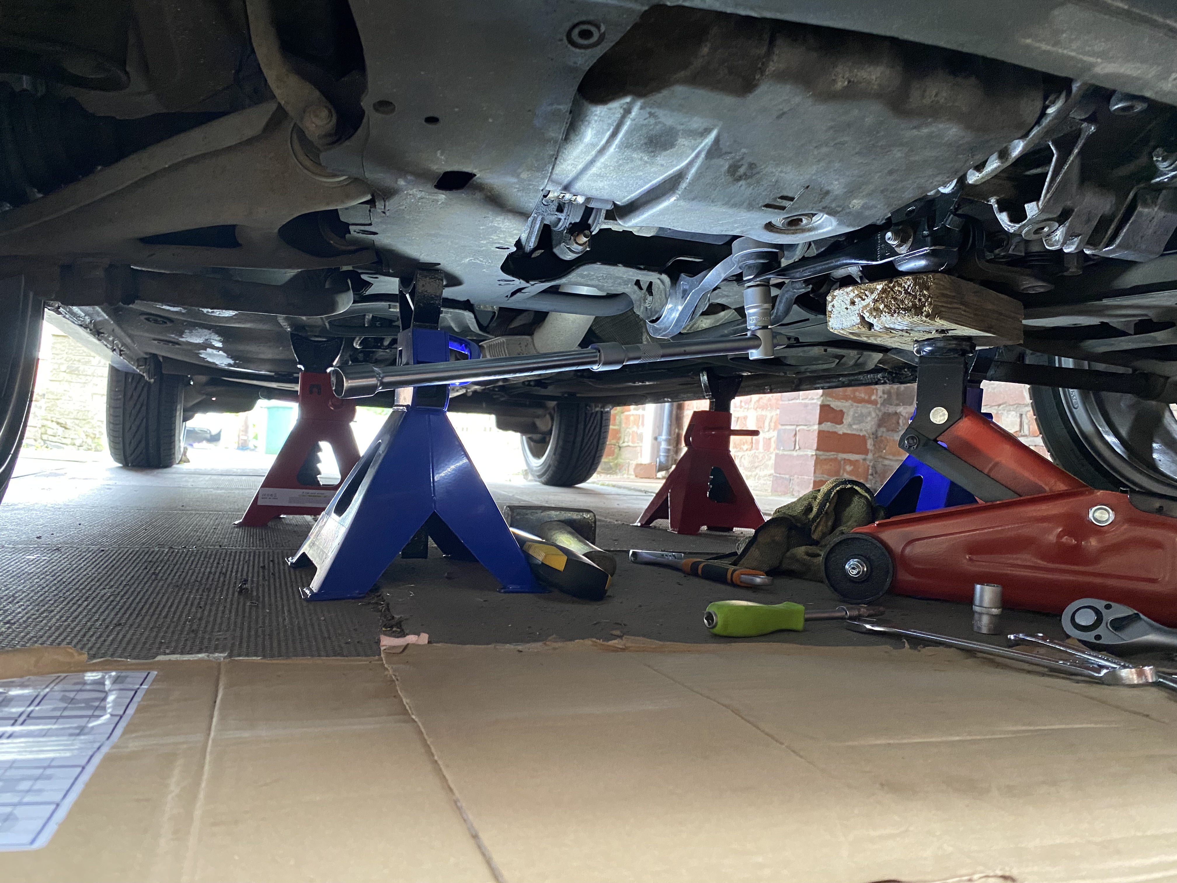

All done. Gear change is a lot better at slow speeds and the clunking noise when coming to a stop and leaving dipping the clutch to the last second has gone. I can still hear a slight clunk when going on and off throttle is 4th and 5th at around 30mph but the car still needs the upper gearbox mount and top engine mount replacing. A huge improvement though.
I cleaned the threads up on the two bolts and used a makeshift breaker bar. I had the gearbox/engine weight supported with the trolley jack and had the leverage the dog bone towards the rear a little to allow the larger bolt to screw in with ease. I’ll ask Birchdown to torque up the bolts but I have them as tight as I could get them.

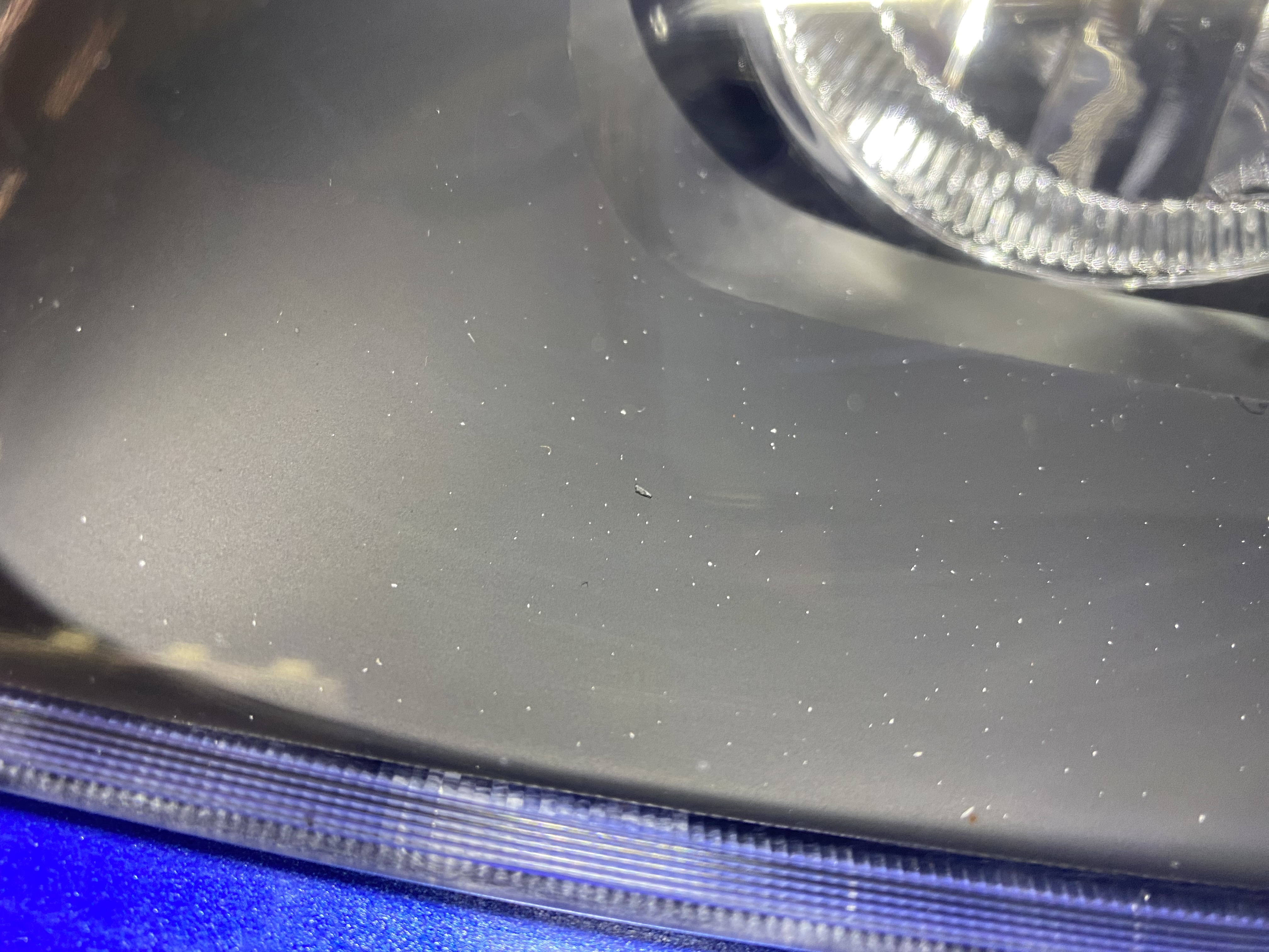

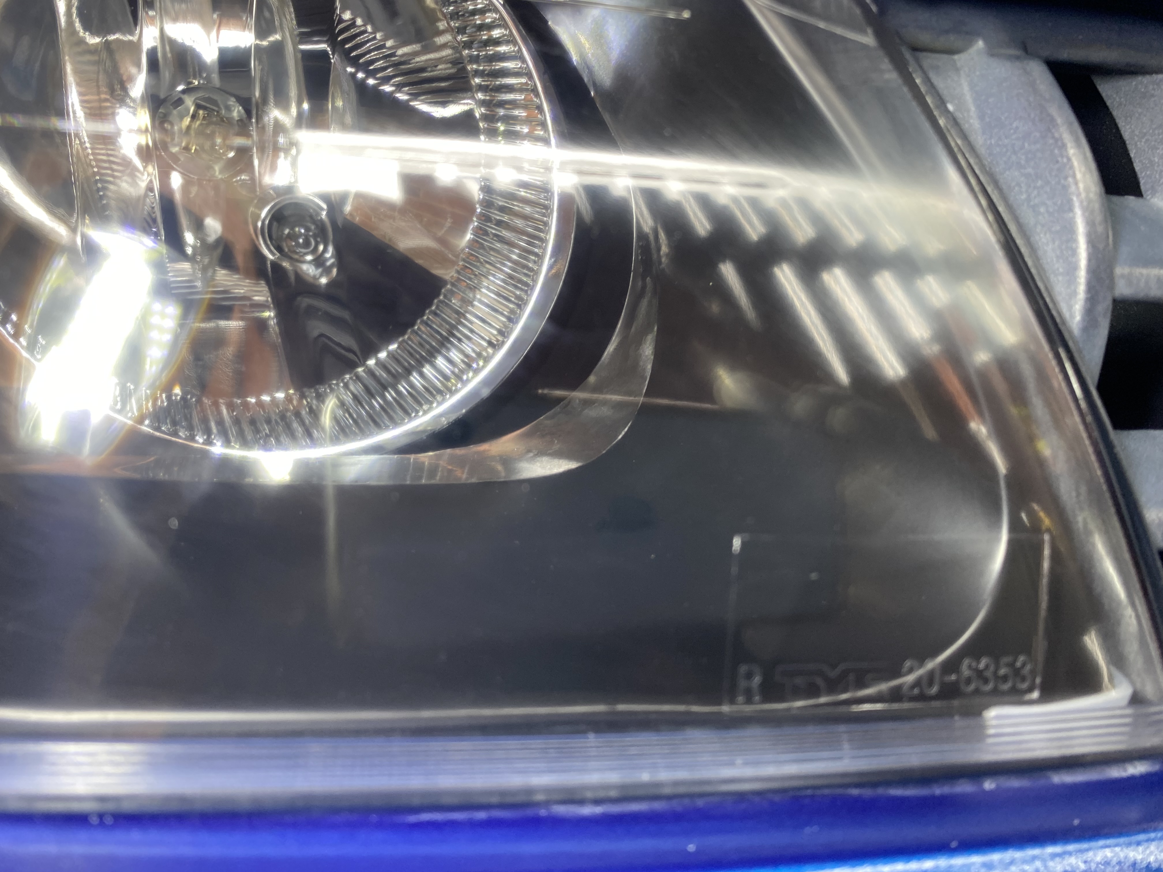

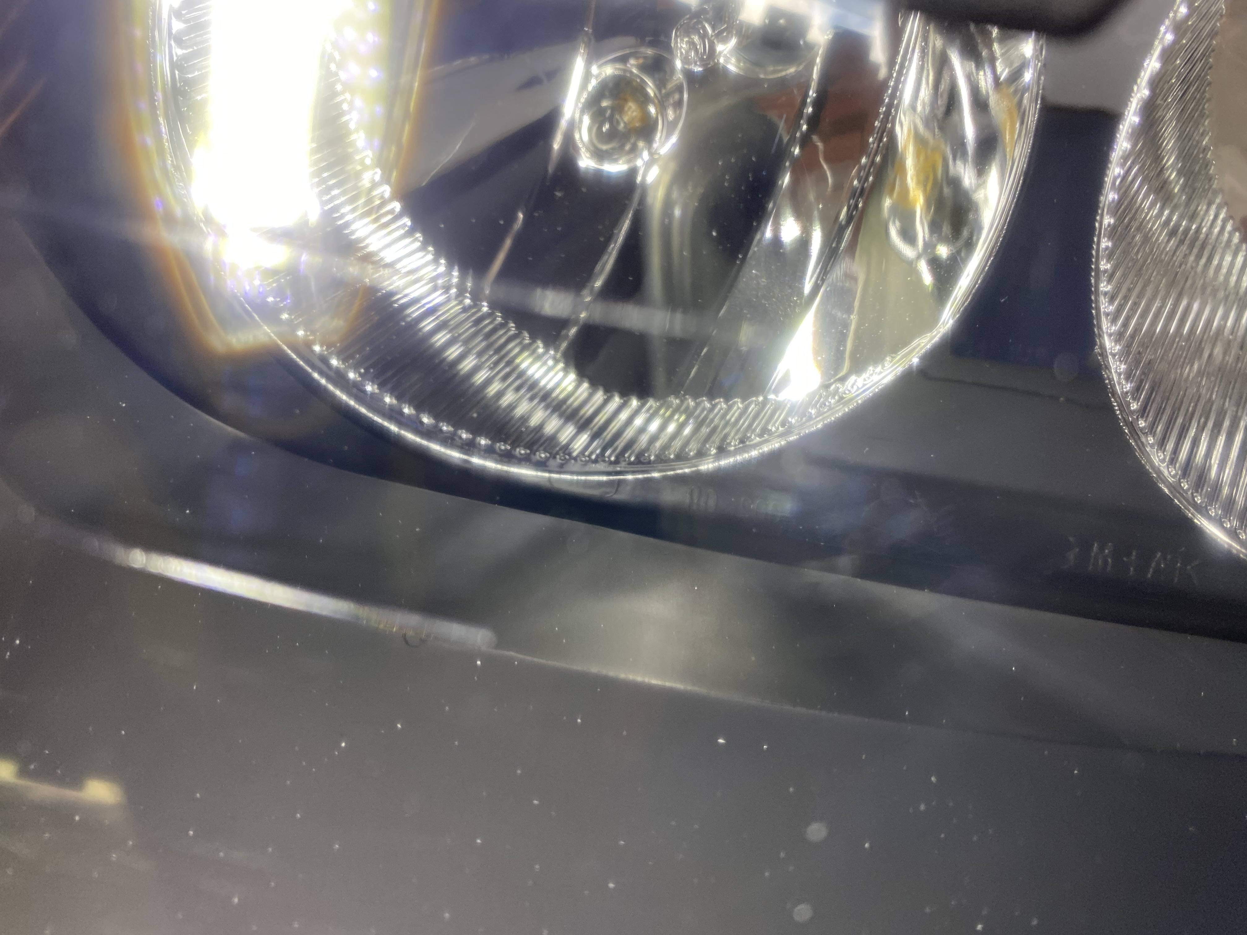

I’ve just given the headlights another rub down with 2000 grit sandpaper and then a polish with a medium cut polish and then a super finish swirl remover polish. They certainly pass the 2m test, but these are not new headlights and I think they would have to be totally refurbished to be perfect. There seems to be dust and debris inside and I think the inside of the lenses will also need to be cleaned. Apart from separating the lense from the body, I’ve no idea how that would be done. They are way better than they were originally when I got the car and also after I had my first attempt to polish them. I think these will do for the moment as the rest of the car paint work is what it is, 22 years old.
If you’ve got access to a compressor, you could always try blowing some of the crap out of them using an airline blower.
It won’t get it all out, but it should get some of it out.
It’s a good idea. I had thought about making a tiny flexible attachment to go onto the vacuum cleaner and putting through the holes where the bulbs go.

I also had them fit 2 new OEM spec engine mounts (top and upper gearbox) and they had already fitted a good lower gearbox mount last time it was in. I had fitted a new OEM spec dog bone a few weeks ago. but....oops! Schoolboy error from me as i'd fitted the new one as the old one had come off and it was upside down (don't laugh as the window that was blown out of that passenger jet that result in the pilot being half sucked out was caused by the engineer fitting new bolts that were the same as he took out of the window,,,the wrong ones!) Tit!

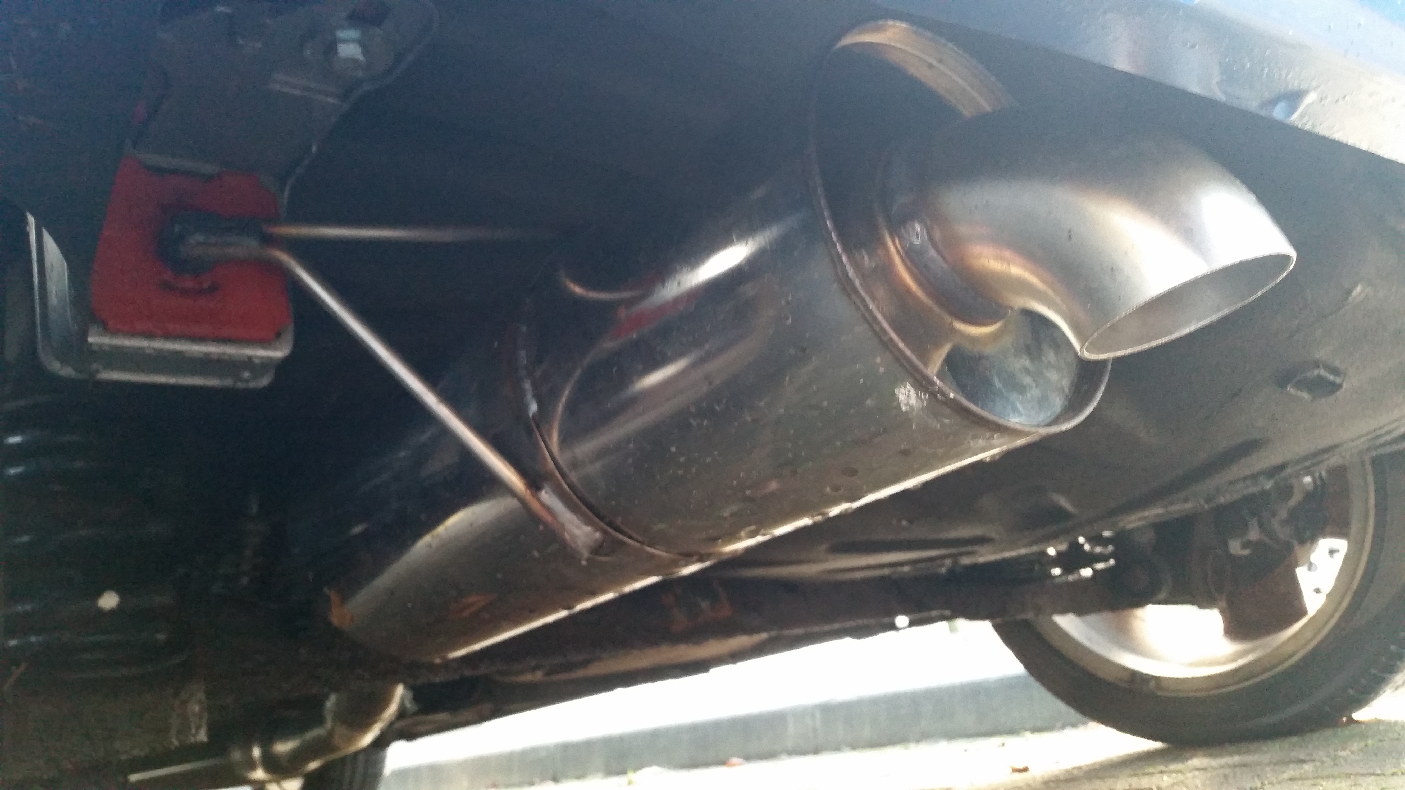

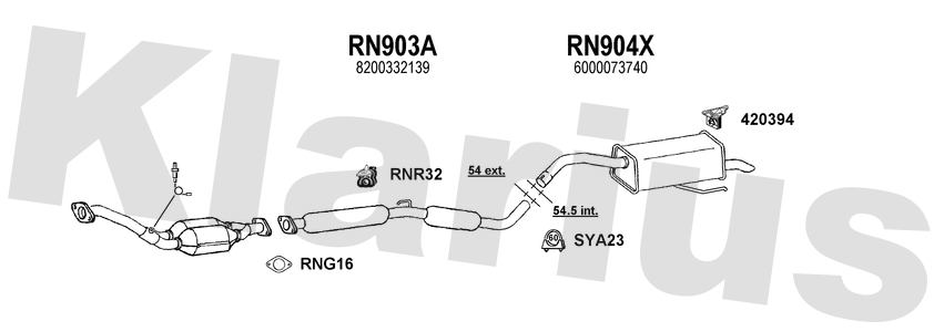

Yes, my exhaust. I do think it's goosed for all the reasons i've posted previously. I don't want to spend a fortune on a SS system that may end up being louder so I', going to replace like for like. It has a Klarius system on it at the moment so i'll get the same along with the gasket and clamp as per the image below. When the car was being tuned at EFI Chris said it seemed that a baffle had collapsed so renewing with the same is my best bet. If it sounds the same i'm ok with that and i'll look to a SS one in a few years time.

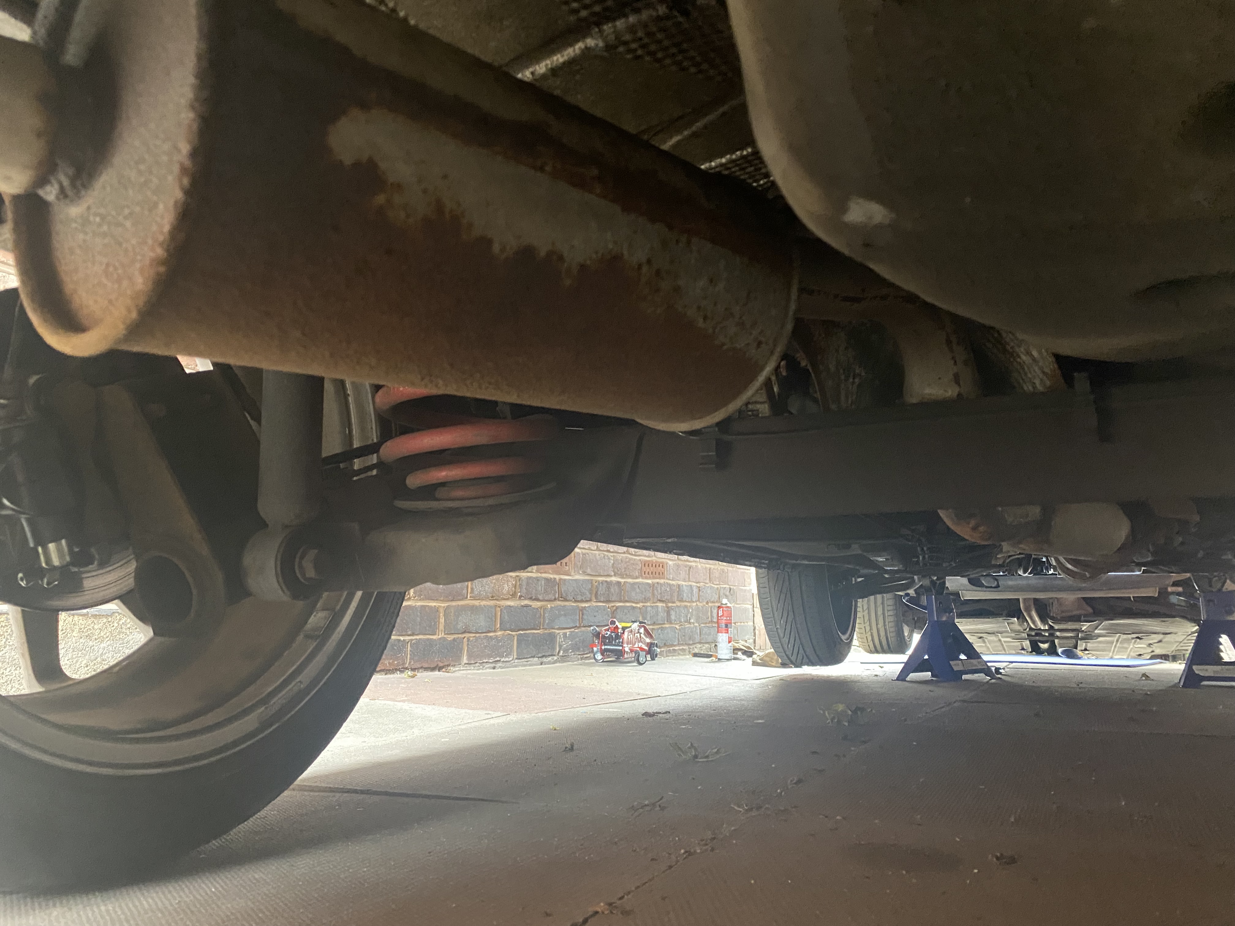

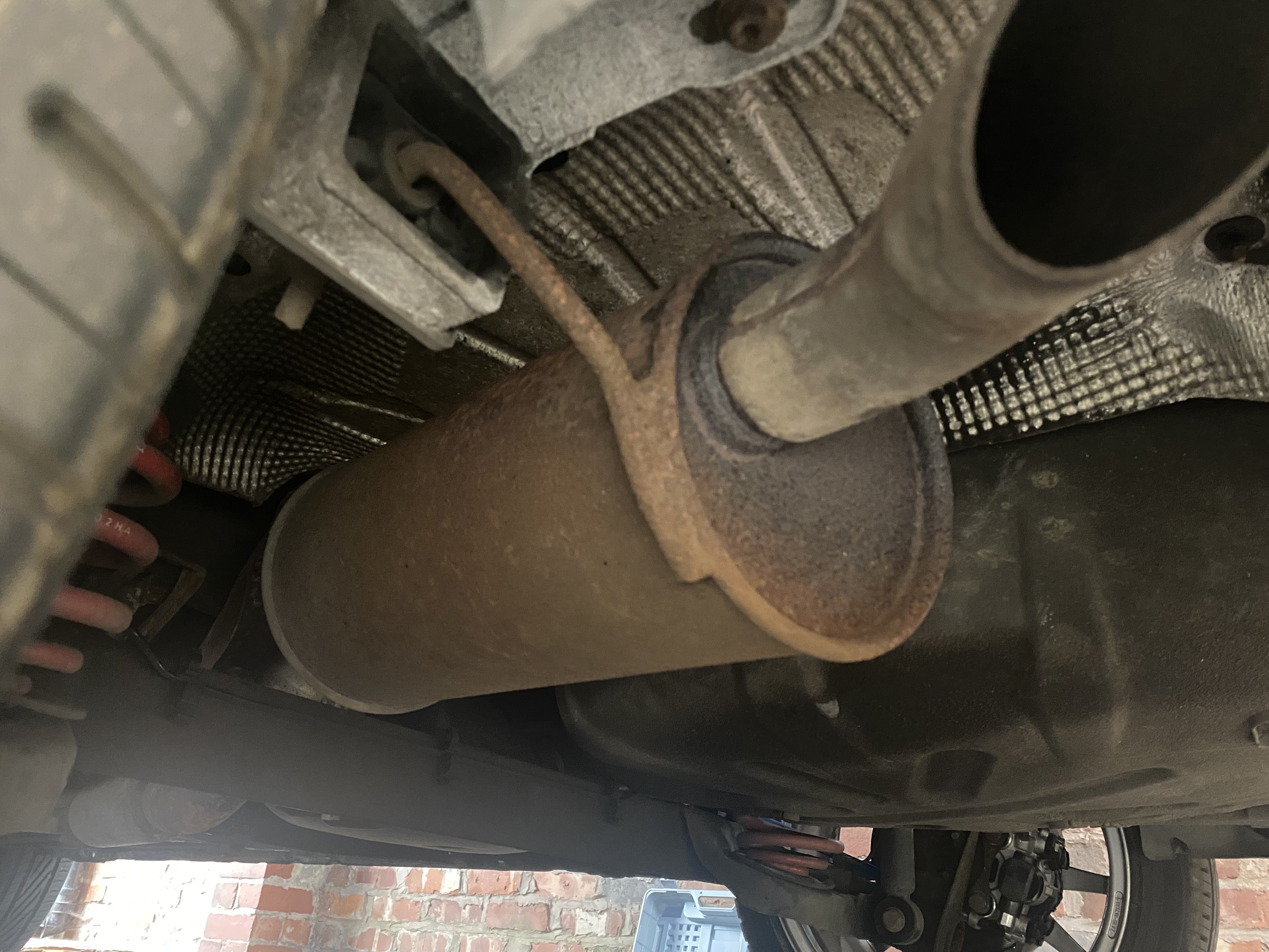

How are your exhaust hangers?
I had a clunk that ended up being the centre hanger. The rubber has a metal ring in it and mine wore through the rubber, so the metal ring was touching the metal hanger of the exhaust.
Back one is new but I’ve ordered a new centre one. The back one when I got the car was goosed so I fully expect the centre one to be as bad.
With the movement of the engine and the exhaust, it was just enough to clunk the metal hanger and the metal of the exhaust. Push the exhaust forward and back and you may hear it.

I did all that when I first got the Clio and the exhaust wasn’t knocking against anything but I noticed the hanger at the back was badly perished. That was changed and I’ve since checked the exhaust again for knocking and there is nothing from it whatsoever.

Regarding the exhaust, I’m pretty sure that that back box is not a Klarius one so when my new Klarius system goes on I’m hopeful that it won’t sound as loud as it does now. I also noticed that the rear exhaust hanger has already worn really badly and it’s only about 12 months old. Birchdown will fit the exhaust for me as I’m just worried that’s a bolt will shear
off and then I will be stuck.

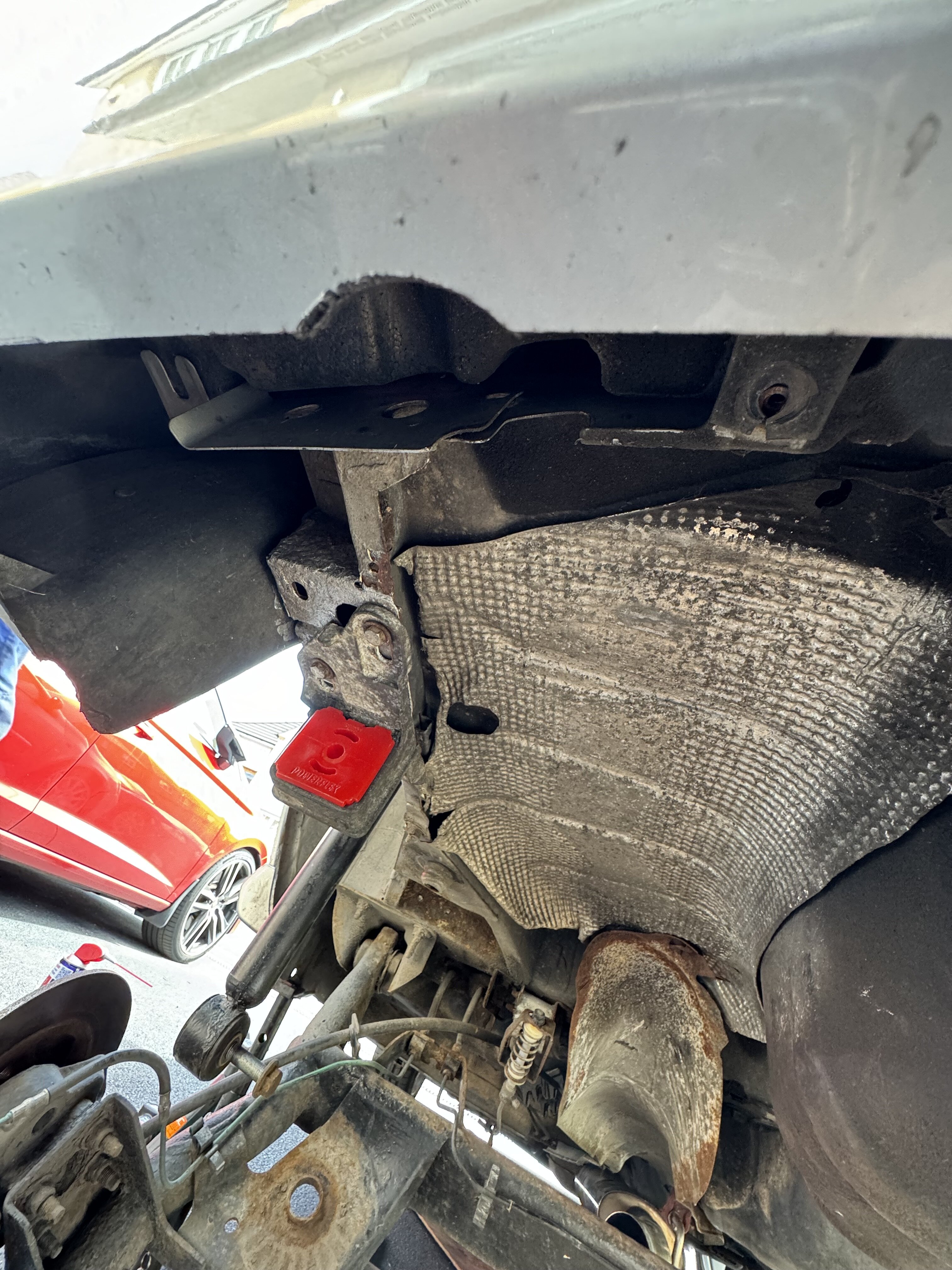

I've been through 3 x OEM exhaust hangers - all failed quickly.
Bite the bullet and get the powerflex red insert - no knocking noise and i've not had any issues, it's been fitted for several years.
I’ve got one of these too. Well worth the money.

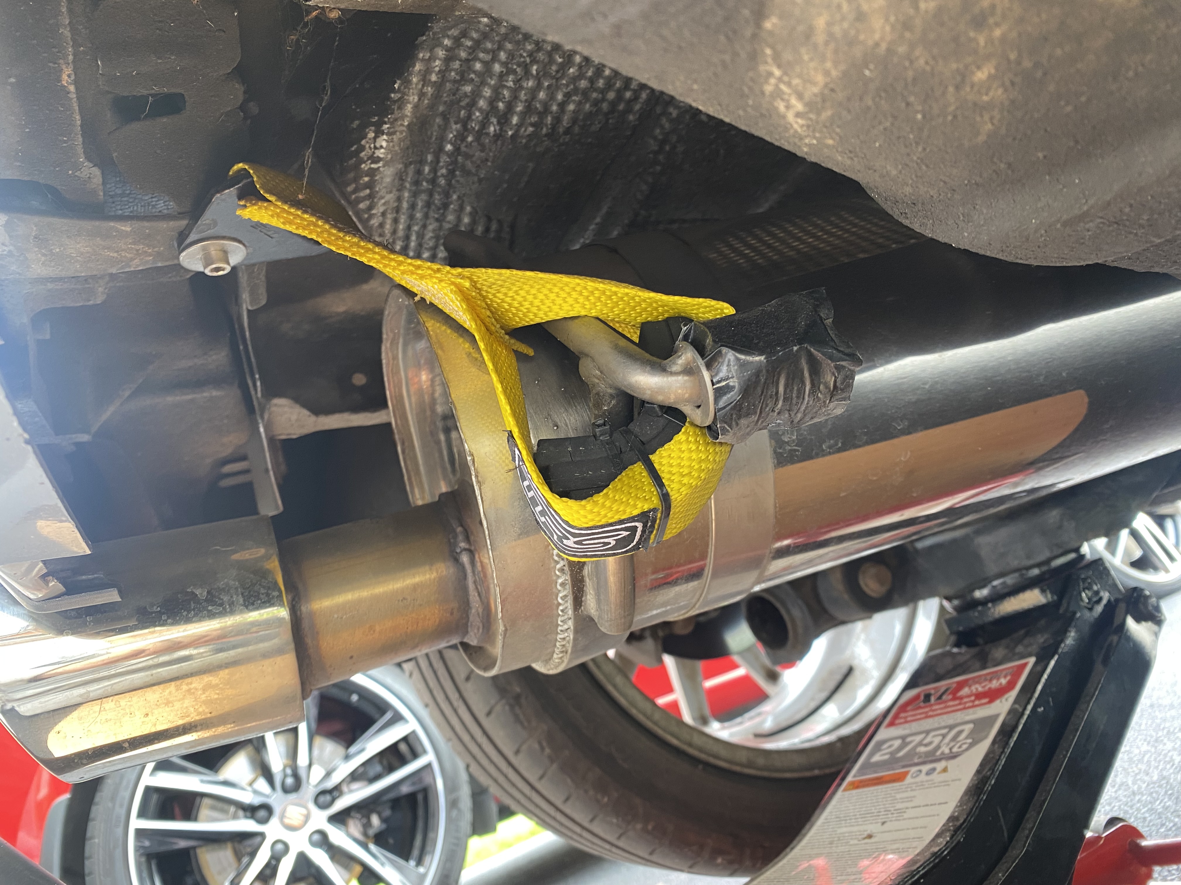

Better than the TRS tow strap bodge it had one before 😂
