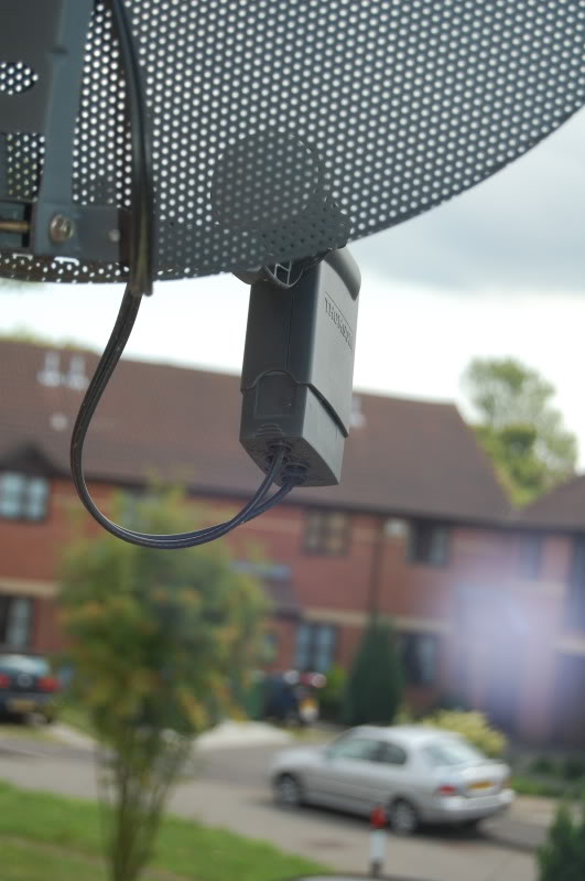

Just taken a photo of my dish, it seems there's a spare place to put the cable perhaps?

Yeah, you've got a quad-LNB there.
