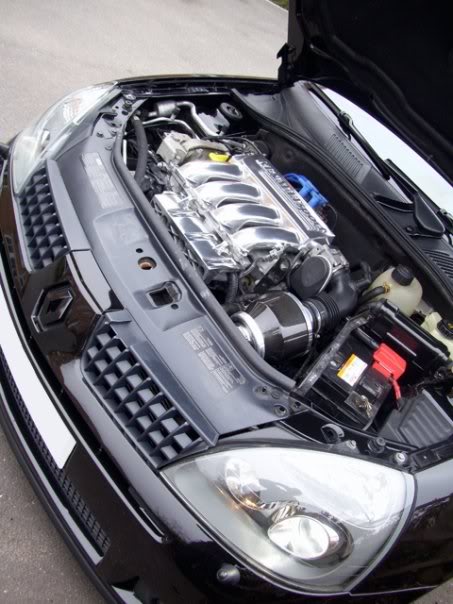

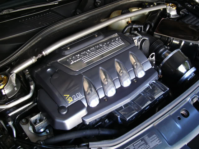

The engine bay...
Well once the manifold was polished i just made sure tht every other time i clean the car i went over the polished metal with matal polish and the engine cover with some of wat ever car polish im using at the time usually a bit of Meguiars gold class. i also use some trim spray on the hosing n make sure its all spic n span n hover any o the dust out of the bay that might creep in there... i think i may suffer from a lil O.C.D lol
if u wana know bout the mods in there n more details bout the metal polishing PICS etc then let me no :)

Actually yeah, could you talk me through how you got your engine cover the way it is... I mean it lookks like you've sprayed it but it also has the decal/lettering (whatever you call it) still on there?

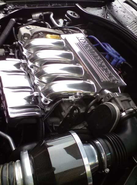

This car is stunning, i really need to find somebody that can help me polish my inlets in gagging to do it!!!
Impact metal finishing in Nottingham m8... ask for a fella called Dez n mention the forum. He will sort u out.
0115 9879302
U will just need to drive down there take it all apart in the car park n give it him for a hr or 2. You could also just take it off at home n post it to him or have some one run u down with it.
He charges about £40-50 depending on how much u have done.
I paid sumut like £50 for the manifold n fuel rail then went bk n paid £20 for my battery cover n throttle body.

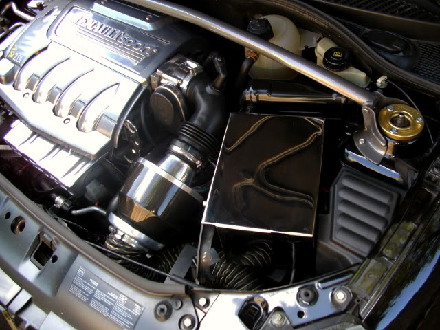

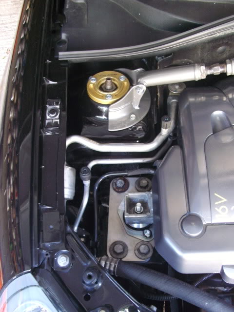

Few stage pics for ya.
Viper added
+ Leads and plugs
inlet polished and RS tuning re map
+ battery cover and polished throttle body
+ engine cover - top mounts,group n engine mounts and strut brace ;)

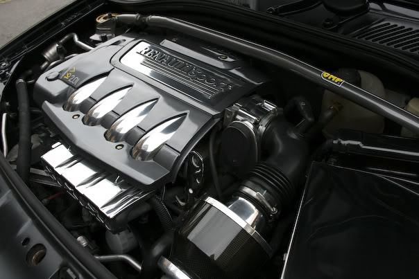

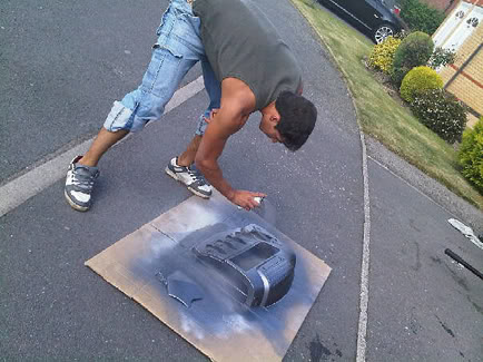

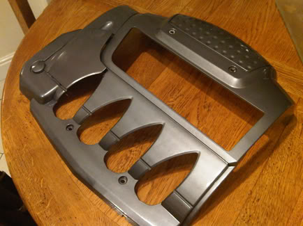

No worrys... Its quite simple m8.
First take sum pics of your original cover so you no where the decals sit.
Then go on ebay n buy some new decals. Mine were sumut like £1 ;)
Then Sand down / key your original cover including the 2lt 16v decals, in fact just sand them off completely.
• Plastic primer the cover prob want 2 or 3 coats
• Then go get ya paint, i went to Halfords n got 2 bottles of anthracite mixed up... used the same paint code as my wheels so they mach.
• bash a few coats of that on
• then lacquer it.
Then refer bak to ur fotos so u no how it looked before and add the decals accordingly.
I may go have my cover re done and get it powder coated as some moron mechanic scratched mine.
luckily its right at the bak so u cant see it but still :S dose my head in.

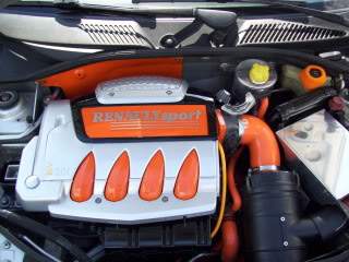

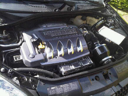

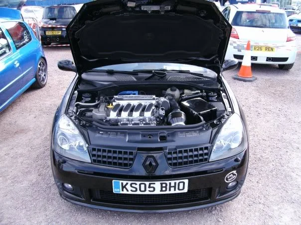

Here is some pics of my cover n my m8s bays...
M8 marks 172 bay... all powder coated i believe
