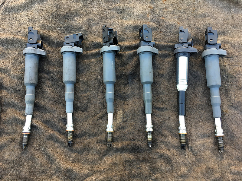

Initial fault finding so far has resulted in:
Cyl 1: Unknown brand coil pack, NGK spark plug – smells of fuel.
Cyl 2: Delphi coil pack, NGK spark plug – smells of, & appears damp with fuel.
Cyl 3: Unknown brand coil pack, NGK spark plug – no fuel smell.
Cyl 4: Bosch coil pack, NGK spark plug – no fuel smell.
Cyl 5: Unknown brand coil pack, NGK spark plug – no fuel smell.
Cyl 6: Unknown brand coil pack, NGK spark plug – smell of fuel, very wet tip.
I cleaned all the plugs, re-inserted, then restarted the car, Cyl6 was instantly wet with fuel, all others were fine.
Then swopped the coil packs around, misfire stayed with Cyl5/6. Did the same with the spark plugs, misfire stayed on 5/6.
If I pull the oil cap, the idle stays the same, i.e. doesn’t get any/even worse.

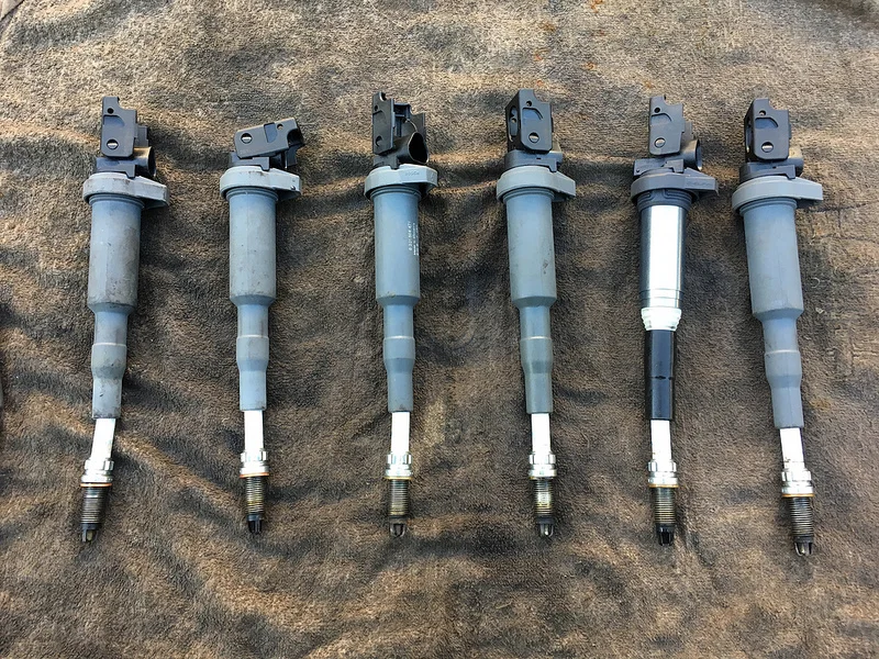

Cylinders 6,5,4,3,2,1:

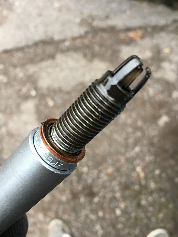

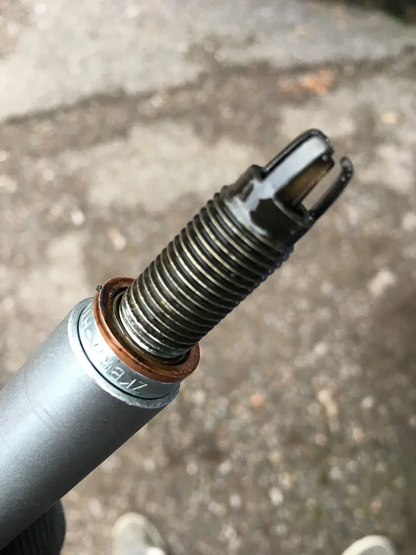

Cyl6 Spark Plug:
Untitled
by Sir_Dave, on Flickr

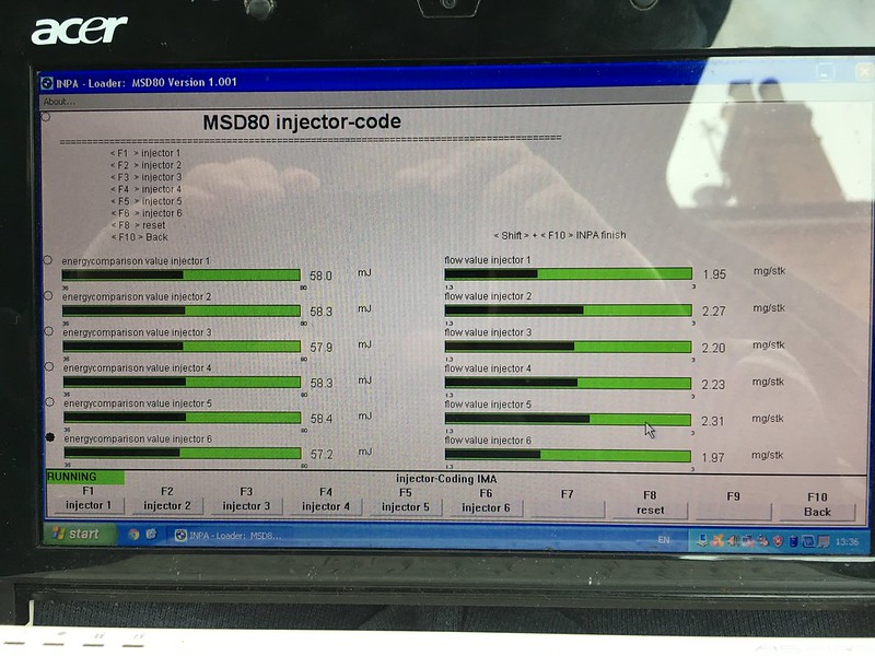

At this point, after swearing a little, having read that a completely failed DI injection can occasionally cause compression pressure to bleed away giving a false reading, I bought a new Index 11 injector & de-coupler. Having removed the old one, I was faced this this, appears covered in white gunk?

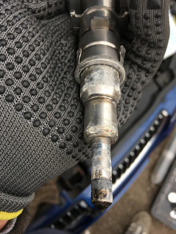

Cyl6 Injector:
Untitled by Sir_Dave, on Flickr
New injector fitted and coded with INPA:
Untitled
Re-started, still misfires. New compression test, this time done without any plugs in, all 155-165, barring cylinder 6 at 0.

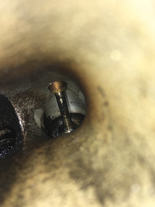

Had a leakdown test done at BMS Surrey and the inlet valve on Cyl6 is stuck open slightly. Realistically, its quite difficult to tell whether the cause is bending/sticking as you can only see so much with a borescope, but he said that the top of the piston & cylinder walls seem to look ok. To speed up getting it back on the road, i've just bought a used cylinder head complete with cams/valves etc, so the idea is to simply swop them over, then strip the old head & sell the unused parts.
Currently trying to decide whether i can bothered to do it all myself, on the drive, in the cold & wet, or just pay them 12 hours labour to do it ...

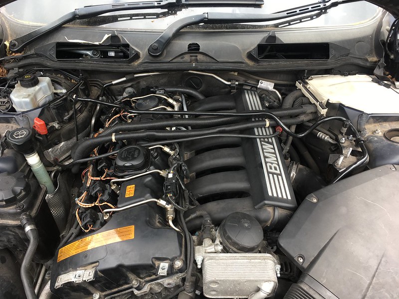

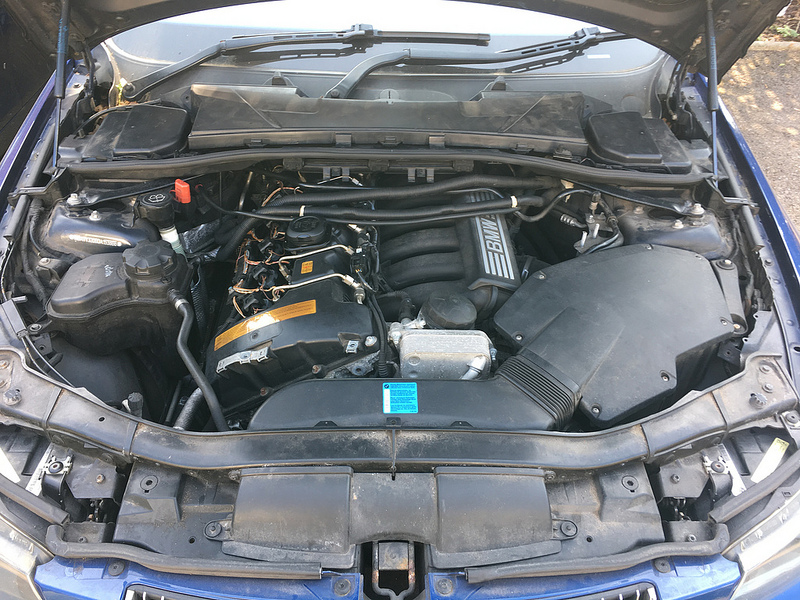

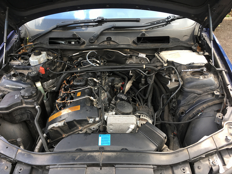

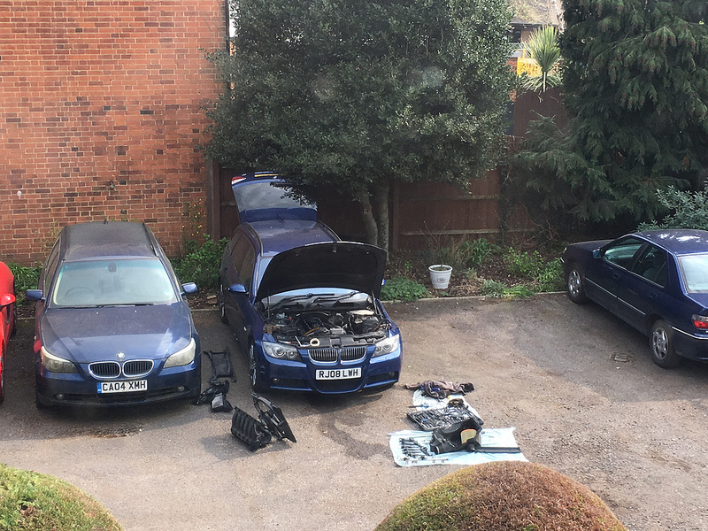

Weekend of the 30th/31st April, i made a start to the 325i's strip down ...
Starting point
Untitled

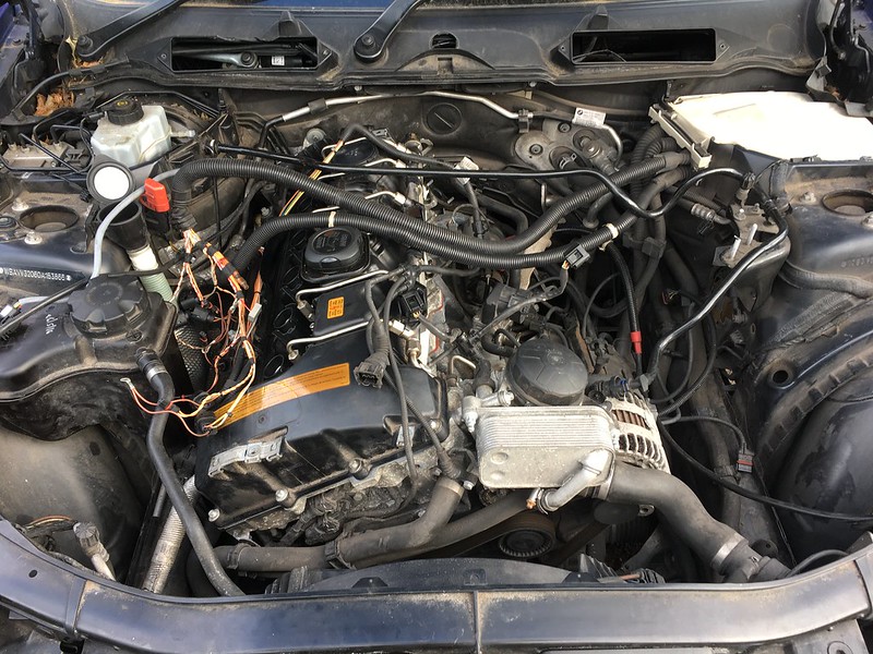

Inlet manifold removed
Untitled
Valve cover removed
Untitled
Organised chaos
Untitled

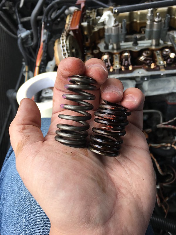

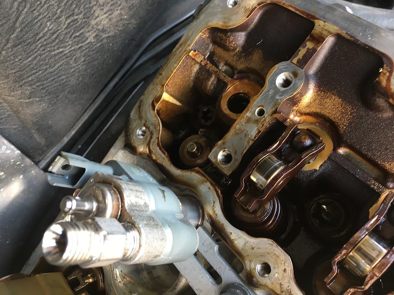

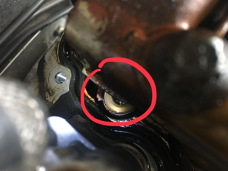

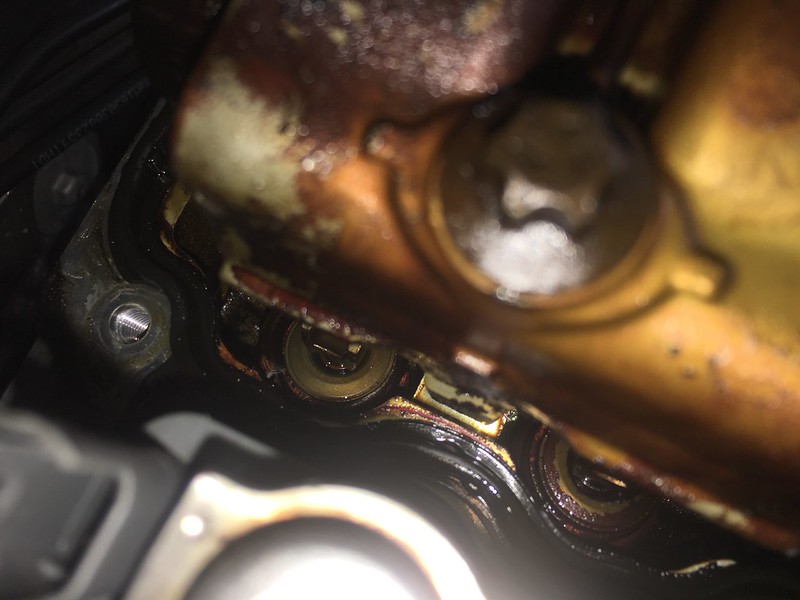

Turned the car over by hand a few times and by peering through the inlet opening, it does appear that the valve is still moving within its guide, but only to a certain point - meaning that the valve is still open say 5mm or so. Upon looking at the valve spring with the valve cover off, i "think" that i may have a broken spring; which would naturally stop the valve closing all way as its not being pulled all the way back out of the cylinder head. Its VERY difficult to see as its rather close to the bulkhead, but i think im going to remove the inlet cam (ordered the N53/54 timing tools today) and have a proper look before even considering pulling the head off.
With luck, itll be the valve spring and ill be able to swop it out with some overhead valve spring compressors. Normally you'd use compressed air to hold the valve up when doing the springs without taking the head off, but with their being no compression, i think, if im careful, i should be able to hold the valve up through the inlet opening with something to stop it dropping into the cylinder head. Otherwise i'll do the rope trick and feed that in through the spark plug hole, then bring the piston up to avoid the valve falling into the head - id rather not move the bottom end from TDC once its locked in place however. All in all, its a nice little project to keep me occupied through sunny days; useful to be learning on the job as well!!
Well hello there broken valve spring:
Untitled
Untitled
The valve seems to move freely up & down the guide, closing nicely against the block when lifted all the way up, so ive purchased an overhead valve spring compressor, N54 cam chain tensioner tool, 5-25nm torque wrench and torque angle gauge - this weekend ill hopefully be able to remove the inlet cam, then swop the offending spring with one from another cylinder head i bought. Fingers crossed that'll be sorted then!! (y)

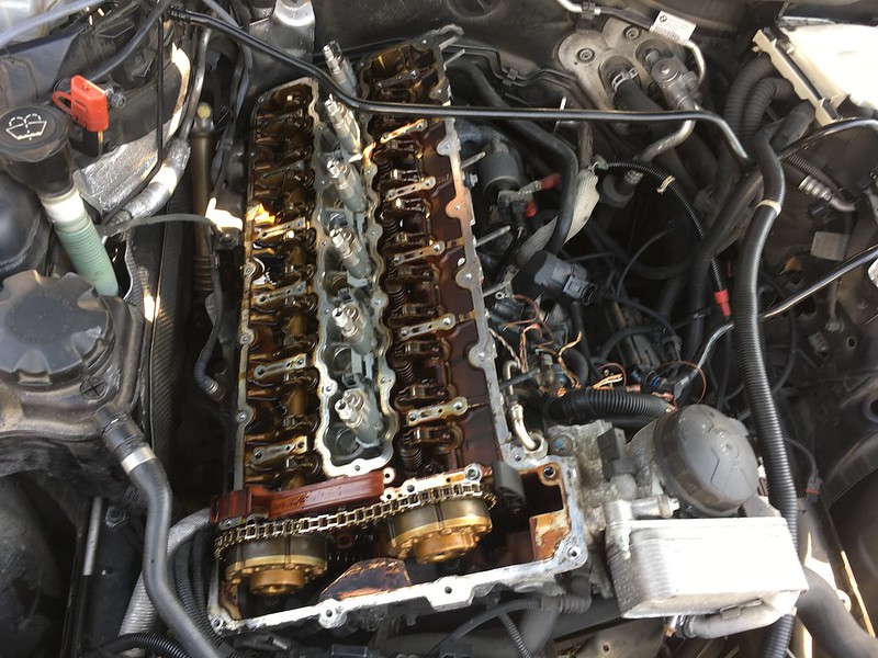

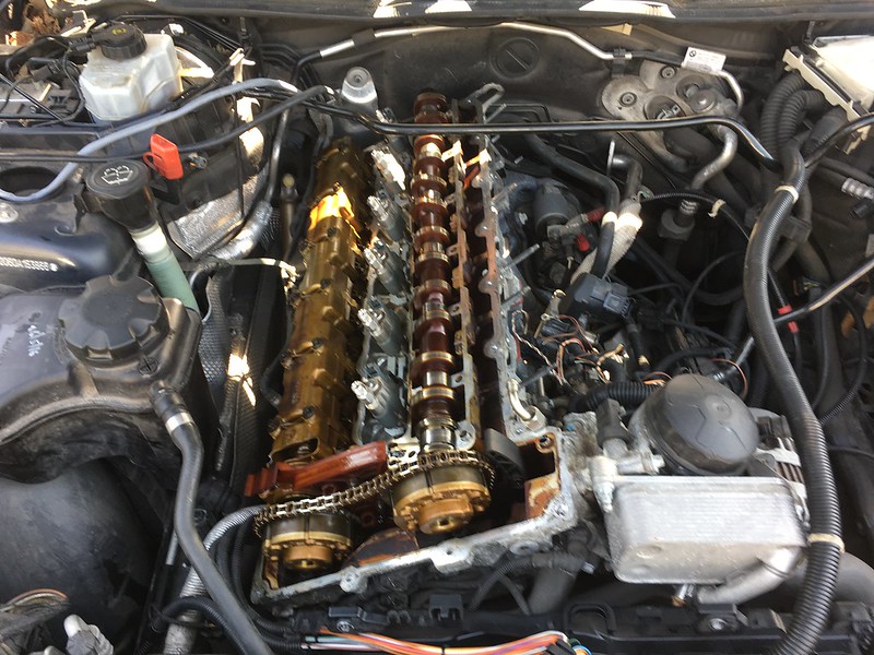

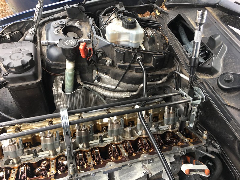

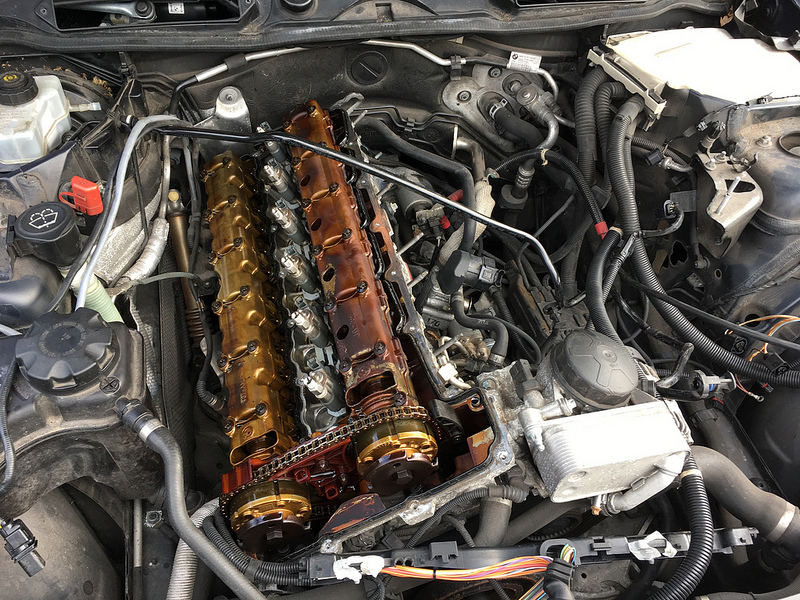

So Friday was 325i day.

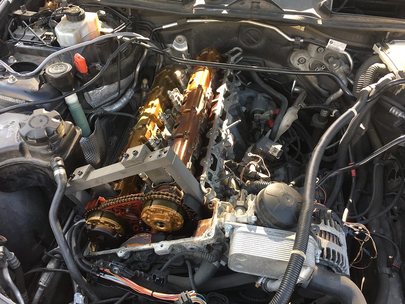

Valve cover back off, timing tool fitted:
Untitled
Timing chain tensioner removed, vanos hubs removed from cams, top half over inlet cam cover removed:
Untitled

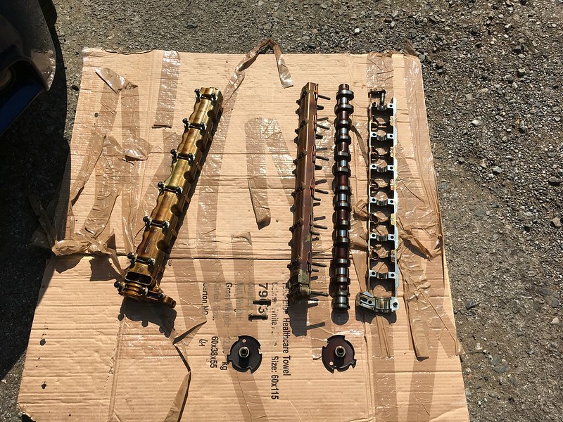

Both cams & their ledges removed:
Untitled
Untitled
Hydraulic lifter removed & valve spring on cyl6 inlet side is confirmed as the issue:
Untitled
At this point, i realised that my overhead valve spring compressor wouldnt fit. FFS. Hopefully the new one ive purchased will!!
If not, im going to simply keep trying new versions, there is literally no point going through the additional expense/hassle of taking the head off lol.

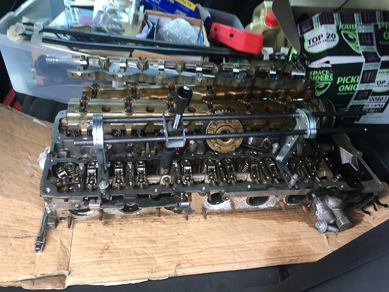

So then, onto last weekend ...
More new tools arrived in the shape of a Laser 5258 overhead spring compressor - very cool piece of kit!!
Testing on the spare cylinder head i bought for "practice":
Untitled
Then doing it on the cylinder head proper:
Untitled
As you can probably see, in order to stop the valve dropping down into the cylinder, i held it very lightly with some padded plyers held together with masking tape. Whilst the compressor tool is fine for one-handed use, removing the valve spring keepers was definately a job that required two hands!!
One very broken valve spring :ROFLMAO:
Untitled
All replaced and now i have a valve that seats correctly:
Untitled
New rocker cover gasket & rocker cover back on again:
Untitled
Nearly there:
Untitled
Then time to get the jump leads out, crack upon a beer to calm my nerves and start it... ?
Success!!

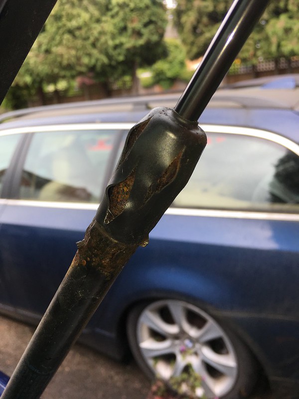

Both bonnet struts were knackered, so i picked up some new ones - although i forgot to take photos.
The tailgate ones were also a tad tired and no longer holding the boot off my head.
Untitled
£30 on Amazon later and some OEM ones (Stabilus make them, BMW then put £60 BMW tax on them):
Untitled

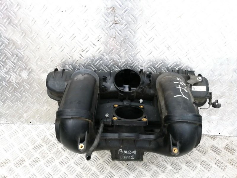

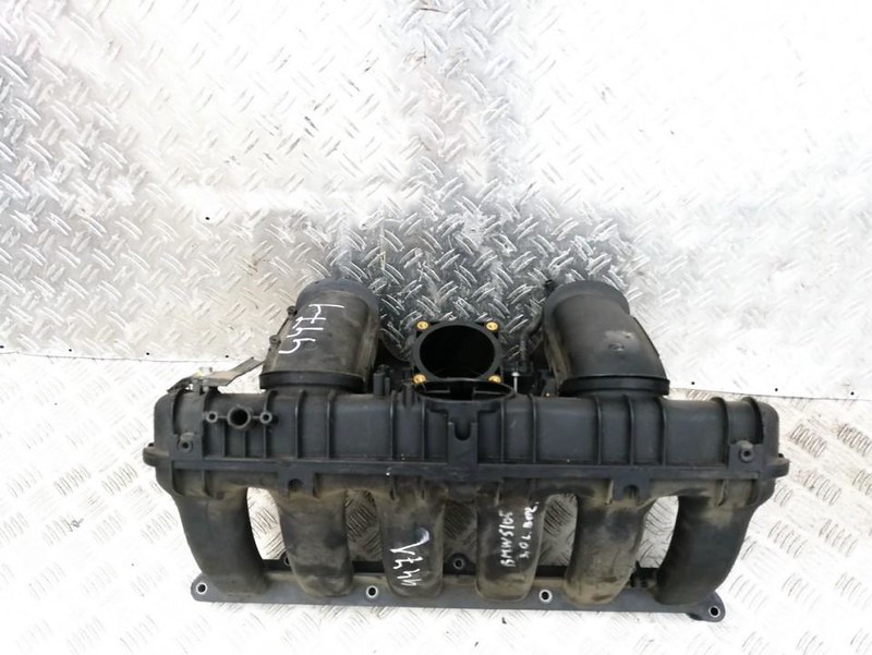

After a few months of searching, this just popped up on Ebay in Lithuania. Naturally, i bought it straight away:
00596733_2631960990
00596733_1689156219
596733_3222303222
I'll still need to buy the DISA flap and work out how to make the 330i OEM map work on the 325i (it can be loaded on with WinKFP with some "binary modifications" apparently), but getting hold of the manifold is the difficult part really (y)

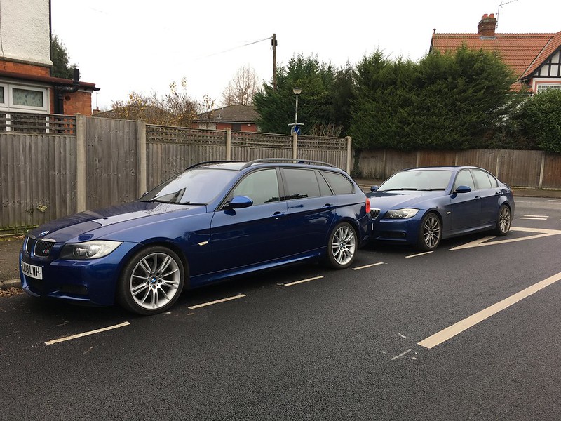

In terms of the 325i updates. This just happened.
Untitled
Semi-jokingly said i had too many e9*'s in a thread on PH, chap messaged me telling he wanted it, viewed it the next morning, took a deposit and its just driven off. Was handy in a way, i collected this yesterday ?
Untitled
Untitled
Untitled
Basically the bloke i bought the roofrack for Le Mans off texted me asking if i wanted it and well, i havent owned an M57 yet ... so, yeah, now i have.
Its a 2 owner '09 LCI 335d with Adaptive Xenons, Headbeam Assistant, CIC Nav, Split Front Armrest & Electric Folding Mirrors. Oh and:
