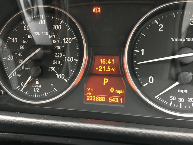

233k, nice. My old 320d had 251k on when I sold it
That makes me feel like im not the only nutter in the room, thank you!!
Haha awesome. Still on the original turbos?
Yup, its had all new vacuum lines, waterpump, thermostat & glow plugs/controller fairly recently, but the main hardware is all original.

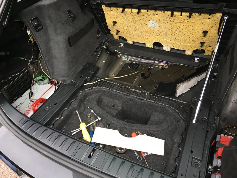

Had a bit more of a poke around with the 335d yesterday, purely as the underfloor subs didnt seem to be working.
After removing the front seats, i was pleasantly surprised to find a set of MB Quart's staring back up at me, along with some wiring to the boot, where, despite the tell tale signs of power and earth leads, there is no longer an amplifier. Removal of the door cards showed that the car actually has an MB Quart QM200.3 setup fitted in the front, with the matching QM100's fitted in the rear doors - always nice when you find £500 of speakers that you didnt know about!
Being that ive had an "BMW Alpine HIFI upgrade" in my e92 330d and have/had Logic 7 in the 335i/325i, i think i'll leave the MB Quarts in and purchase a TechnicPNP 2/4 harness from the US and an Alpine MRV-F300 (or similar) to power them - that should give quite a nice sound from my research on e90post.

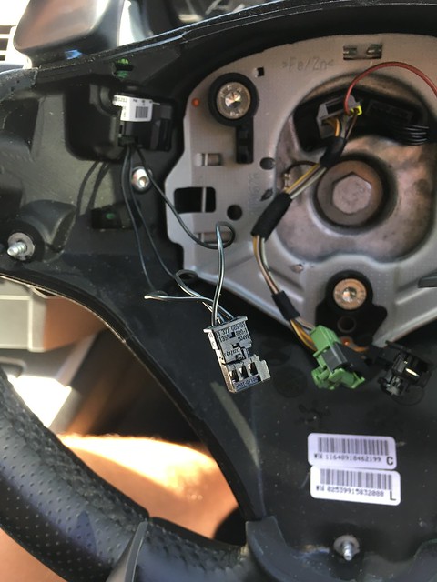

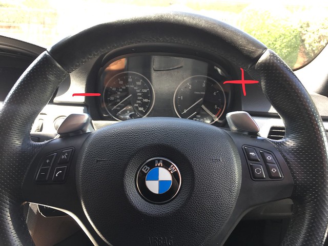

Also, next time you have a spare 10 minutes, disconnect the battery, remove the airbag & steering trim and swap wires 1 & 3 in this connector block:
Untitled
by Sir_Dave, on Flickr
That will then convert your "push for down" "pull for up" gearchange paddles into the correct/M3 style setup:
Untitled
I did mine yesterday, the standard setup does my head in o_O

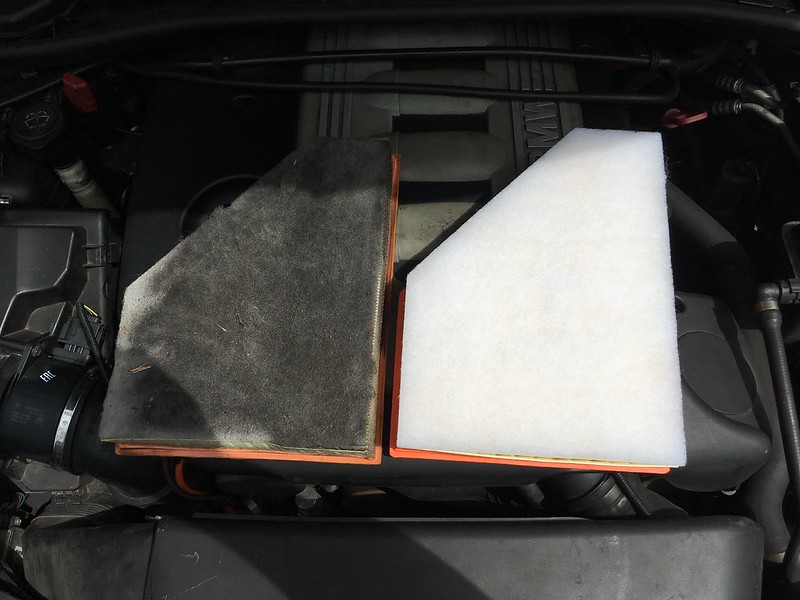

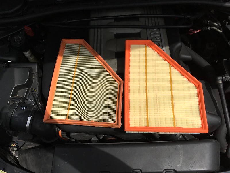

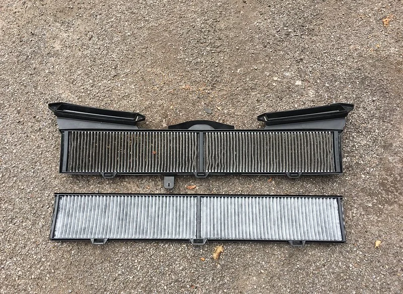

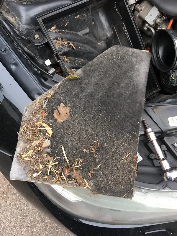

Standard "ive bought a BMW" essential maintenance post:
Air Filter :ROFLMAO:
Untitled
Untitled by Sir_Dave, on Flickr
Untitled
Pollen Filter
Untitled
MAF was reading properly either, so bought/fitted a new one:
Untitled

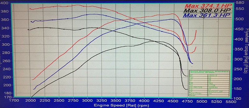

They're insane with a little tweakery, I'm still shocked by mine sometimes with the XHP and Burger box. In gear it's just savage, it doesn't even feel like an engine, more like a turbine.
Funny you should say that ... a friend has had his 335d redone recently (wasnt happy with the smoke from the old tune on cold start). Turns out they hadnt turned off the EGR properly :rolleyes: Black line is standard, blue is old file, red is latest BWChiptune version. Needless to say, his is a monster :ROFLMAO:
Untitled
Deffo needs to put XHP on it though, whilst its ballistic in gear, it does feel a bit slushy when its doing its torque convertor thing.

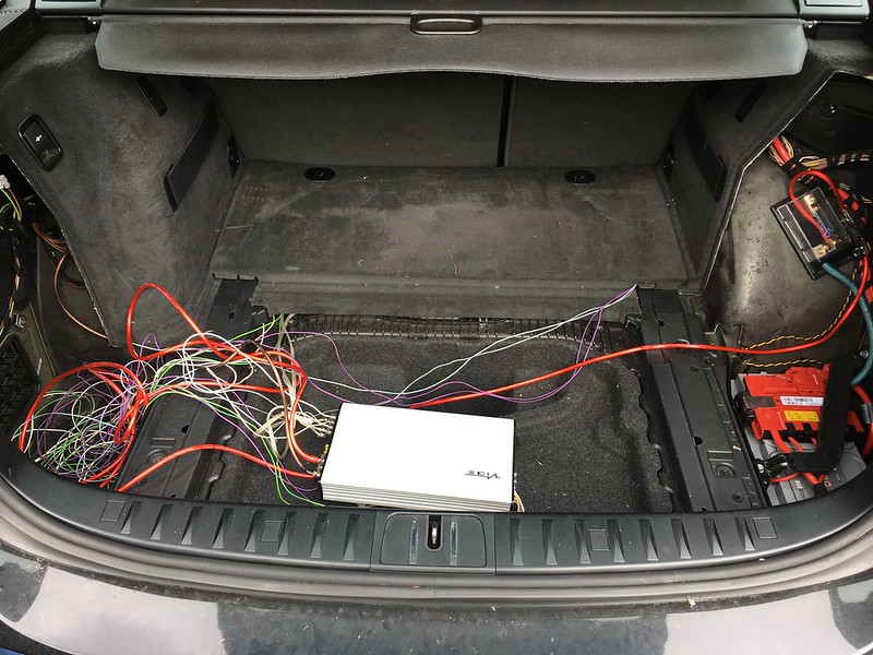

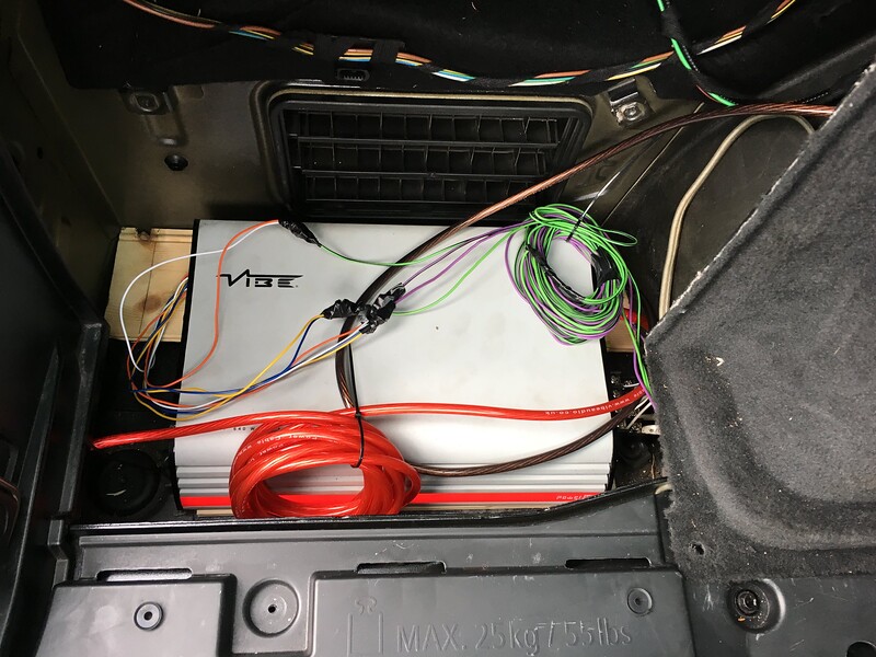

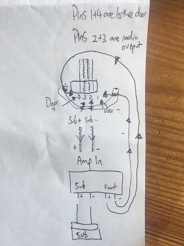

Back onto mine ... Vibe amp is now fitted.
Untitled

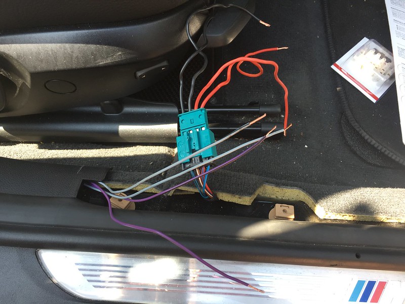

Wiring diagram - this is essentially the same as this: https://technicpnp.com/product/stereo-24-harness/ but for £20, not £100.
Untitled
Naturally the headunit doesnt have pre-outs, so you need to take the full range signal from the underseat subs using the following connectors: https://www.ebay.co.uk/itm/BMW-3-SE...SEAT-SUBWOOFER-CABLE-ADAPTER-SUB/362146766206
Untitled
At the amplifier end, you merge the left sub level wire into channels 1 & 3, then right into 2 & 4 to power just the front components/underseat subs using all 4 channels - with the rears still being powered by the headunit. By using an amplifier with speaker level input and signal sensing (to turn it on) you avoid having to use convertors/remote wires.
Initial wire up and test:
Untitled
Bit more tidying:
Untitled
Untitled
Finished:
Untitled
Sound wise, i dont think its quite as good as Logic 7, but probably a bit better than HIFi and on a different planet to the cr4ppy base system (y)
