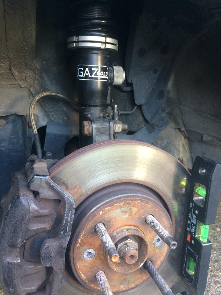

Evening all,
After treating the Clio to some GAZ Gold coilovers at the end of last yearthey have finally arrived from GAZ. However, I’ve noticed the front’s don’t have the little bracket/bar with the threaded hole for mounting the ABS wire bracket too, as per the OEM shocks.
Just wondering what others with GAZ’s have done in terms of adding a mounting bracket for the ABS wire or how they have secured the wire out to the way so it doesn’t get snagged when turning the wheels?
Secured mine with a cable tie , no issues at all.
