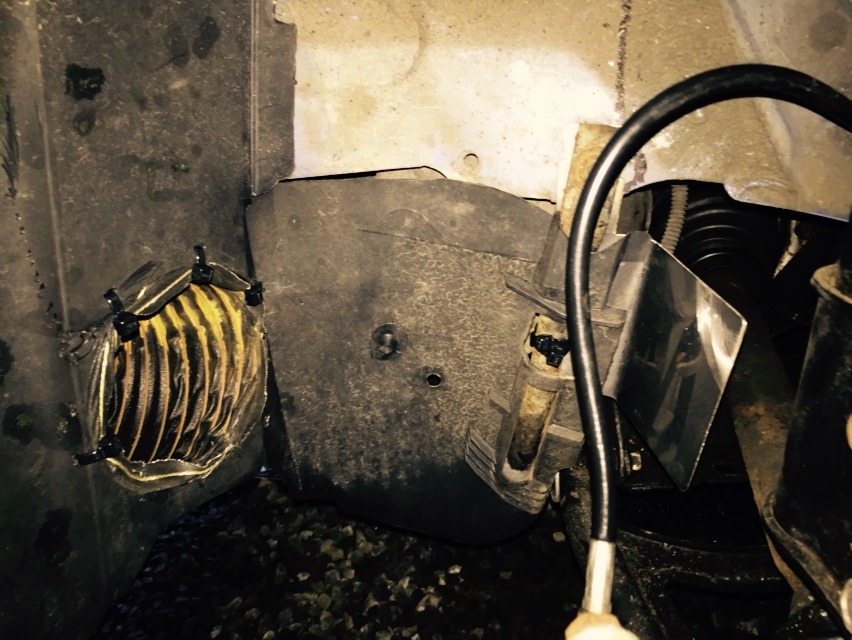

I kept mine in, it does expose the crank pulley/aux belt on the drivers side, not sure that's such a. If deal on a track car though. I just cut 100mm holes and ran duct to deflector plates for brake cooling.
Sorry, it's not pretty and clean..... Just functional :smile:

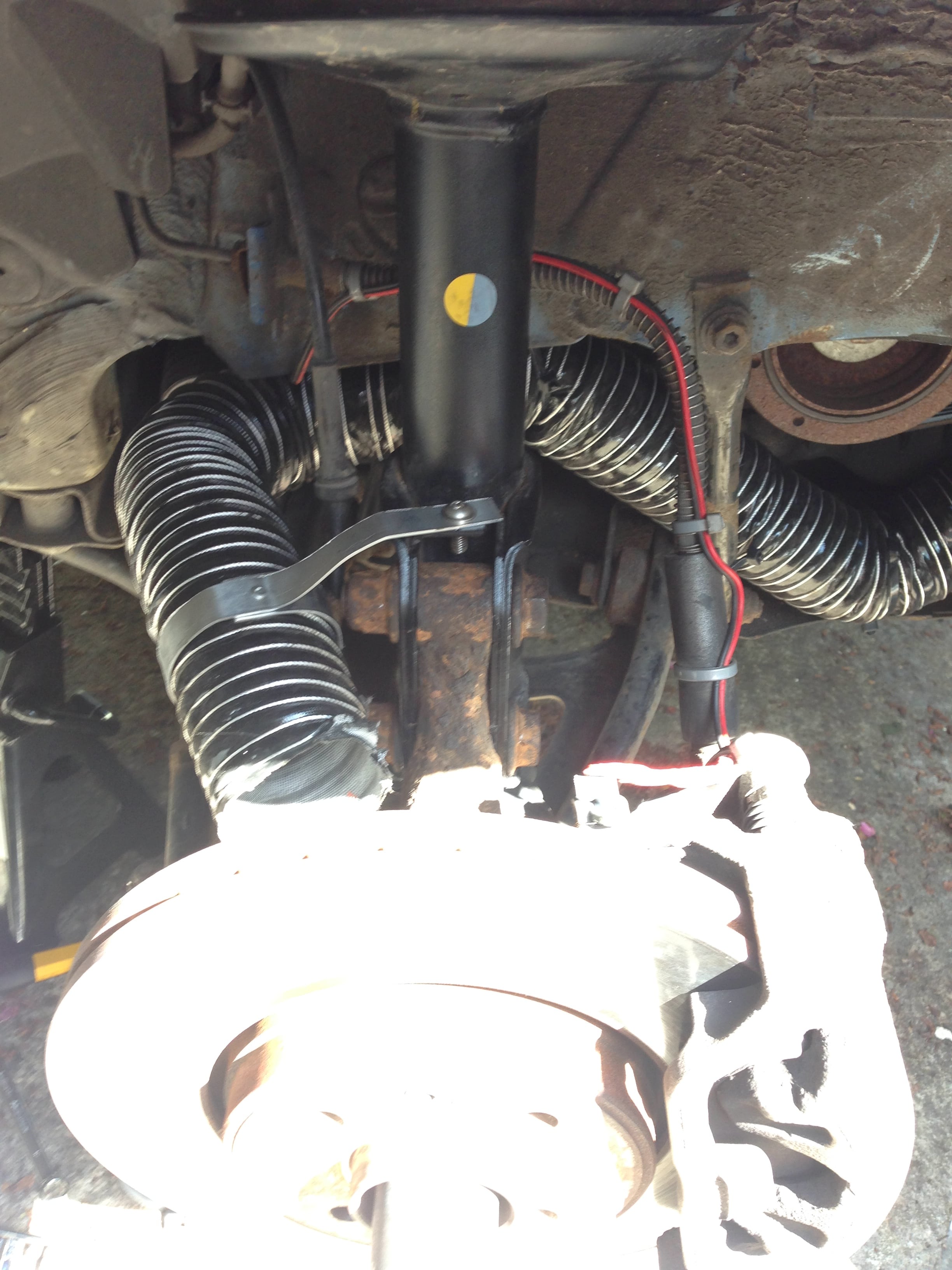

Brake cooling options really are a bit crap on these cars:
* Package space is very tight so ducting diameter is hugely restricted.
* The discs vent from the outside inwards not vica versa.
* You can't go particularly aggressive with deflector plates AT ALL because at full lock on bump/droop the (already stretched) brake lines will contact the plates. (However much chaffing it would take to get though a brake line, I for one don't want to arrive anywhere with no brakes just for the sake of getting 2 more laps in on a track day before brakes fade)
* The gap between the CV boot, strut & calliper is far too small to get any ducting to the calliper.

I have the sinilar set up to mark above. I wouldnt want to remove the liner tbh. With regards 'does it make a difference', i would say yes. It wont make it worse thats for sure :)
I suppose that's the other question, without deflector plates and some ducting would removing the fogs and modifying the arch liners for more airflow actually make a blind bit of difference?
The 1st track day in mine I had the fogs removed, nothing else done and my brakes were on fire :fearscream: Added the ducting and deflectors and they take all the abuse I can throw at them

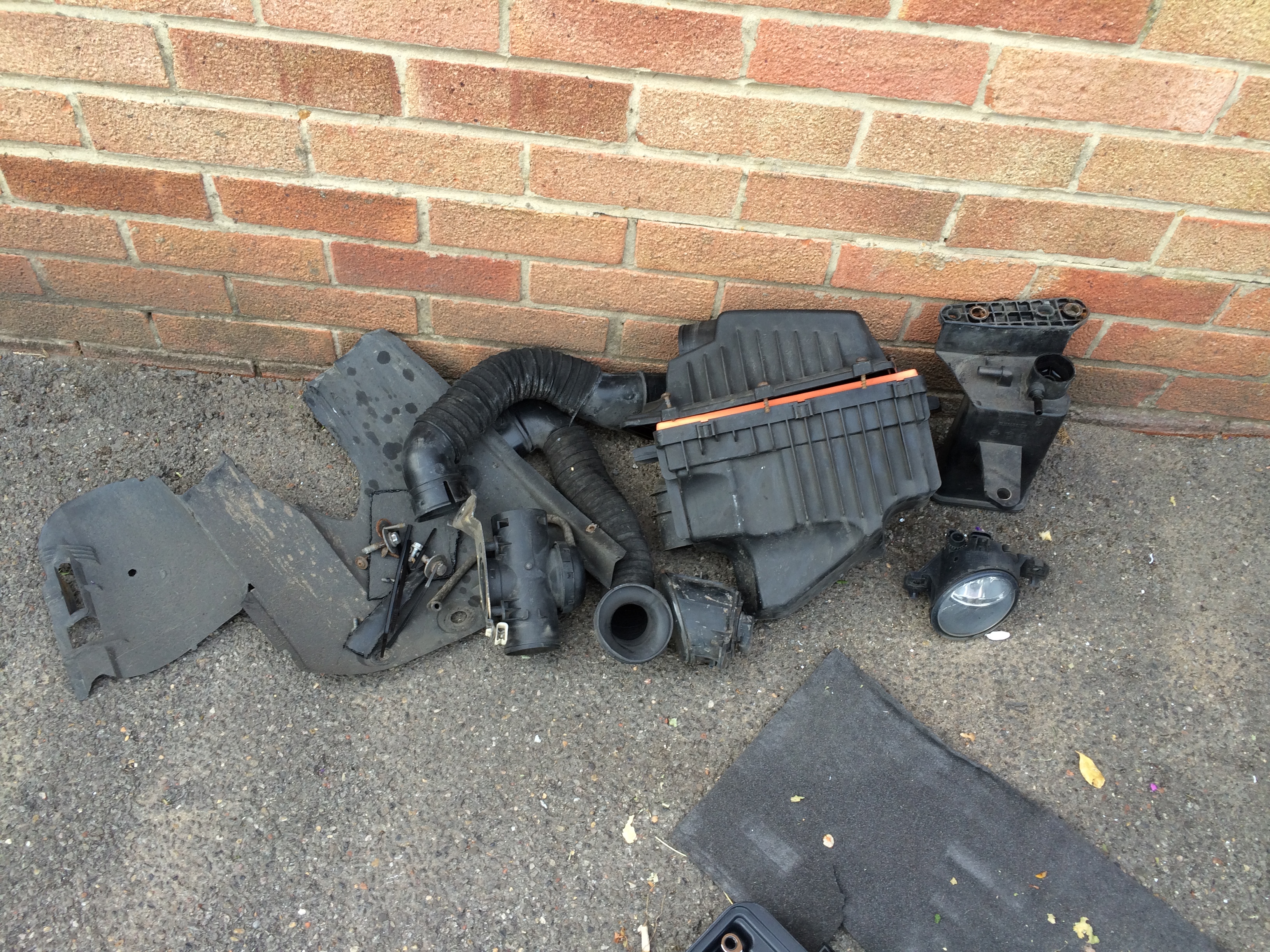

All the crap I stripped out of the car:

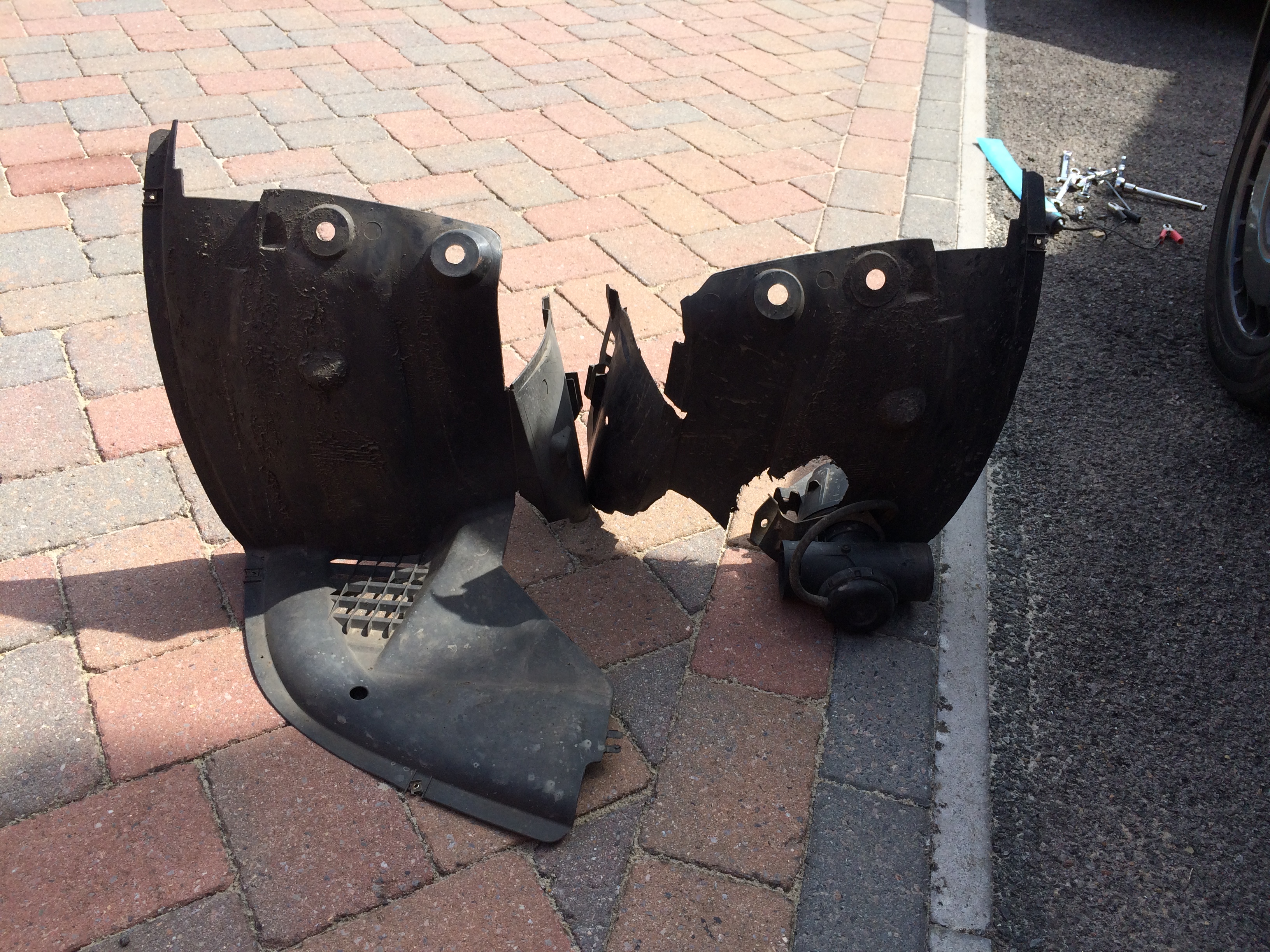

The wheel arch liners - spot the difference between the knackered passenger side and the OK driver's side? :)

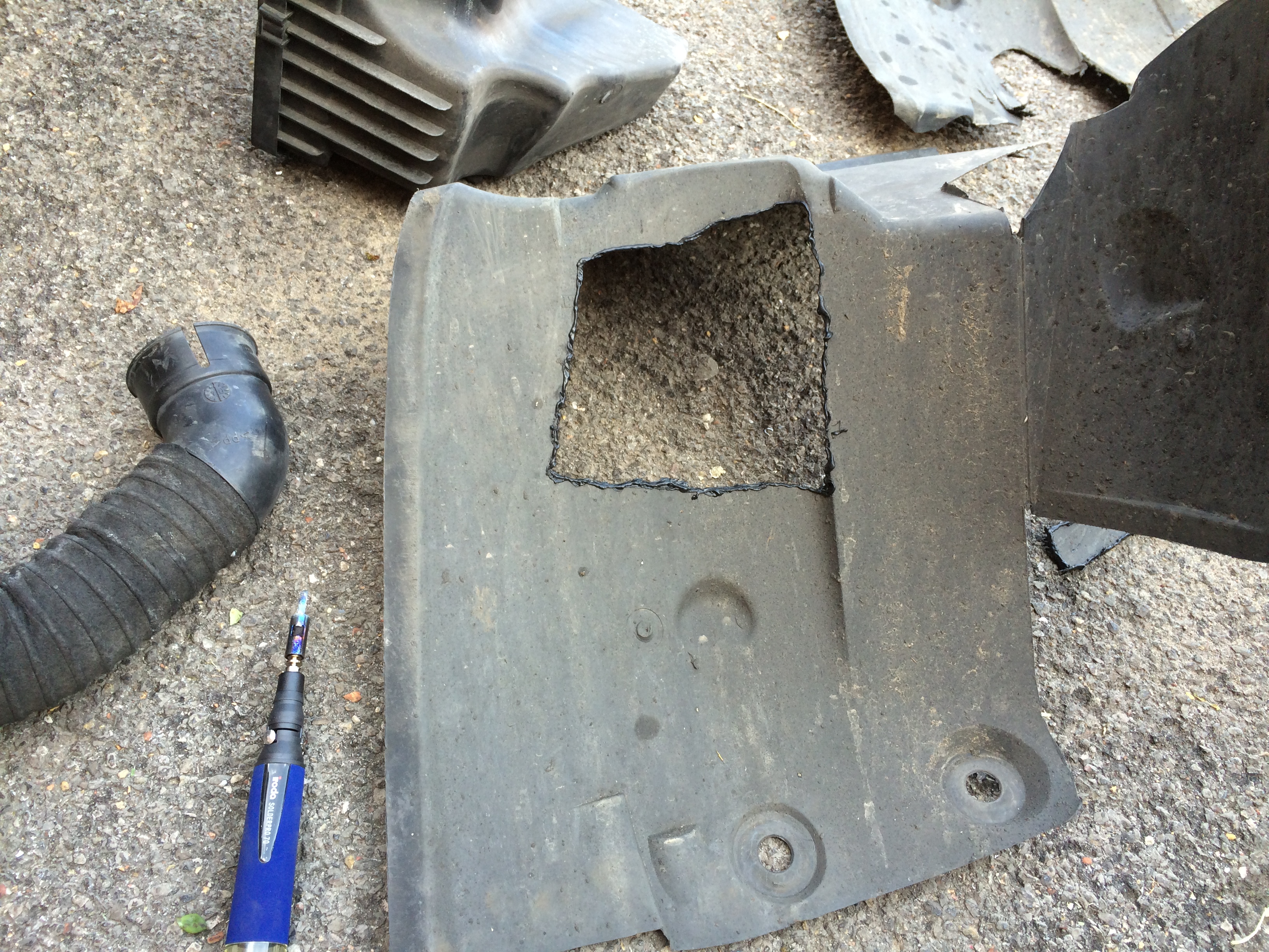

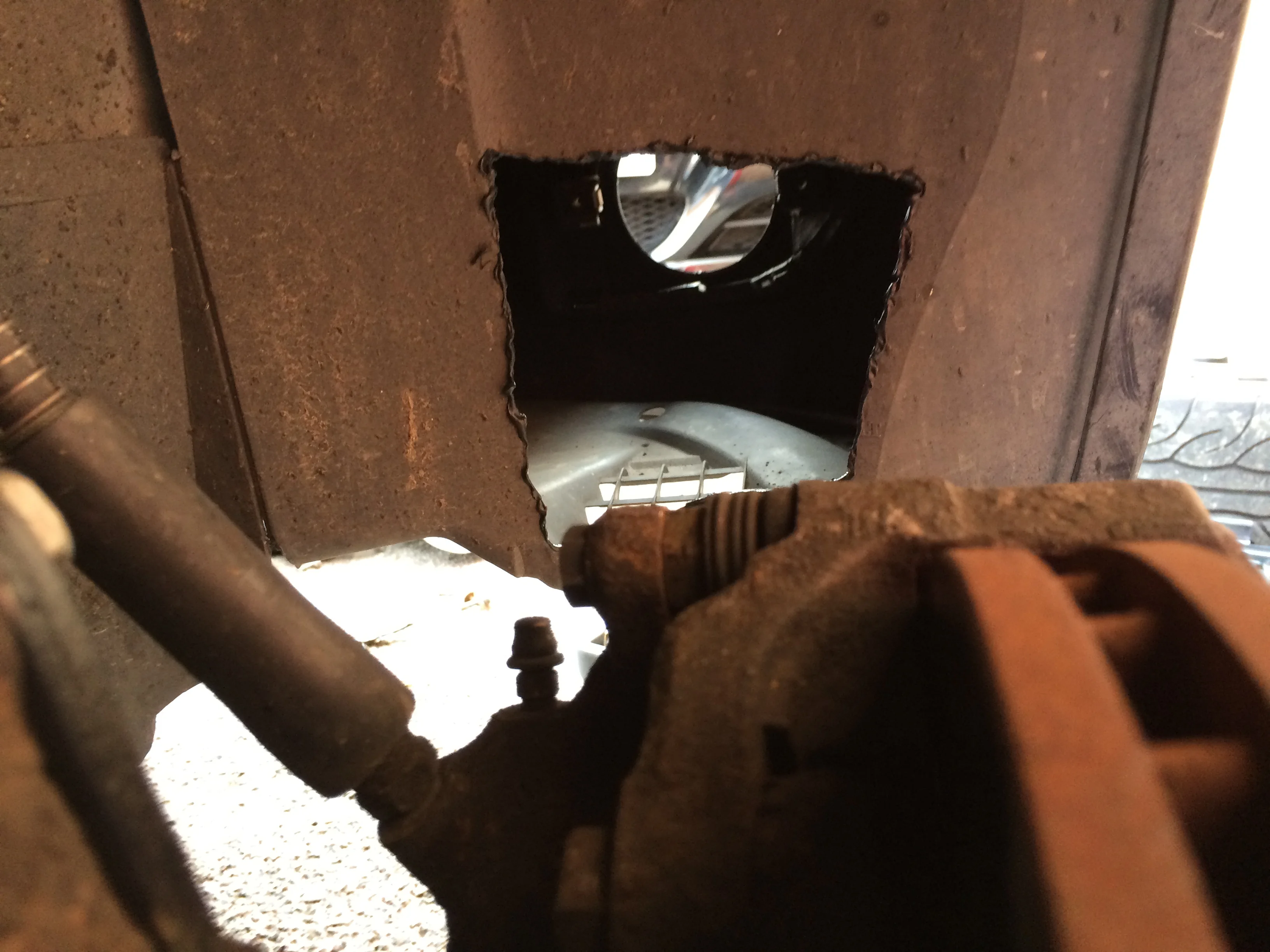

Modified wheel arch liner - knew that butane soldering iron would come in handy.....
Fitted back on the car, will hopefully help the cooling although obviously some ducting would be better.
