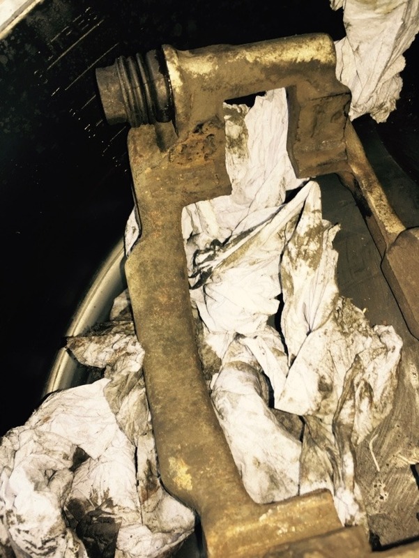

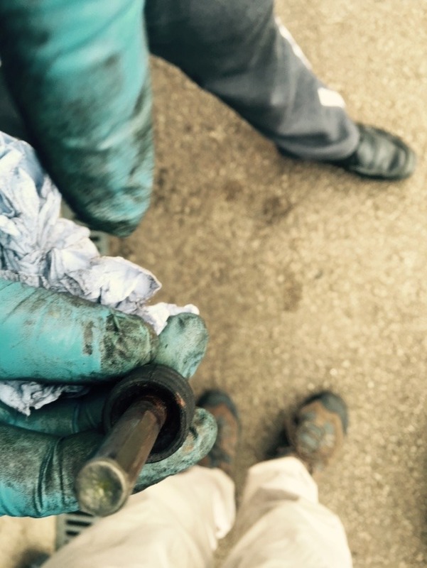

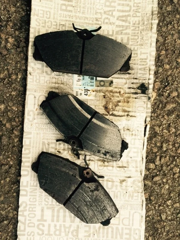

Well I just filed down the old pads and dropped them in pretty easy, no joy. Here are some pictures hopefully someone can point out something that i've just completely overlooked...

Bent pad/caliper carrier was the issue with it... what a b*****d lol

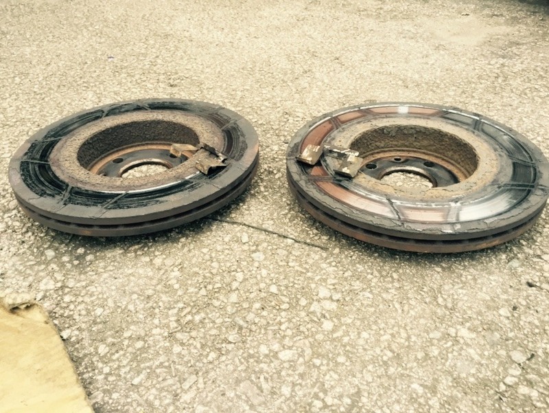

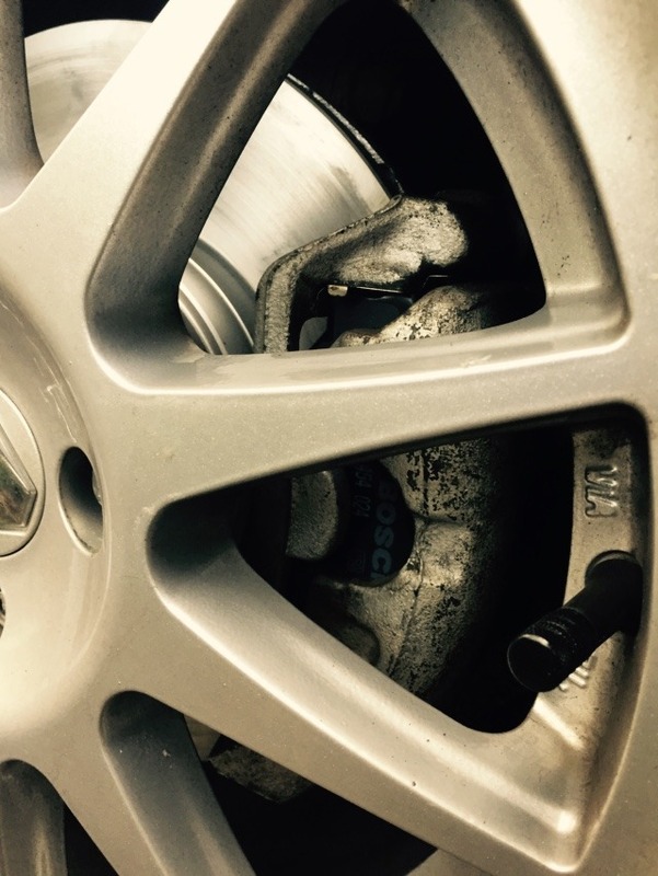

  Clio 172, Escort RST
I was about to say. I bought my Clio with new discs and pads yet they were useless. The cause? Rust beneath the plates. A specialist recommended me to bin them but I was reluctant to have clunky pads on the daily. In the end I ground the rust away, put some brake grease between the carrier and the new plates and the brakes are now spot on. The layer of paint may not have helped ; many people I know really struggle to fit the pads in.
Grinding the backplates is one away around the issue, but why do that when the cause is still there?
Anyway, some photos:

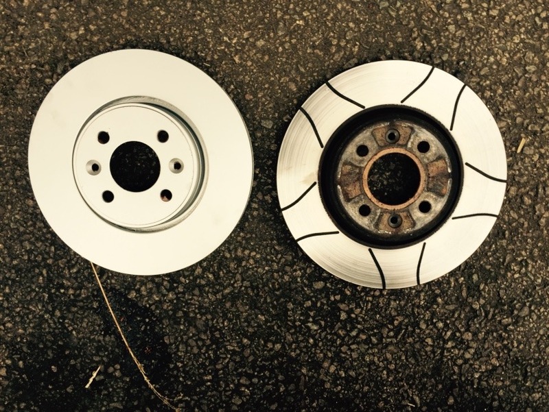

The new gear:
All looks fine:

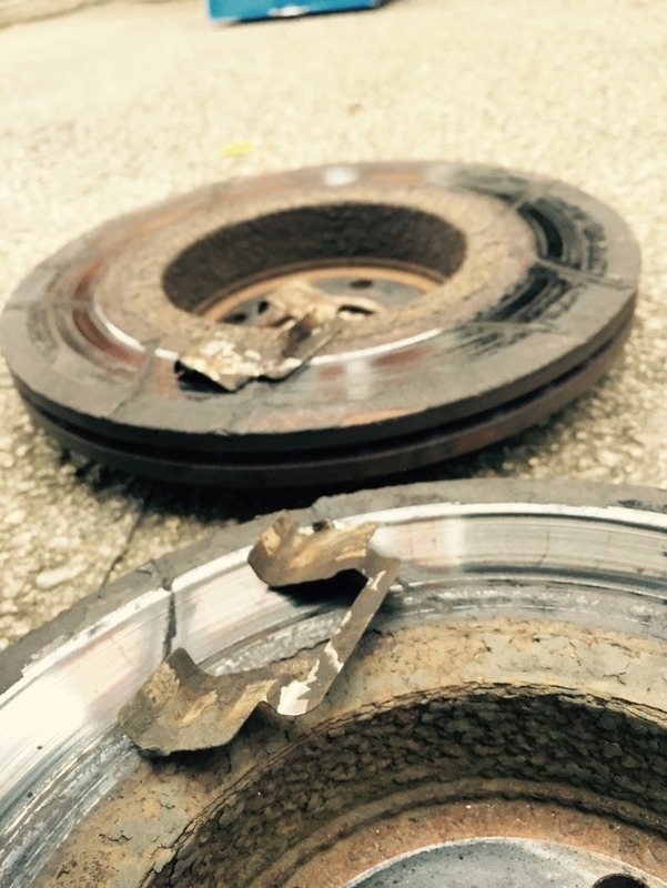

Errr. Yes, the inner grooves had worn almost flush with the rest of the surface area:

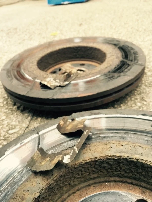

The start of taking away the rust beneath the slider plates. I painted behind them with etch primer:

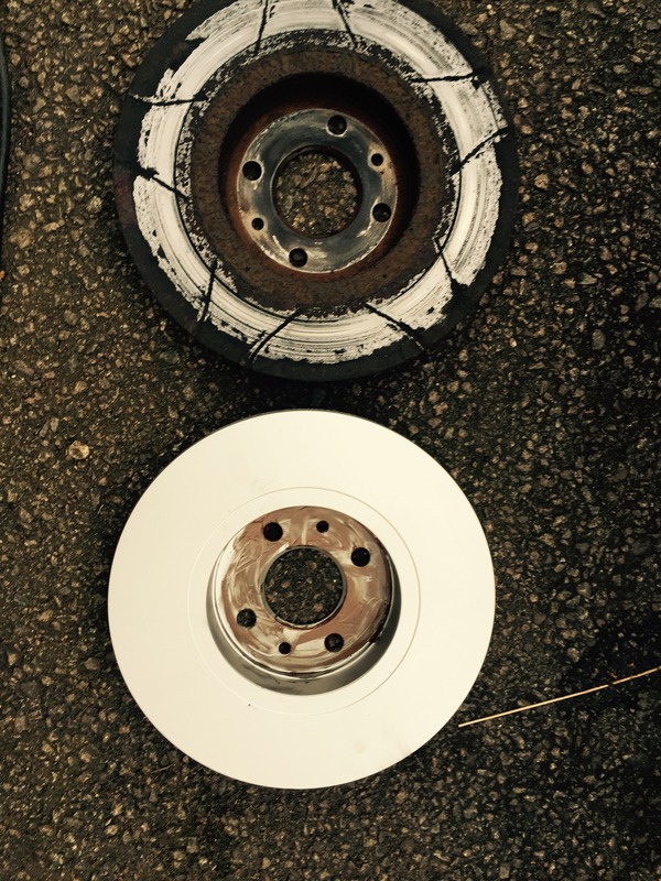

The pads were not pretty:

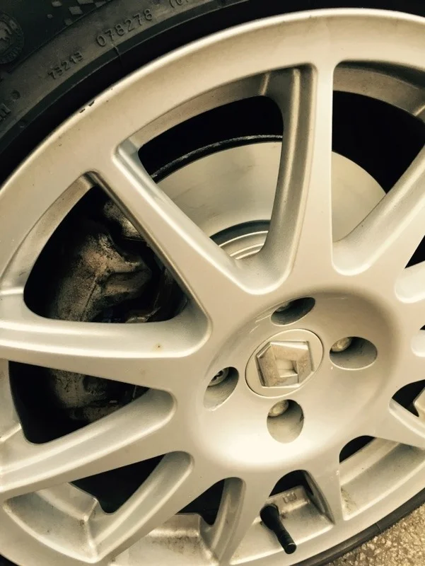

The new bits on:
