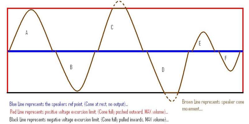

A&B represent cone movement at head units SAFE max volume
C&D represent cone movement when SAFE max volume exceeded
E&F represent cone movement at normal listening levels
On trace C&D you can see how the cone reaches max voltage & sits not moving, at this point distortion is apparent.....
HTH mate....
