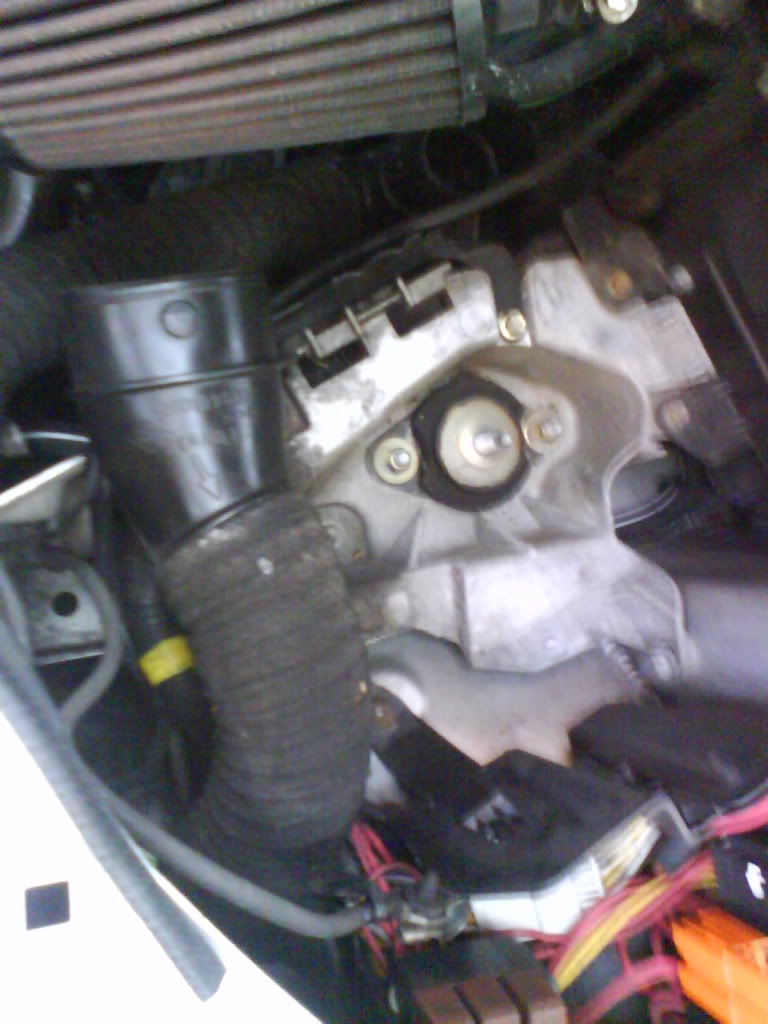

Ye lower on, whats that metal kinda thing though on the front? I bought the mount from ktec and all it is, is a rubber block with 2 threaded bolts coming out that cant be removed :s ph2 172 btw
This the one you mean mate? Only pic i have sorry.
Yep, when i bought mine all i received was what you got . The rest in the pic is what it is mounted to . Just like the upper righthand in the pic, the big piece of metal is not what you get when buying the mount; it is what the upper gearbox mount is mounted to **EDIT** ^^ like seen in the above pic here that's just been posted

Shouldnt need to be drilling anything mate. The bottom bit of the mount bolts through the subframe, the top one bolts through a metal cover type thing and that is bolted to the gearbox
Red arrow: The steel bracket that the rubber part will mount to.
Green arrow: one of the bolts integrated in the rubber part sticking out. other bolt mounts through the subframe.
Shouldn't need to be drilling anything mate. The bottom bit of the mount bolts through the subframe, the top one bolts through a metal cover type thing and that is bolted to the gearbox
