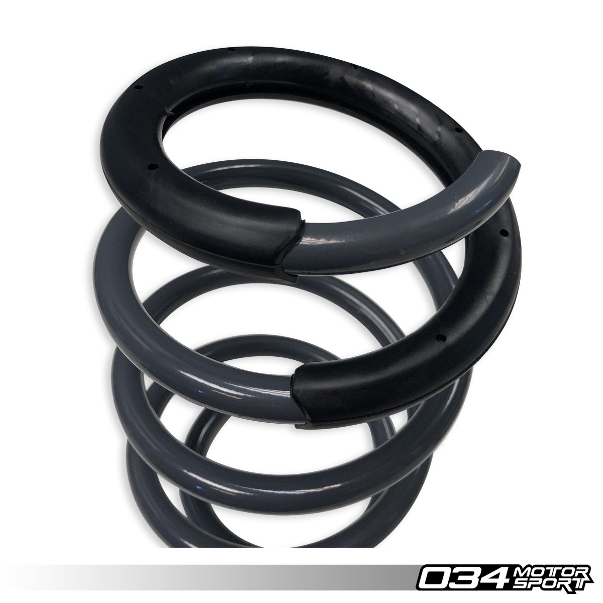

There aren’t any conventional isolators like so:
There are supposed to be isolating sleeves, on cup packed 182s at least, which aid NVH by preventing metal-on-metal coil clash and aid durability by prevent grit from getting caught between coils and grinding against paint. I am sure that absolutely no-one bothers with these when replacing springs lol.
