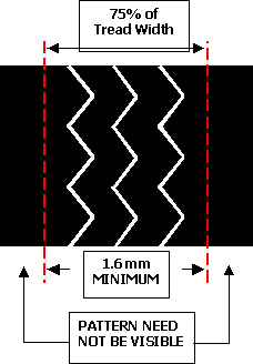

This is what it said on another website mate:
Tread Depth
The legal minimum tread depth for cars and light trailers (including caravans) up to 3500 kgs gross vehicle weight and/or 8 seated passenger vehicles including driver is:
A minimum of 1.6mm in a continuous band throughout the central three-quarters of the tread width, throughout the whole of the circumference (see illustration below).

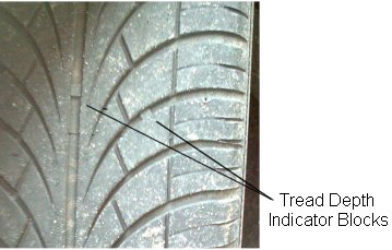

The tread is all still their, its just a lot less than the back tyres. Its showing a little wear on the edges of the tyres witht the pattern starting to wear.
These are what i was talking about in the first post along the main tread, the TDI. Once these ar level with the tread then my tyre will be bald, currently its ok, should last another couple of months. I've done 21,000 in my car.
