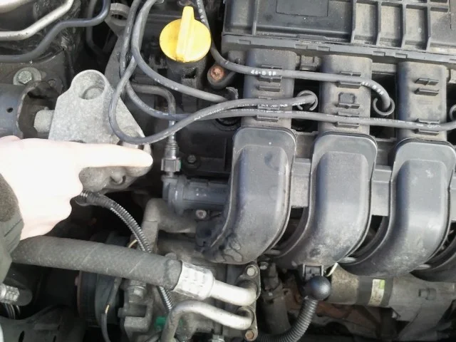

Any pics of the connector to make sure before I lead you down the wrong path
It's the part I'm pointing at...
Ahh sorry mate completely different connector and fuel rail by the look of it on the 1.2 compared to the 172 :(
