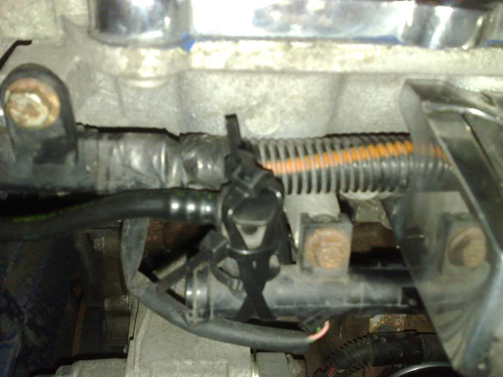

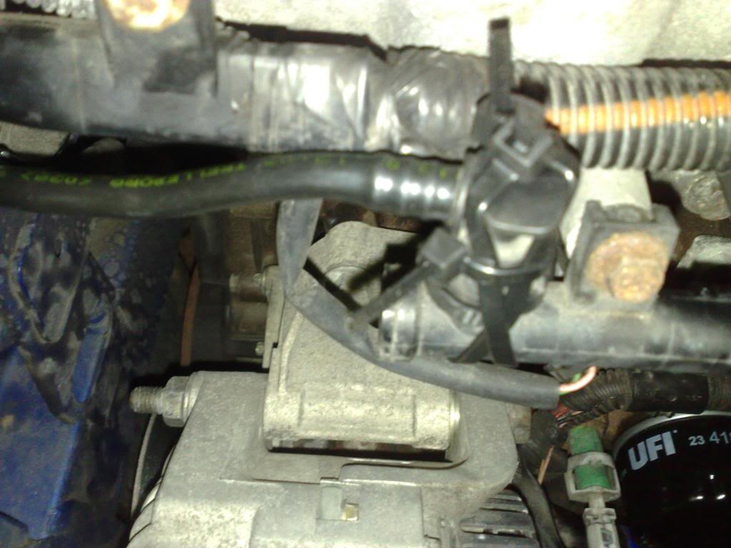

hey guys went to petrol station tonight filled up then started me car then next thing it cuts out :( tried to start it again just to find out the main fuel line clip that joins to the fuel rail popped off and it buggered :( does anyone have one?? and does anyone kno if i have to replace the whole pipe or can i just get a new clip from renault cus its that hard plastic piping

that pipe (luckily) has a break in it just behind the drivers side wheel on the chassis leg, i'll dig the part number out when i get chance
As said above, the pipe has a break in it. This happened to mine only at the other end of this side of the pipe, kept popping out and pouring petrol out the bottom of the car.
Went to a scrappy and scavenged a new pipe from another car, fitted it and had no trouble since
ahh well its just not me thats been unlucky with this then when tried to re star my car oh my dear lord fuel went everywhere it even sprayed through my grille dohhhhhhhhhhhh fred you have a pm :)
