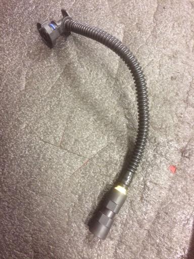

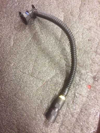

I make these , is this what your after ?
I think so mate, Assuming you can take the fuel pipe off the original fuel rail and then plug it into this to use as a drain?
are you able to make them longer? I was looking for one to be long enough to easily reach from the original fuel rail down the front bumper in order to get into a fuel jug thats sat on the floor infront of the car
It can be yes , I can supply a long pipe to reach the container / floor.
Message me and we can chat [emoji187]
