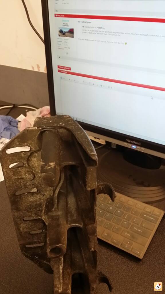

The 2 10mm nuts are both rounded that hold the fuel rail guard on. :( any idea how I can get them off? There is next to no room either. Thanks

Hit fuel rail guard with a hammer and shatter it, then buy new one for £5
So hit a bit of cast metal that was specifically designed to take a blunt impact and resist such impacts then in doing so risk breaking the lower inlet plenum/plastic fuel rail or worse (and slightly extreme), rip the M6 grade 8.8 studs out of the head? Yeah, I wouldn't do that.
They are made to take a front impact, not one from the top ;)

The support ribs below suggests otherwise Danny... but I'm up for watching someone that one.
