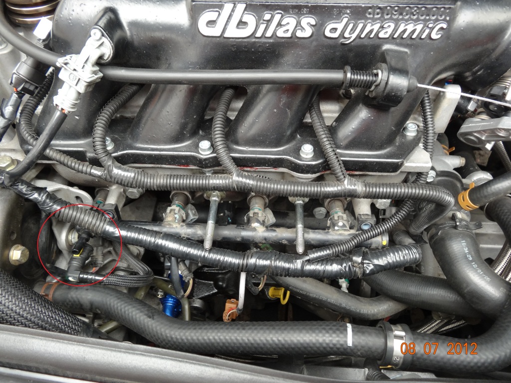

Hi,
I want to "convert" my fuel rail to AN fittings and hoses and nneed to know if someone knows the ouside diameter of the fuel inlet tube?
I found this fiting and it is 5/16", don't know if could work:
Thanks!
Thanks!
The AN fittings aren't in milimiters...the fiting is 5/16" (0.3125"), this is 7.9375 m.m., I guess it could work
Just thinking, this is what my megane 225 fuel rail inlet but I thinkthe Clio is a different connection. None of mine are the same as yours. You'd be better just measuring it.
The lower inlet shape and design doesn't look far from an F4R one. Anyone got one of each to compare?
