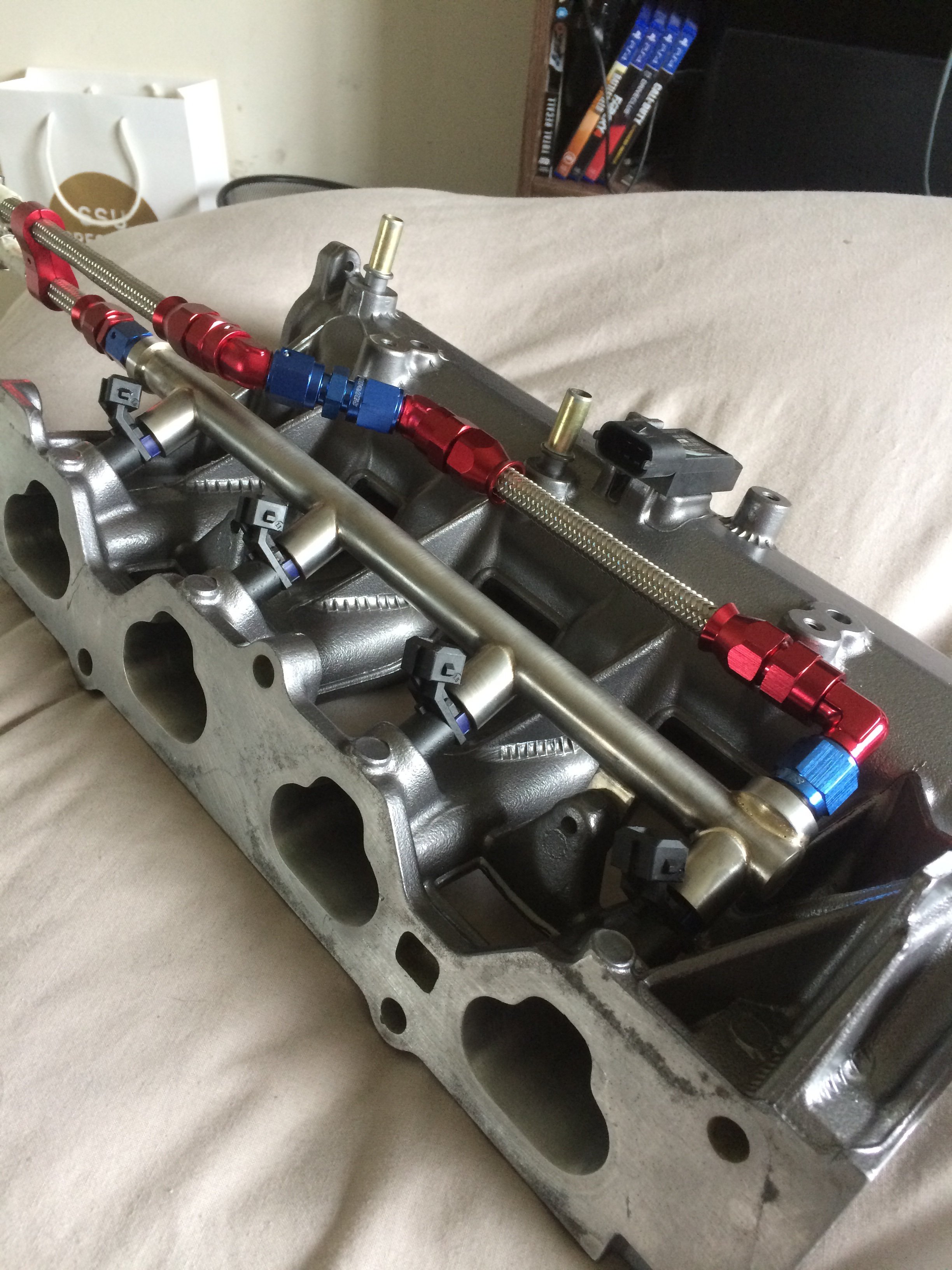

Does anyone know if any F4R engines have alloy or steel fuel rails ,looking to replace my plastic one and modify to take -6 fittings and conventional regulator
Thanks Dave
Or make your own. Or most fabricating companies will be able to make one for you.
Jenvy might also do one
You can run an external regulator on the stock fuel rail, and you can convert the in/out to -6 in a less glorified way if you wanted to keep costs down. I tested the plastic rail to 7 bar without issues too, its quite strong.
