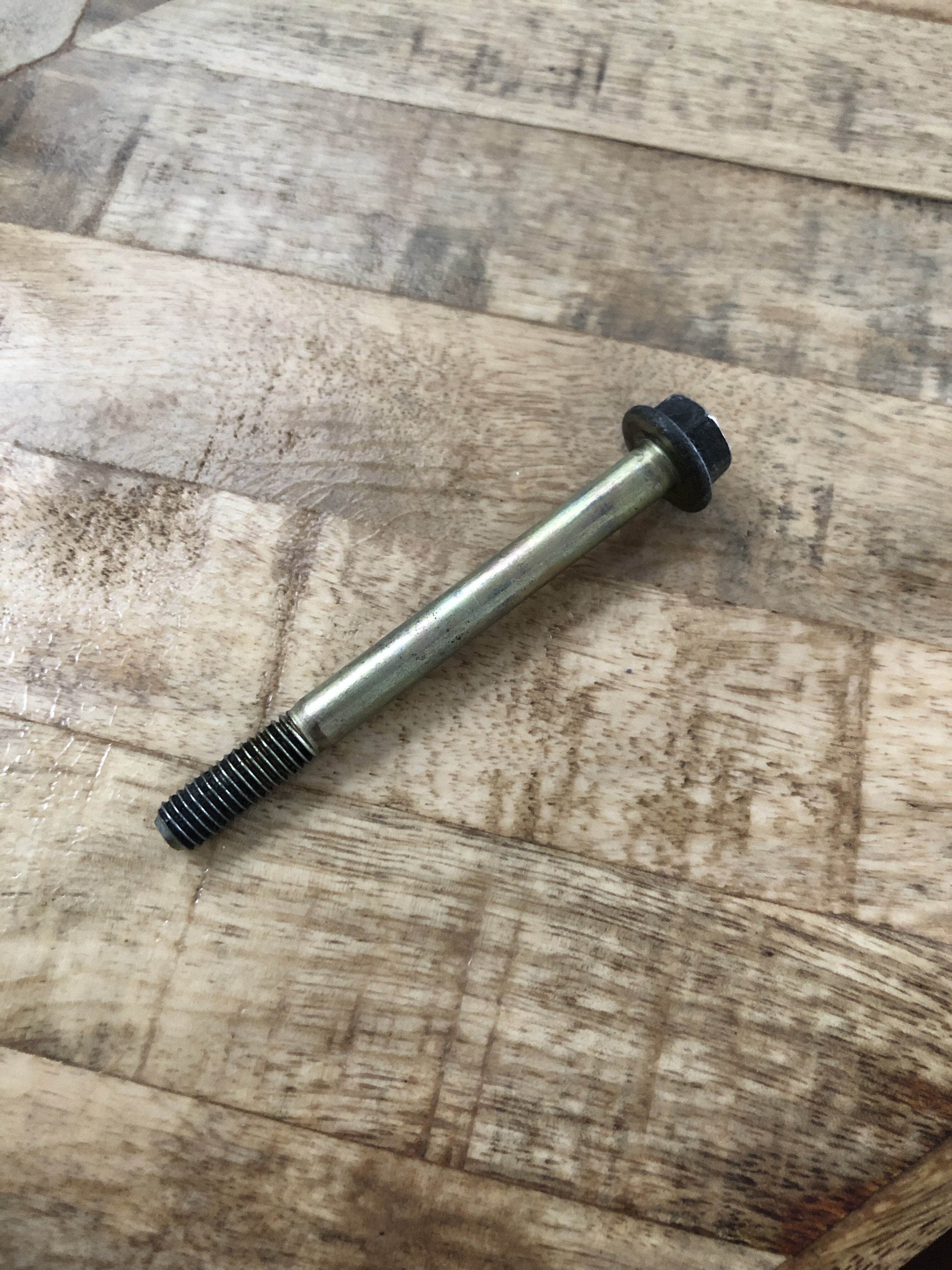

Been in the bay all morning and nothing looks out of the ordinary. However, i have just found this sitting on the floor of the engine tucked away.
this is not a part i supplied and looks like a timing bolt?

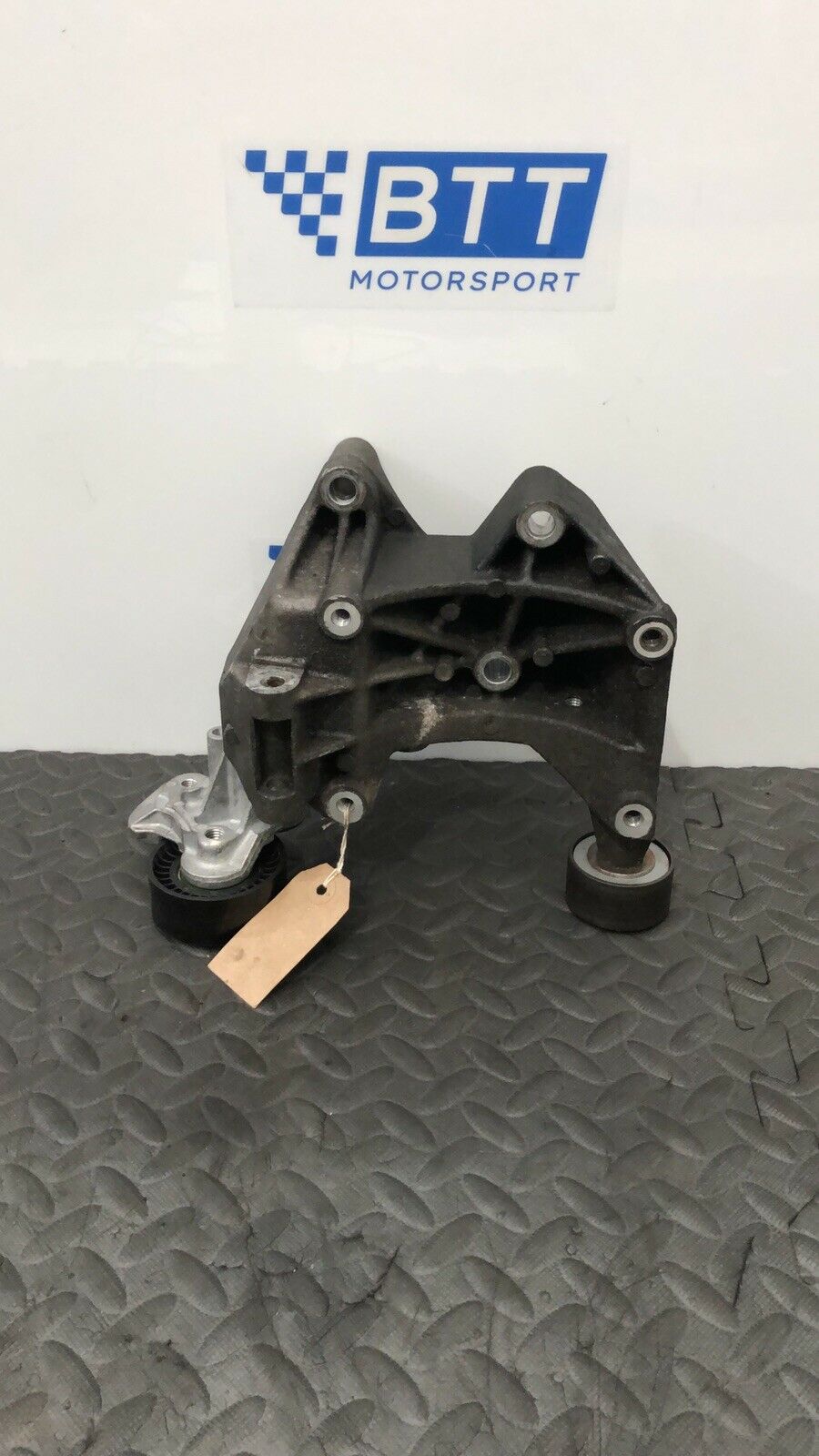

After a lot of reading and researching the bolt looks to have come from the air conditioner compressor mount. There are 2 and this one has come away.
Part 7703002190 SCRWEW M10X150-65
I have a few questions if anyone can help:
1. Would any work regarding a/c leak test/re gas and or cam/aux/water pump change require both bolts and the compressor mount to be accessed/removed?
2. With only 1 bolt in place, does anyone know or have had experience of belt issues or knocking noise due to this before? This mount looks to hold 2 pulleys as in the picture and if only one bolt in place could the mount have slipped which in turn has also caused the a/c to fail?
Appreciate its a long shot, but the work carried out was all centralised around the cambelt, aux and dephaser + water pump change along with a/c check and re gas and to have this rouge bolt floating about points me in the direction of potentially garage's fault here.

I can't see how there's room for a bolt that long to randomly fall out, especially so close to work in that area having recently been done 🤔. I'd say the garage are at fault here.
Without having much to scale from, i'm taking a complete guess here. It looks like the bolt is either one of the lower inlet plenum to cylinder head fixings fixings (Timing case side) OR more likely, it's the fixing which holds the alternator upper restraint bracket to the cylinder head and goes thru the lower inlet plenum (These are common for getting stripped from over tightening and do fall out).
  Clio 182
Hi MicKPM. Appreciate the reply. Fairly sure ita not the alternator. All bolts appear present. Where is the lower inker plenum bolt to cylinder located. I am stripping the bumper/splash etc on Sunday. This would be good to look for then? Thanks in advance.
