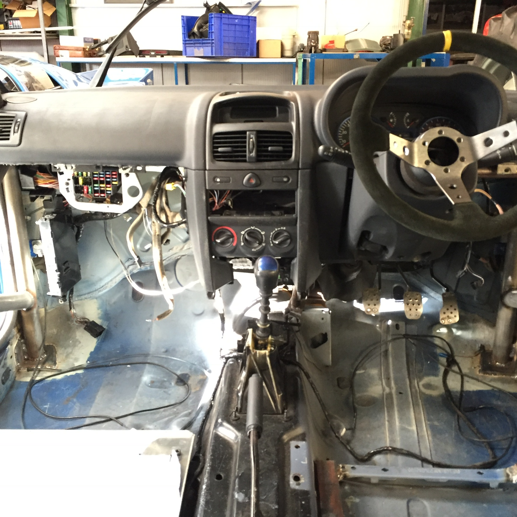

Check @Tomotek build thread. Rerouted the bulkhead connector into the space where the OEM heater sat and re-wired up the UCH and fuse box as well. Awesome work
Old photo so it has been tidied up now however you can see it here on the left
