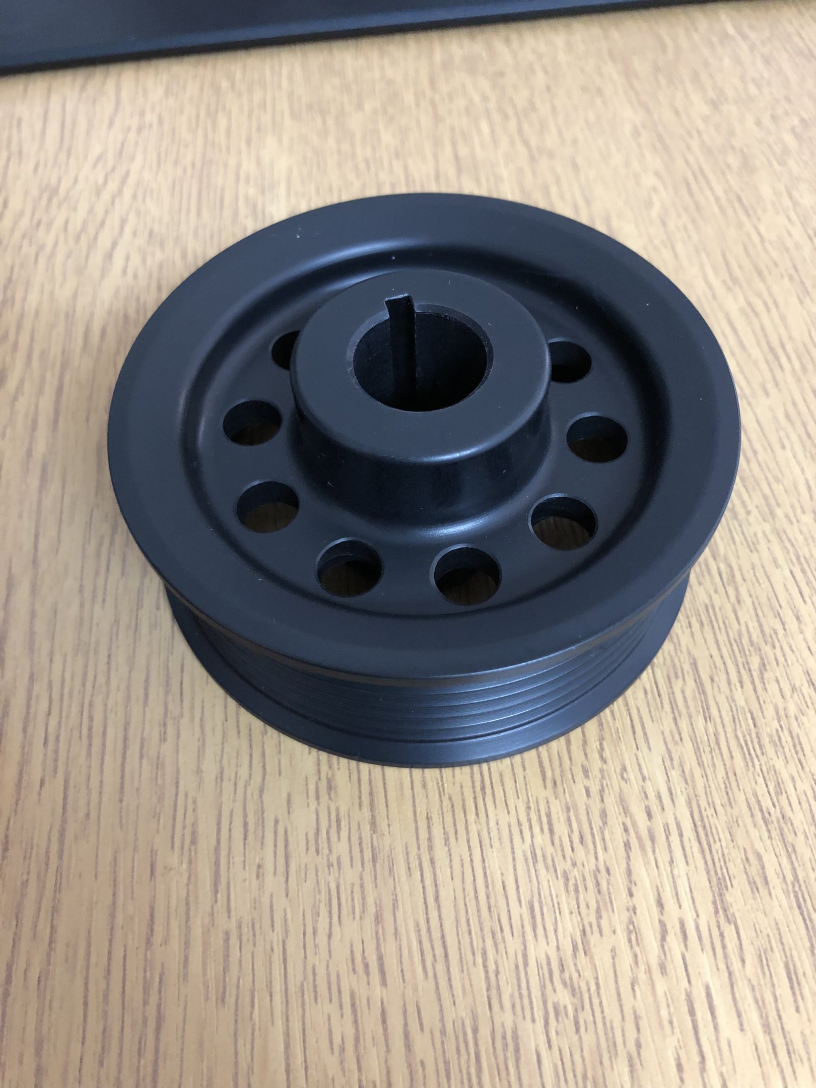

I could hang £3k worth of TVS off the side, get someone to fab me up an intake manifold for another 1k, and spend hours stratching my head on where the hell the belt would go and still bend the rods with slightly colder 12psi air.
Regardless of spend on the charger, I'm doing this on a bone stock 121k mile MZR 2.0, it'll put a leg out of bed, so I may as well do something different while blowing it up.

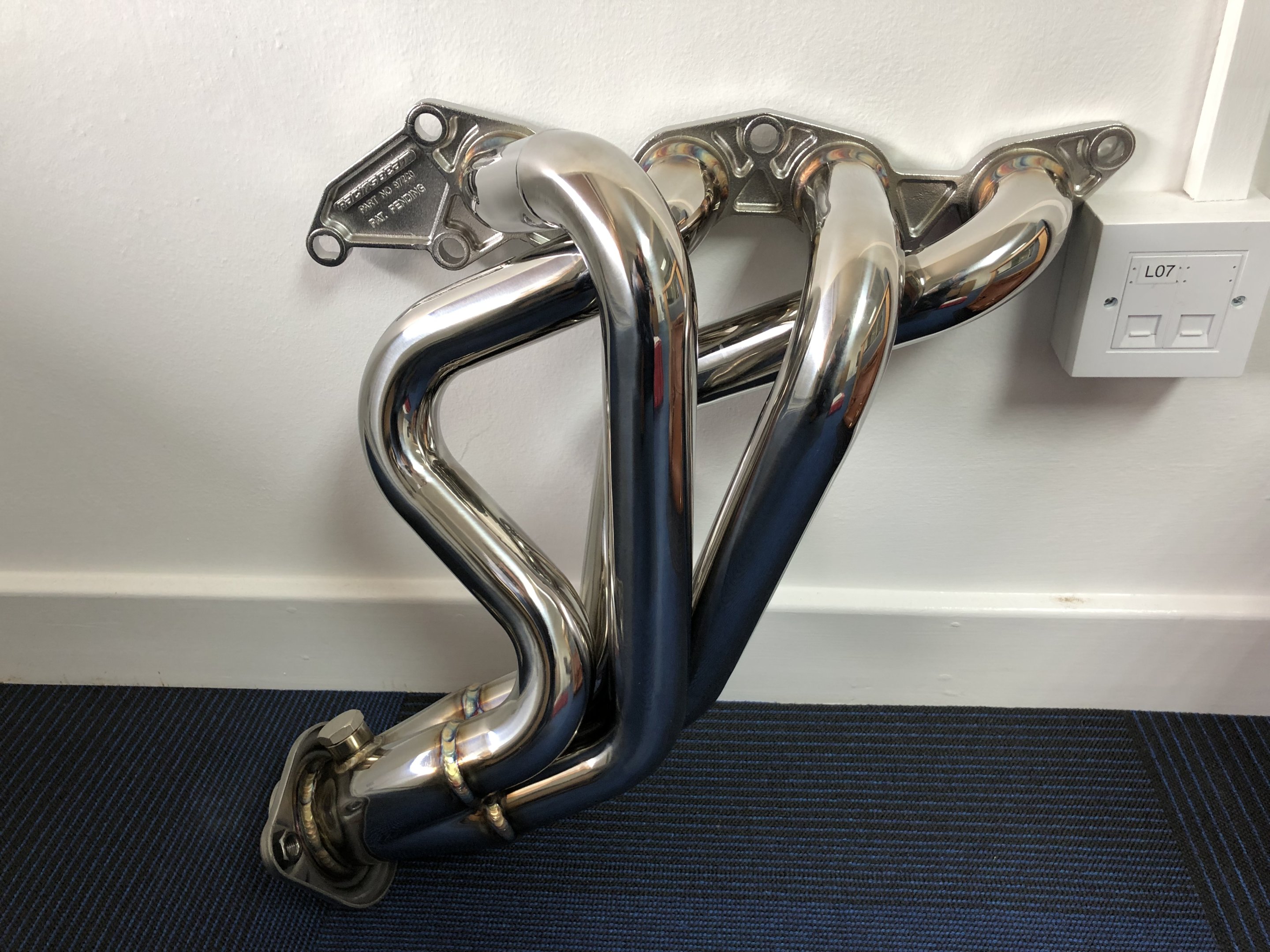

Racing beat manifold. Good bit of kit for £450.
Quote for a custom on to the same specs was £1000.

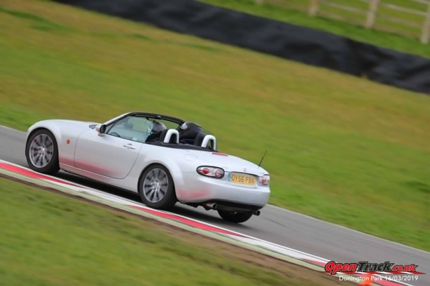

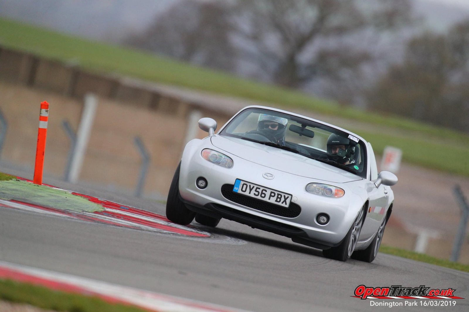

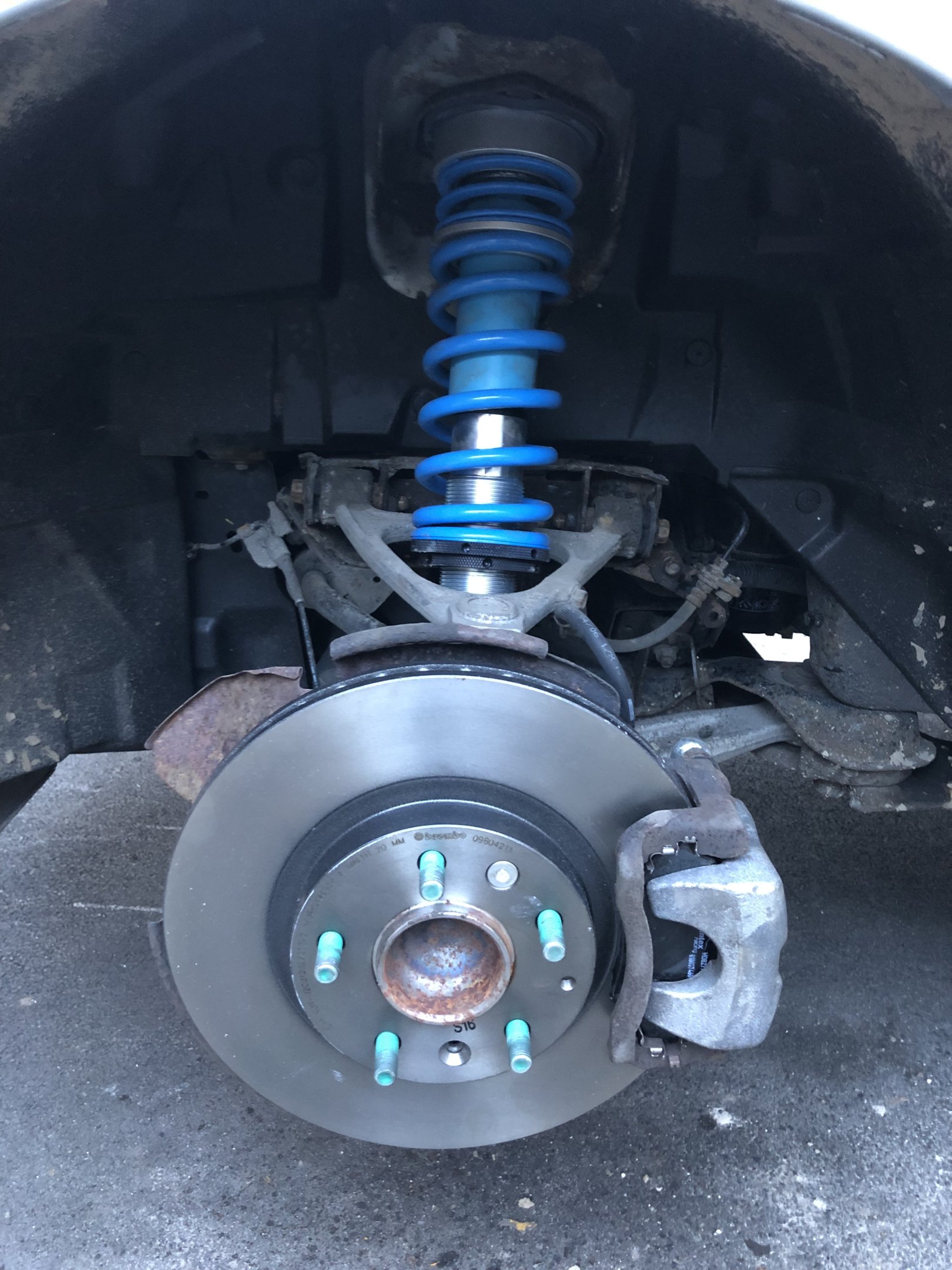

New brakes all round now and some new PS4’s fitted.
Donnington on Saturday, it’s going to take an age to get around with 150bhp....
Be interesting to see how you get on... Mine felt reasonably quick, by my standards at least. There wasn't much catching me and I was having a good battle with a Mini Challenge race car. Hopefully yours impresses you.
It’s f**king awesome.
So so so slow but awesome at maintaining corner speed.
1:32 on Donny National with road tyres and 150bhp isn’t to be sniffed at!
I think, after using it now, it needs a 2.5 conversion with around 230bhp and it’ll be perfect.
Yeah I think I was doing 1:28/1:29's from what I remember, but maybe the exhaust and Ohlins made the difference as I was on s**t tyres.
I'm considering another for sprinting this year, along with 7168 other cars.
1:29.1 now. Has a bit more in it but getting a clear run is impossible.
Sit rep:
Car survived just fine. Only taken 0.8mm off the PS4’s in 84 laps!!
It needs 100bhp more to be interesting, at the moment even with road tyres, it’s break, turn, full throttle, turn more, go round corner with no drama. There’s no fun in that!
M1166 pads just never stop giving either, well impressed with those as most give them a bad rep. The new discs are completely blue, so they’ve been taking some hammering. I’ll await the photos.
End of the day it POURED down and it was only 6 secs slower and still pulling 1g through Craners.
Peak G of the day through there was 1.3, which is mental for a road tyre!
