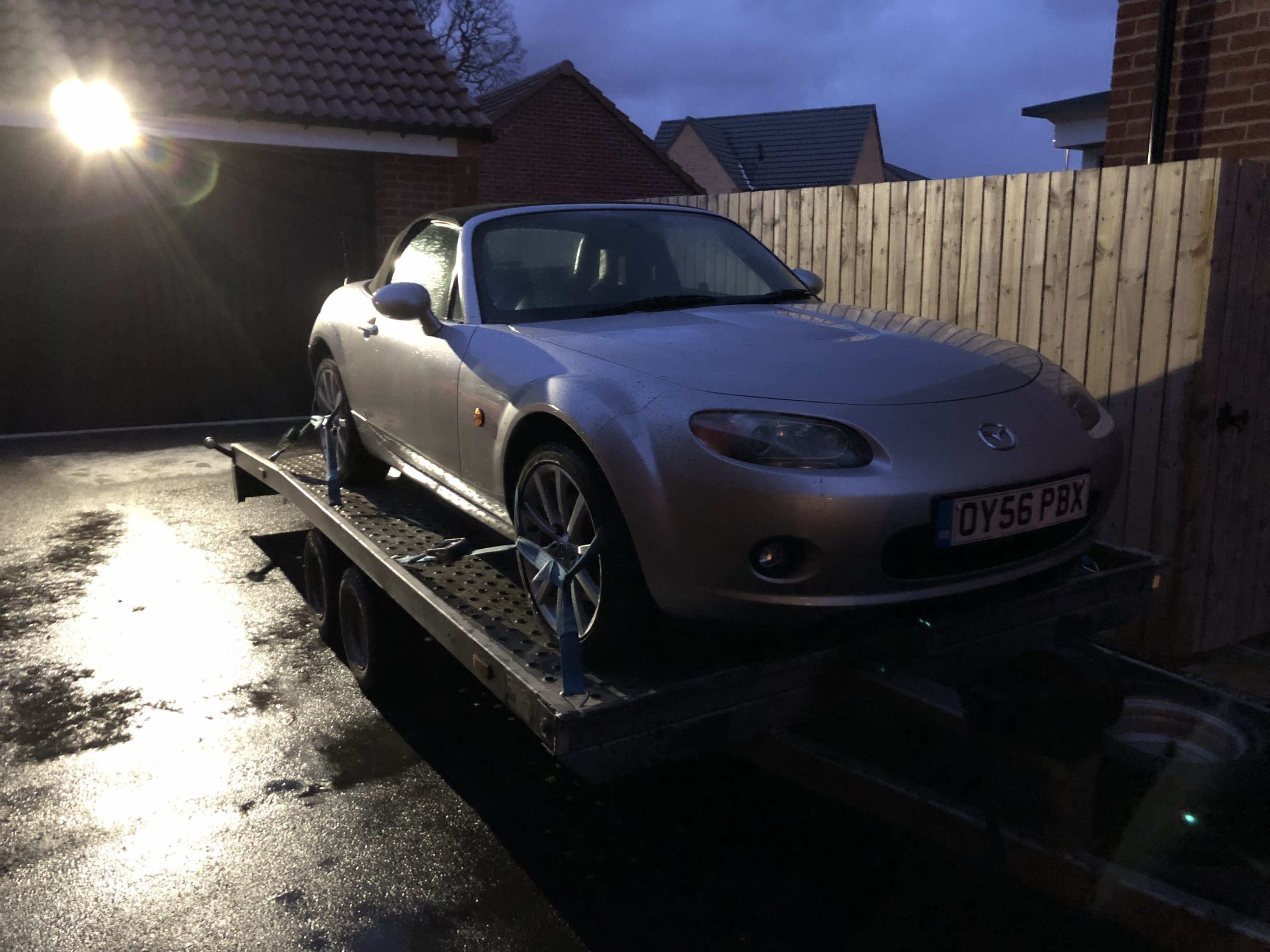

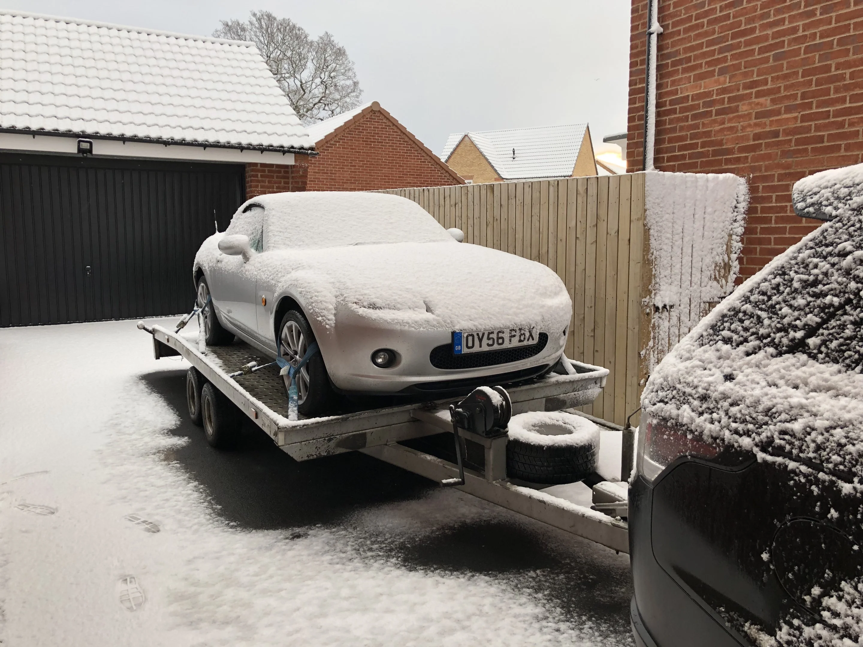

And I bought the cheapest one (sub £2k).... Bought in the dark without even starting it, just winched it on the trailer...

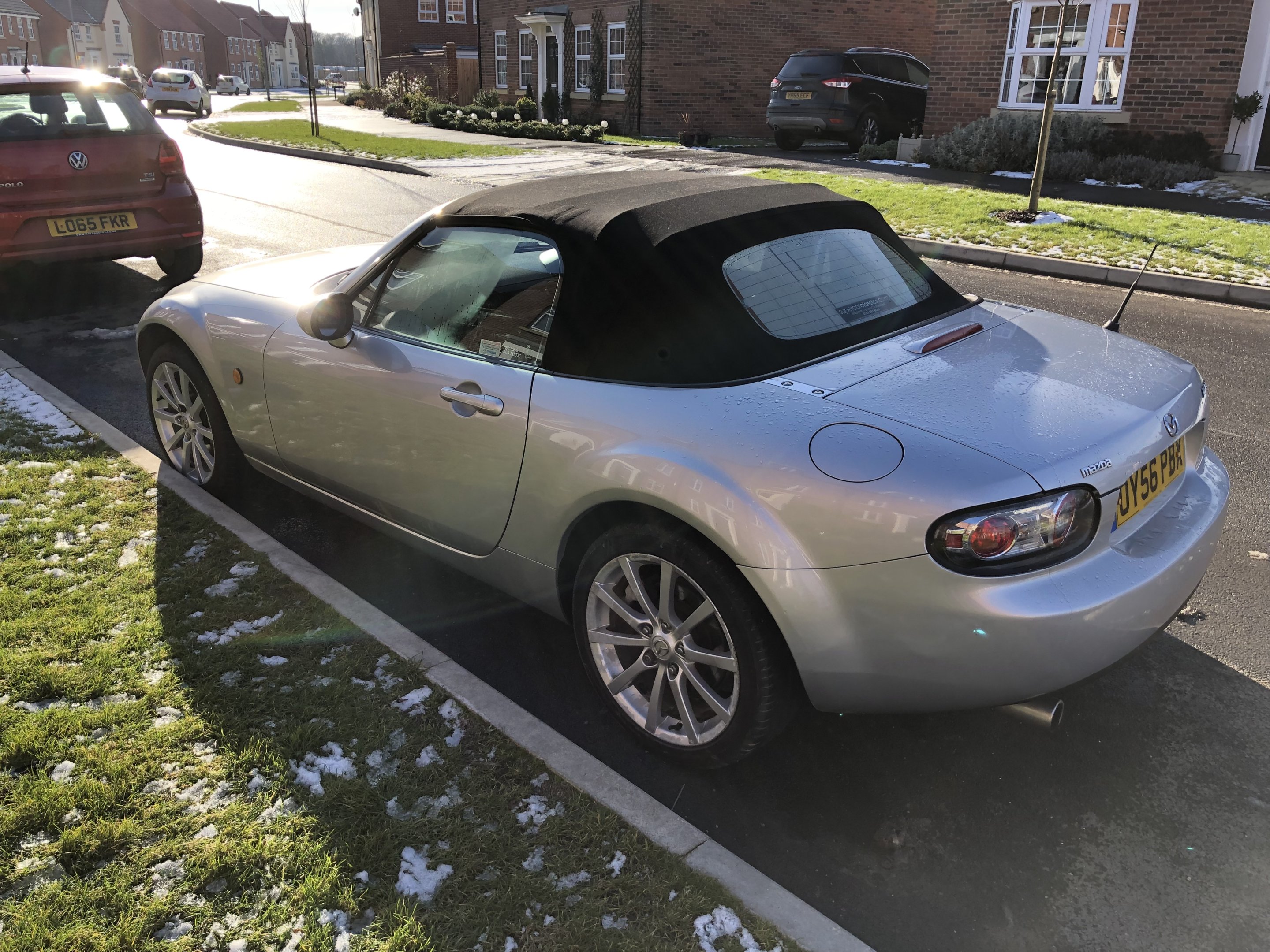

Here she is.

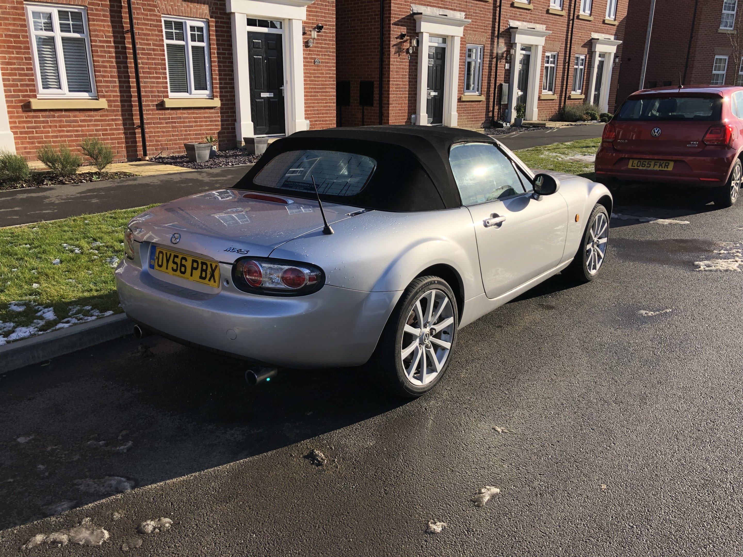

So because it’s the UK, I woke up the next morning to snow...

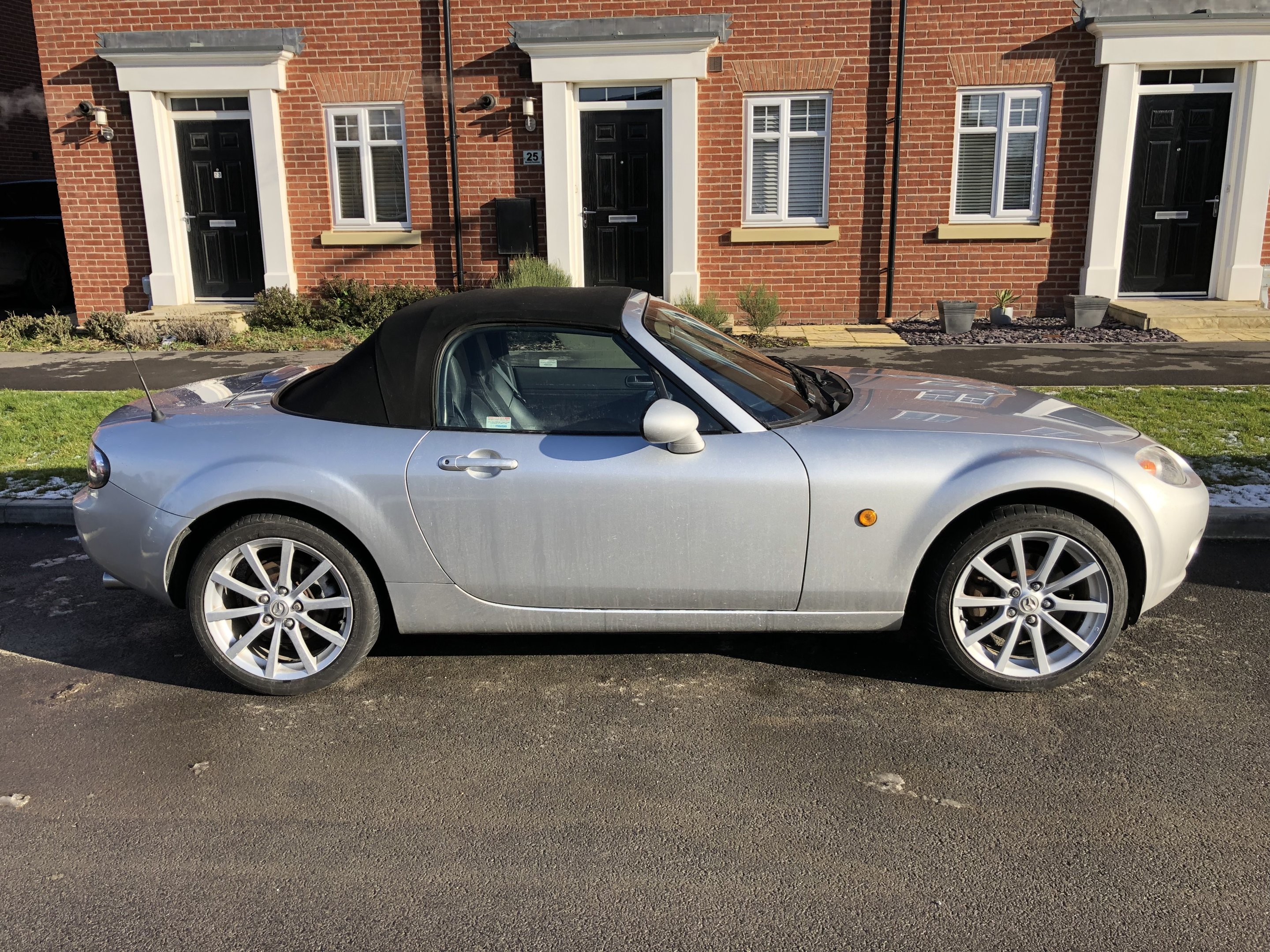

Gave it a wash, pumped the tyres up to over 12psi and took it for a drive....

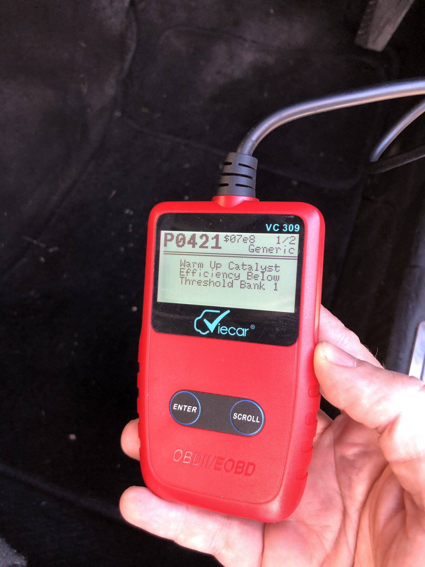

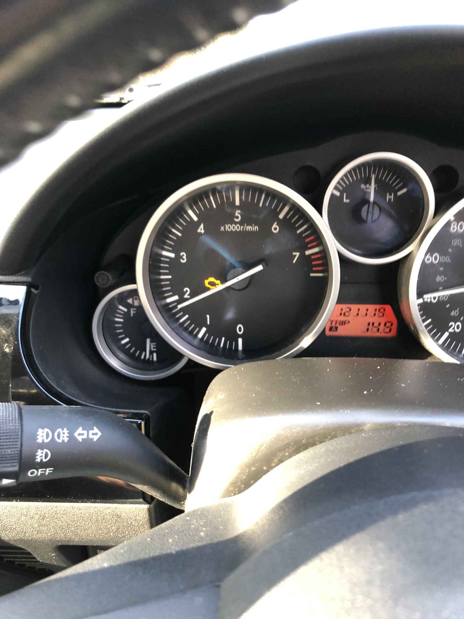

Surprise surprise! It’s broken. Other than that it drove ok.
Needs a new O2 sensor. No biggie.
Overall it’s not in bad nick. Some surface rust, the interior smells. All the brakes are new, wheels are hella curbed, the roof is water tight.

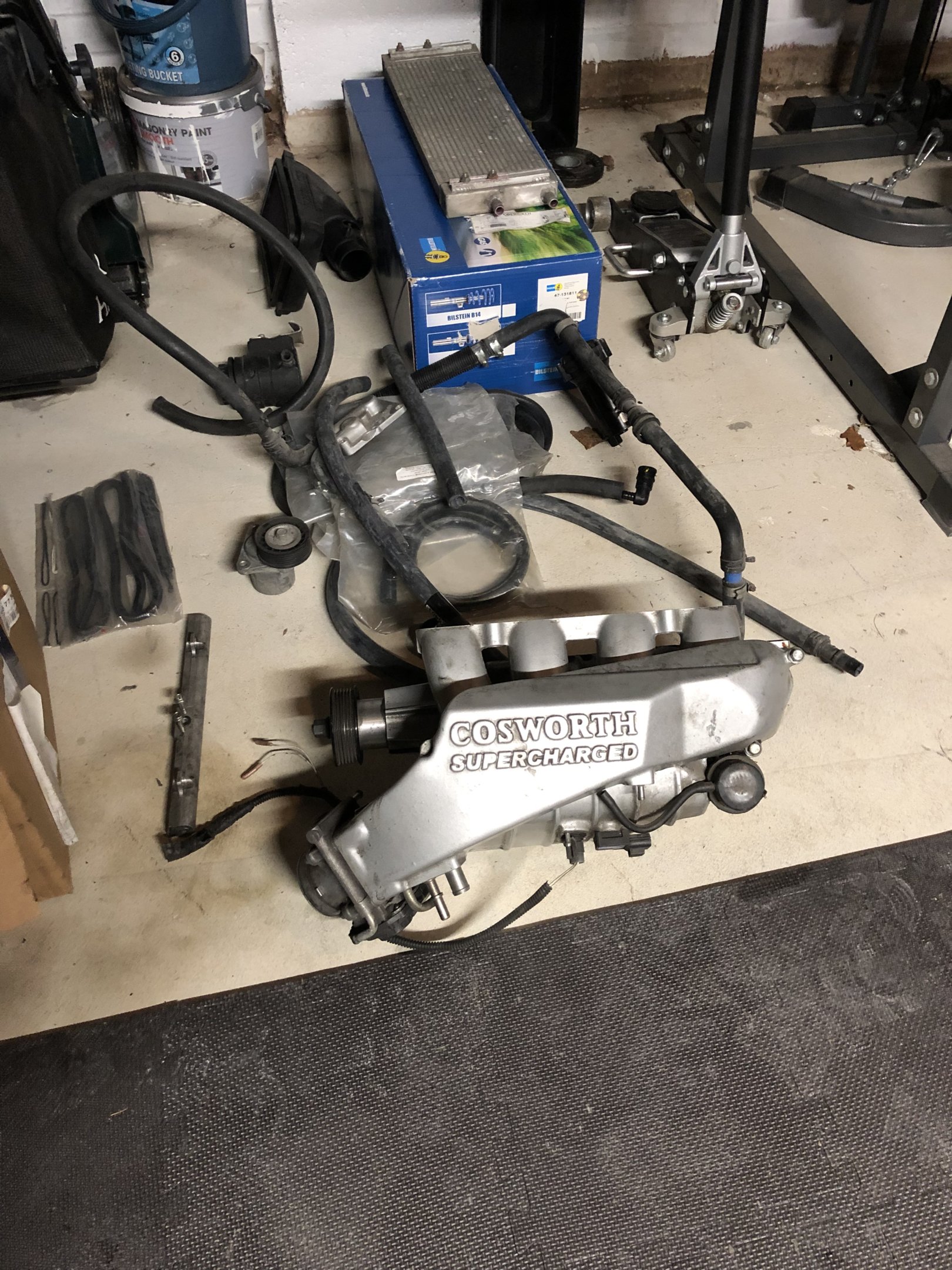

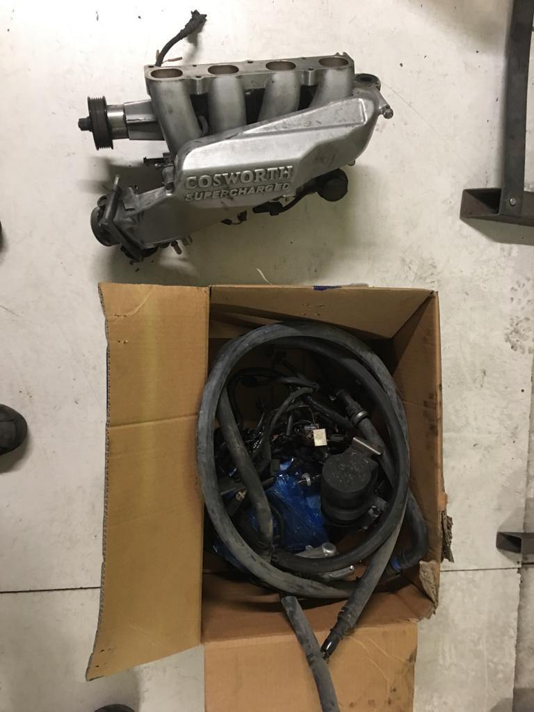

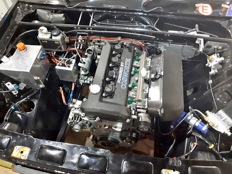

Bolt this to it and blow it up...
Full Cosworth designed supercharger kit, these killed loads of engines back in the day, so much so, Cosworth stopped selling the kit. Lately it was found that it was a oversight in the mapping which caused all the issues!

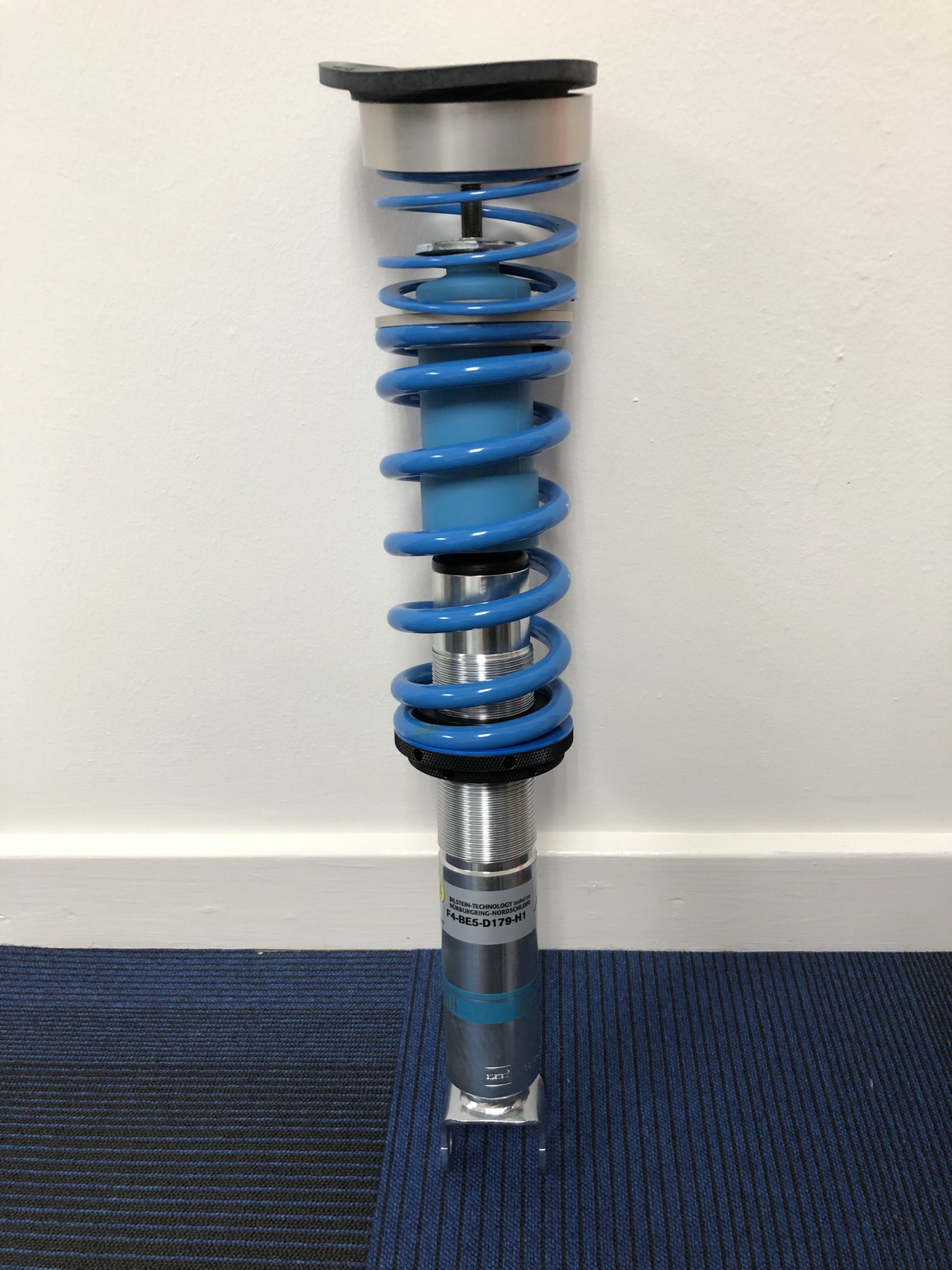

Bought some ex display B14 PSS coil overs for £500 this eve.
And the modding starts.
As a side note, I drove it to the supermarket this aft, it’s actually a good car!
Gearbox and diff need some fresh oil but other than that it’s pretty good.

I was going to convert this to an electric pump before I found the charger. Now it makes more sense to keep the pump since it's on the belt routing I'll be using.
