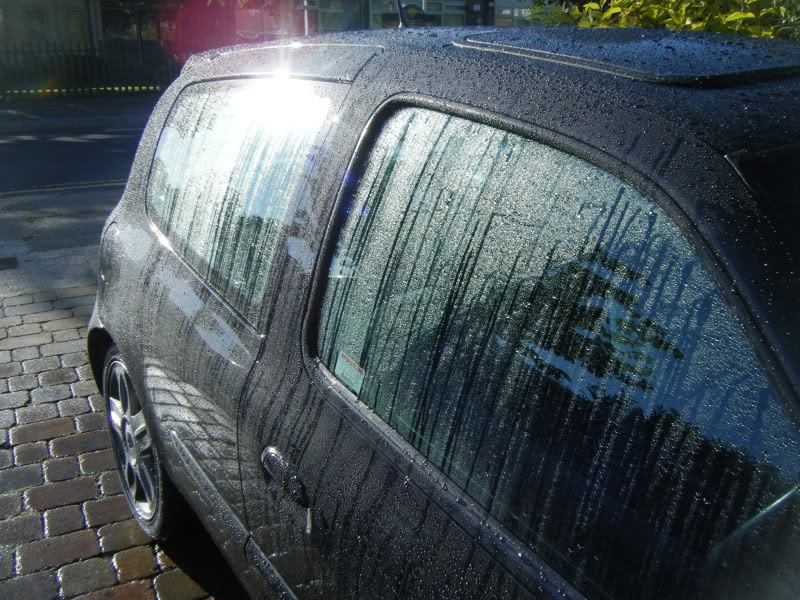

I used G4 polish to clean all the windows then 3 coats of G1 on the front and rear and a single coat on the side windows.
Layering time is 10 mins, after the final coat a 15 min wait, Then use the residue remover to remove the excess and buff with a cloth.. However im experiencing a bit of hazing,I think more residue remover is needed, Im asking over Detailing World...
Still, Im very impressed, Just for once want the sun to fack off so it can rain.

Just had some rain today, Works amazingly, Water just slides off,
Had a bit of trouble with excess haze but was solved with IPA and buffing... More my fault due to not knowing how much "excess" to take off... Which i now know once the stuff has cured you can buff and buff with residue remover and the effects wont be lost.
