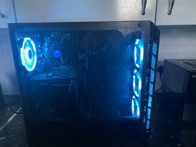

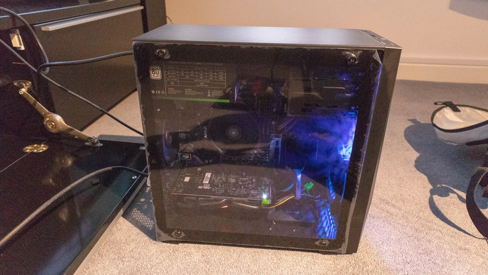

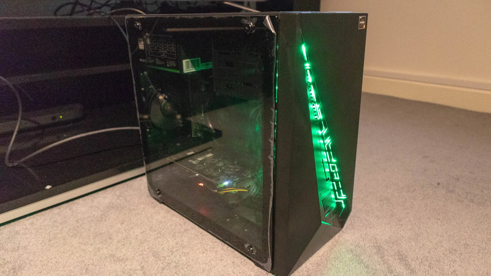

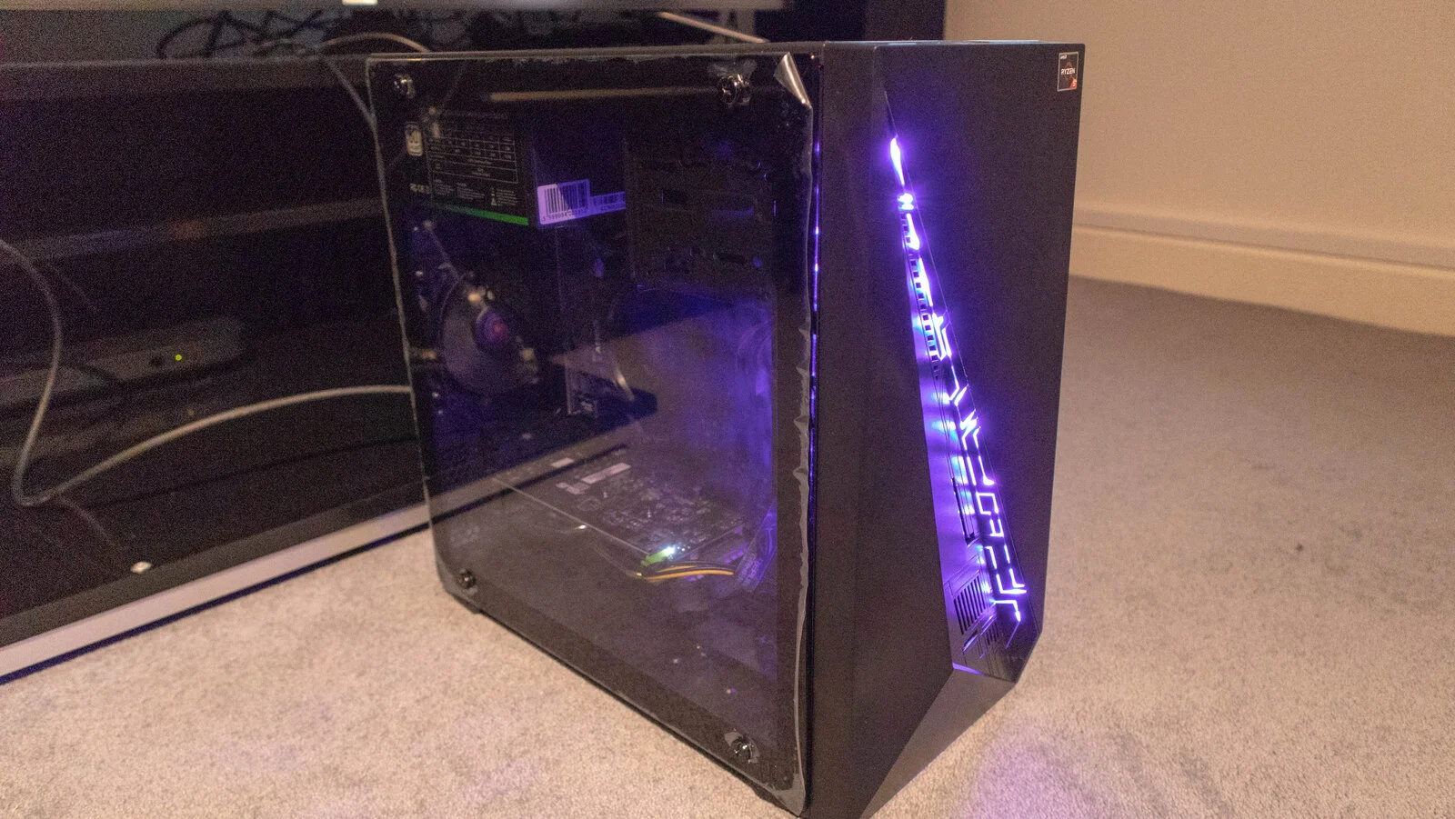

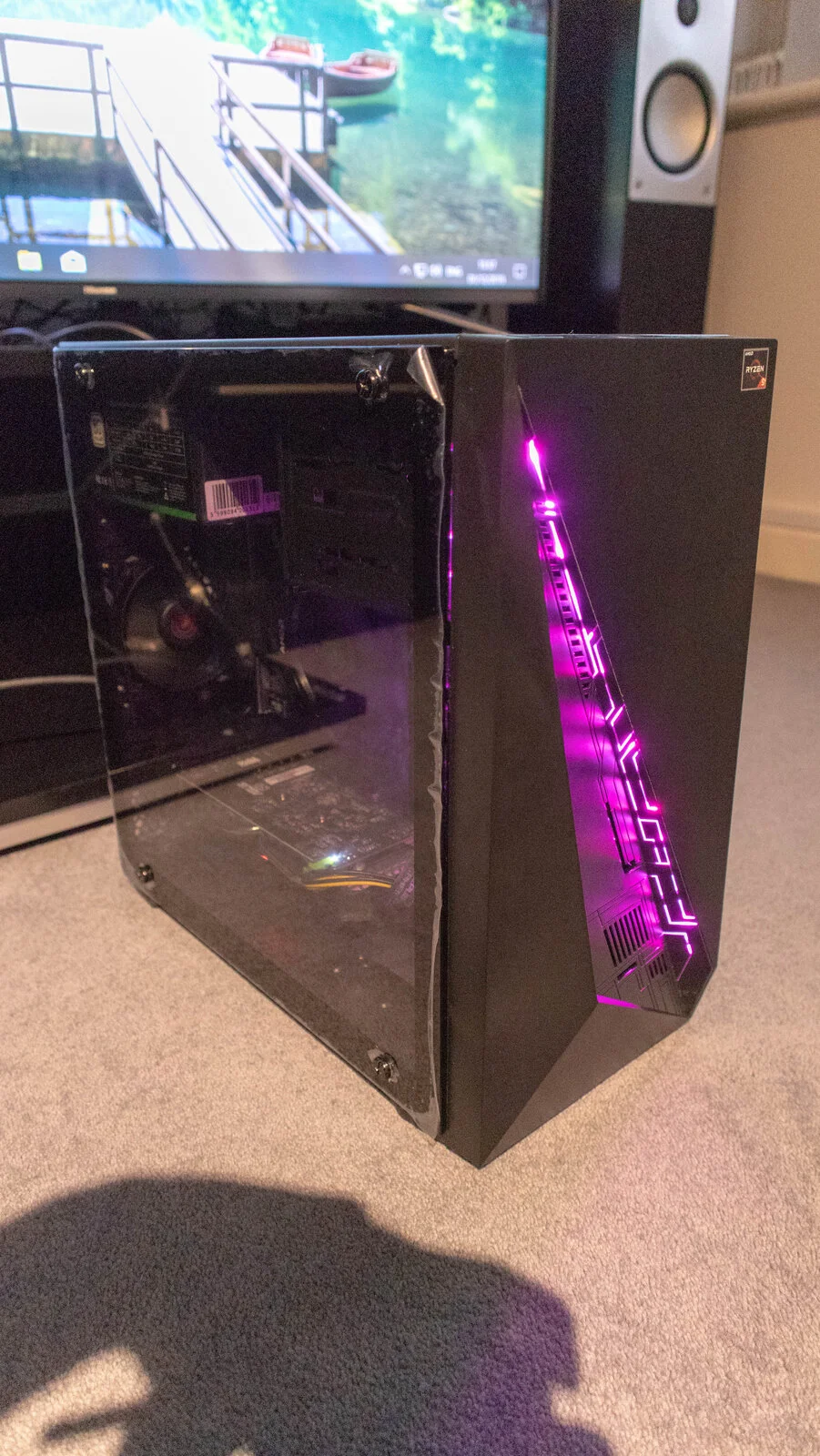

I've actually just thrown an advert for a custom one I've built else where seconds ago, I'll just paste the advert. Looking for £599
Brand new custom built gaming pc, perfect for full HD gaming. SSD installed for speed, system boots up from an off state in seconds.
Optional additions:
More storage
Wifi
Please ask if either are required
Specs:
RGB LED case with glass side panel
AMD Ryzen 5 2600 - 6 core processor
16gb Ram Corsair Vengeance LPX
Asus RX560 Radeon 4gb Graphics Card
240gb solid state drive
Windows 10 Home
Please note this is for the computer only, a monitor, keyboard and mouse will be required.

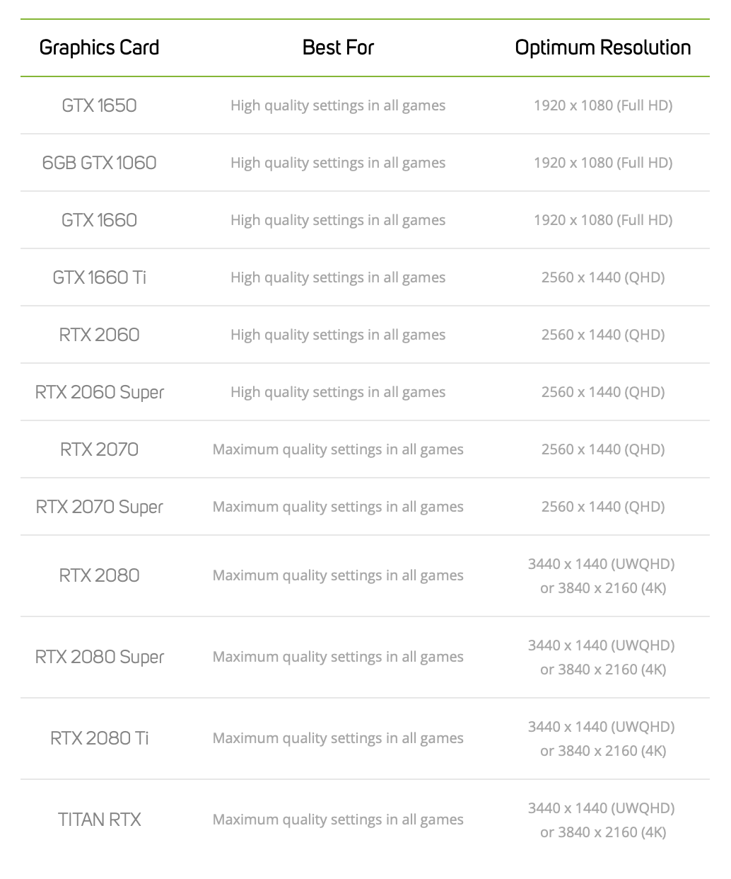

Websites like Overclockers and SCAN offer filtering based on performance etc so this should give you an idea of what you get for the money.
SCAN have a useful infographic showing what each card is ideal for and the kind of resolution you can expect.
