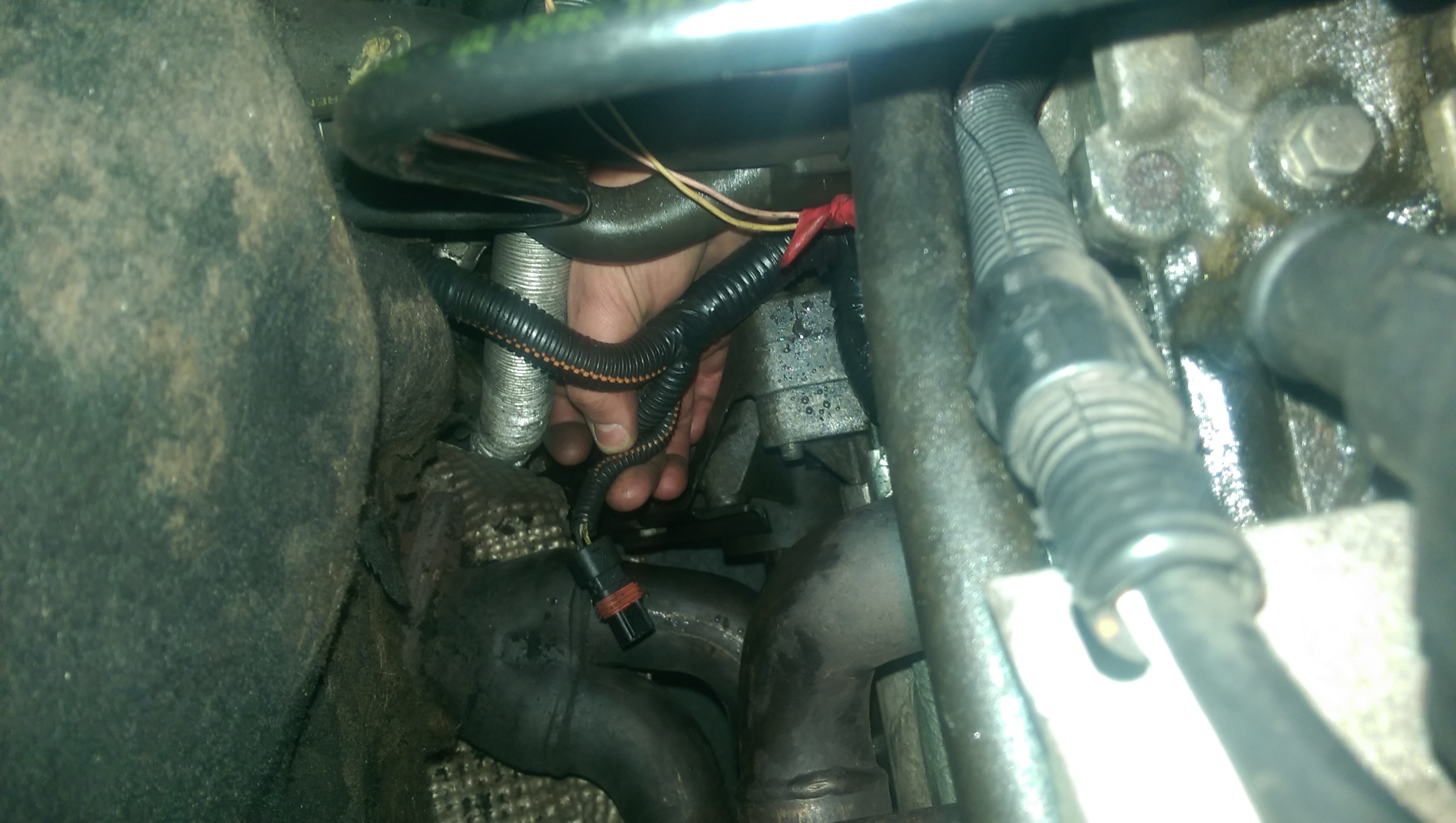

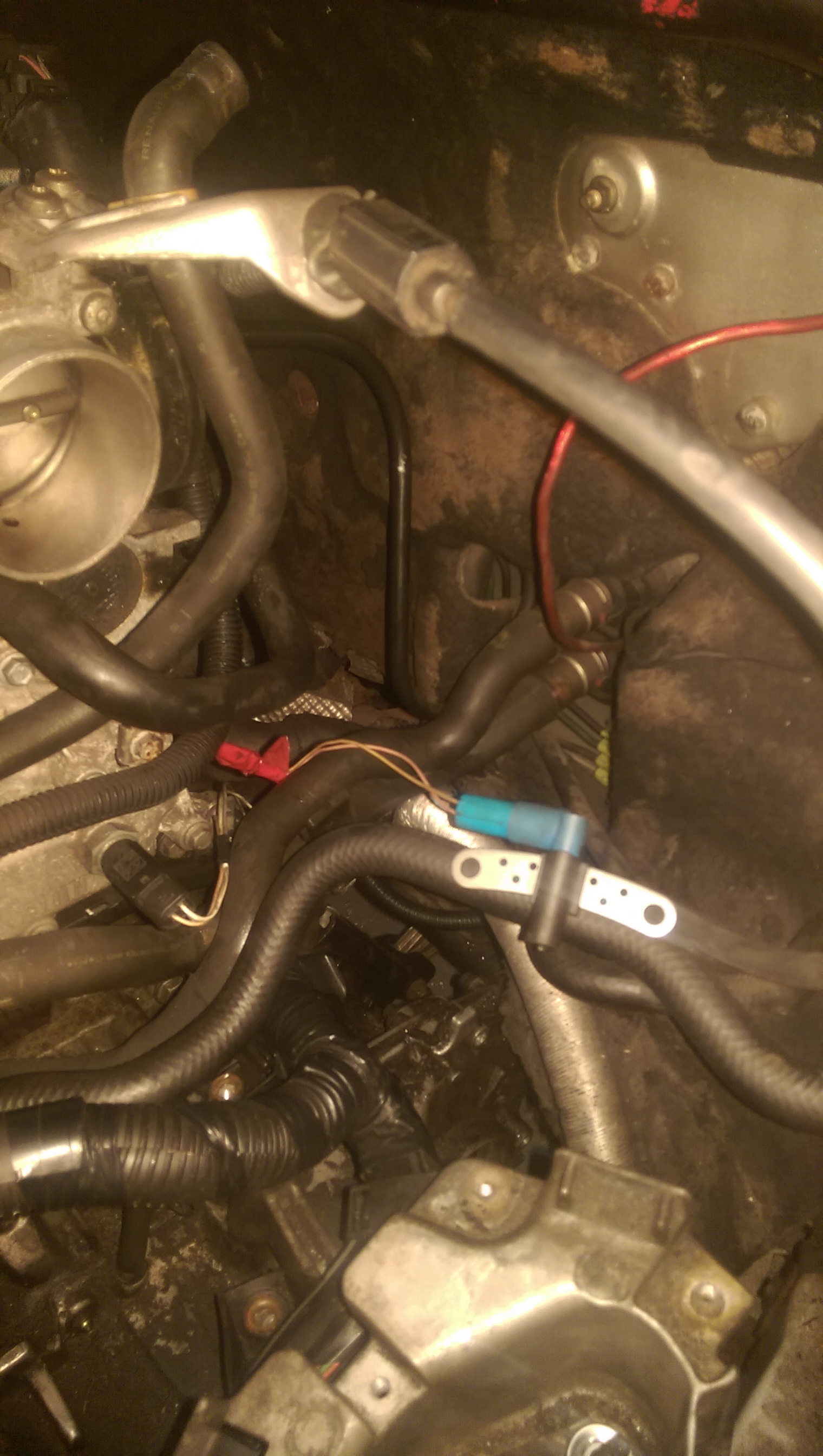

Minor Problem - Not really a problem at this stage but I have 2 wires which I can't remember where they plug into (I seem to remember one was lose and didn't plug into anything but I could be wrong). I will try and upload photos of both wires.

The 2 wires that I'm not sure where to plug them in.
