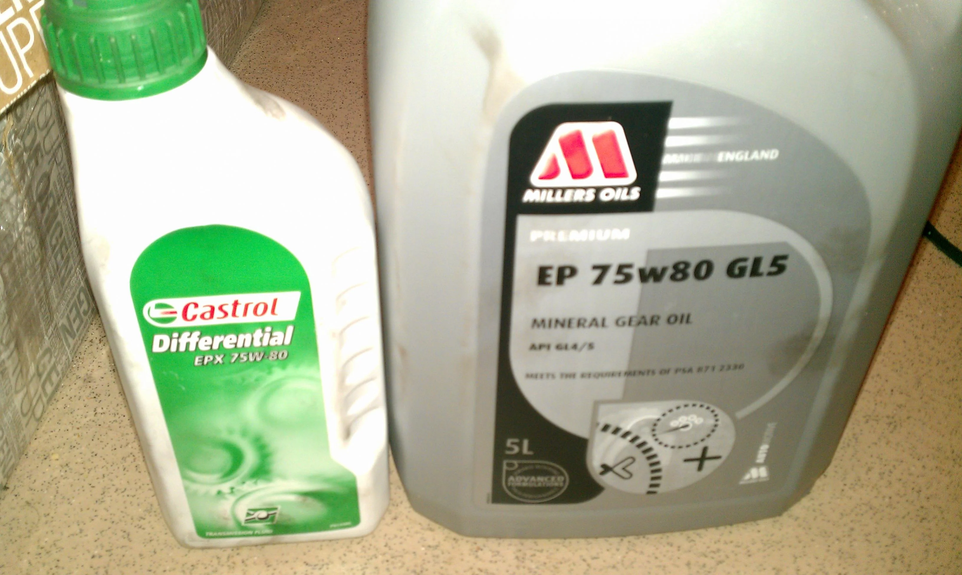

I ran castrol epx 75w80 differential oil for 2 years with no probs. At last change 6 months ago I used millers gear oil 75w80 both no probs. You can get the millers stuff from opieoils website.
