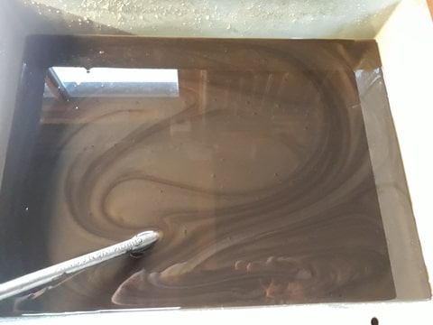

I've drained the oil, and there's definately metal in there.

I'm no expert on this, but does this indicate bearing wear? The oil is about a year and a half old, and I know that the oil didn't come out like this the last time I changed it, it was also a year and a half at that time.

Well that’s certainly not what I’d expect to see mate after that period of time, but I guess it can depend on how much work it’s had.
