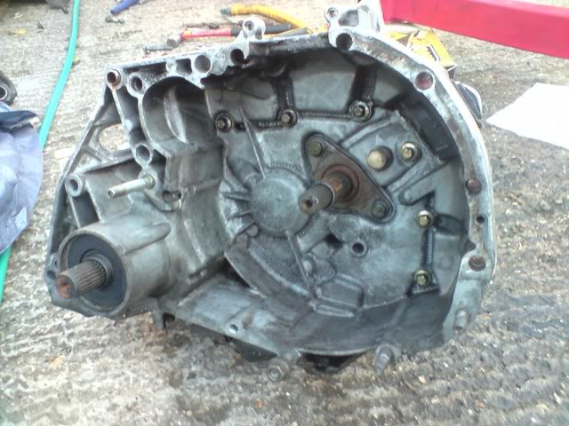

I remember inside the bellhousing on either side of the input shaft there are 2 bolts. What are these for ? The look to hold the sleeve that the clucth relaese bearing slides upon. Do the also hold the seal in place for the gearbox ?
That's the input shaft, it might have sprung a leak there, i've never seen one there but it's a possibility.
Are you sure it's gearbox oil?
taken from my thread...
those 2 bolts look like their holding the black cover on the box to me, but dont hold me on that tho.. il try and find out for you
Those are the ones im talking about.
Do you think that would have a seal behind it ? Dont quite see how oil can get in the bellhousing from there !

have you ever known a gearbox input seal to go ? does that plate around the input shaft carry a seal or just the sleeve for the CRB ?

never seen one go, but i'm sure its not unheard of, i'm not a gearbox man by trade but yes there's a few bearings and seals in there
there is a seal behind that plate, only seen them go when disturbed though. If you swapped bits about you may have unseated the seal???
Just to update.
Had a close look today and it would seem i have shot myself in the foot over this. Oil is definitely leaking from input shaft into bellhousing.
Must have disturbed the seal as danny states. "If it aint broke dont fix it". Those words are ringing around my head.
Having a local guy have a look at it for me. I have run out of time on this so feeling a bit frustrated :(
