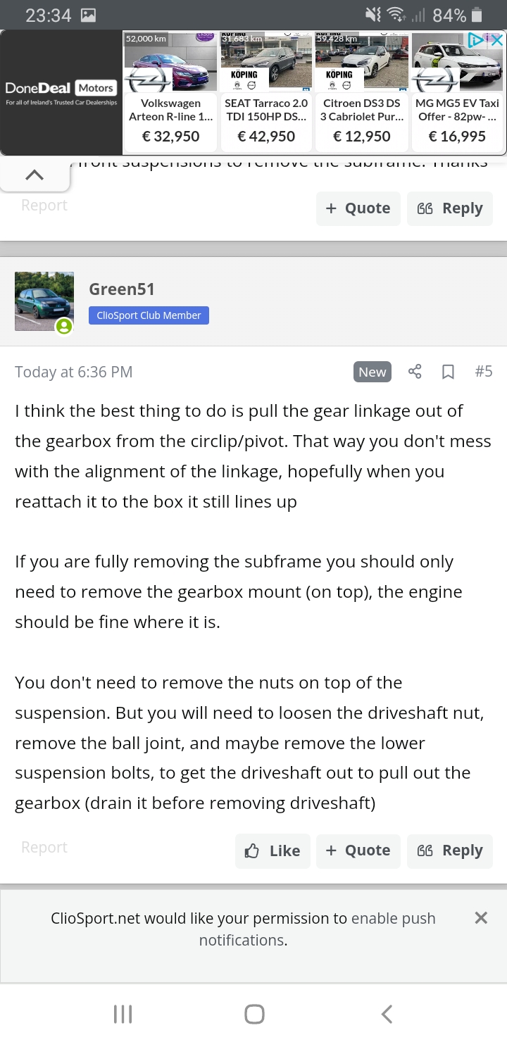

Thank you very much for all your help, much appreciated. I,m changing the gearbox, the linkage will have to be removed. I,ve read a lot more on the subject. The gear lever should be put in 5th and the gearbox linkage in fifth and the linkage then tightened. Ive included a multi page screenshot of some articles on the subject. Hope you can read them or I can attach individual pages if your interested to read them. Thanks
