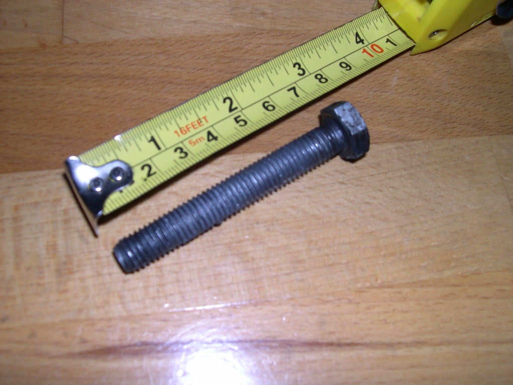

Accelerating the car quite hard up a hill, a clunk noise followed by a tinkling of something rolling along the road, and i pulled over as car didnt seem right.
I walked the road and found a long bolt about 7cms long on the road. Not sure if i went over it, or it came off the car.
The car doesnt drive right, and when pulling away in gear it feels like the gearbox jerks/clunks quite sharply, as the torque kicks in

Bolt doesnt look broken. Looks like it just come undone and fallen off. thats if its my bolt

Bolt head is 15mm hex, might not be my bolt. seems strange as it was in middle of road, back tho
  330i. E30 Touring.
Nothing in that area is a 15mm. Always a chance someone could have replaced the original 16mm's with one of these though.

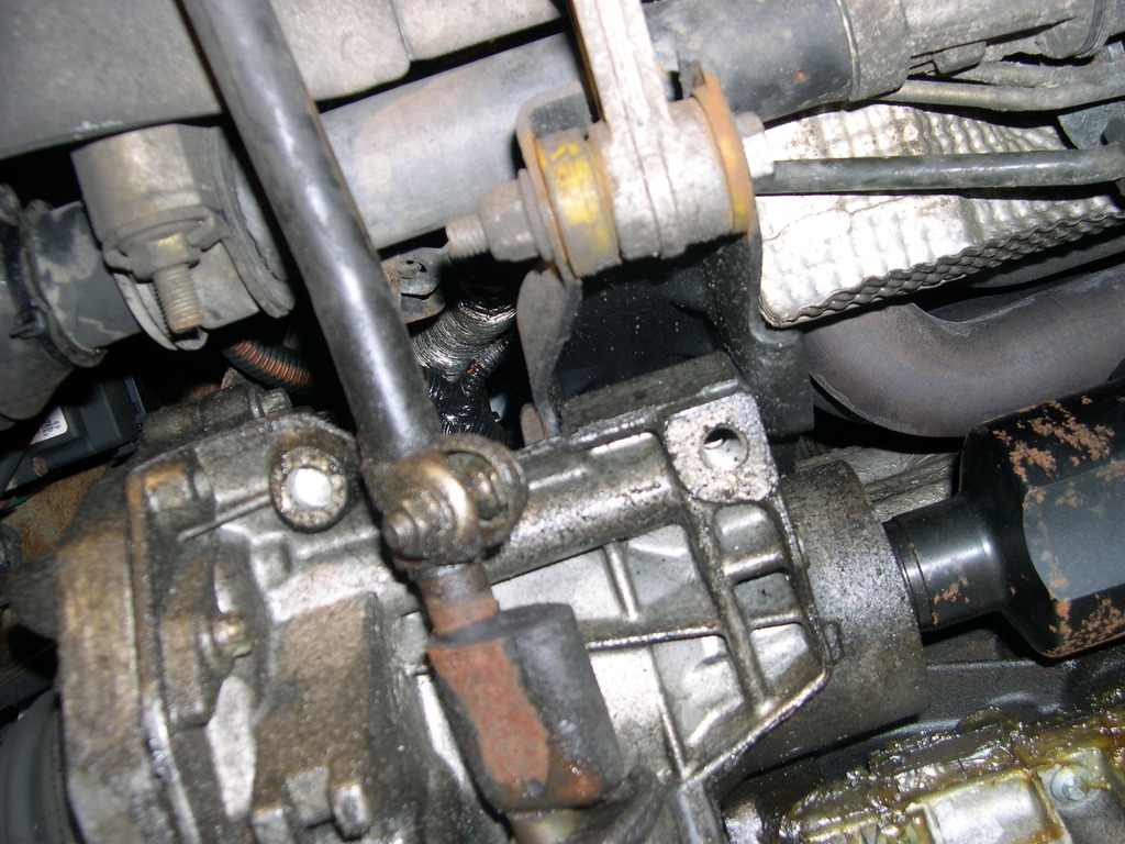

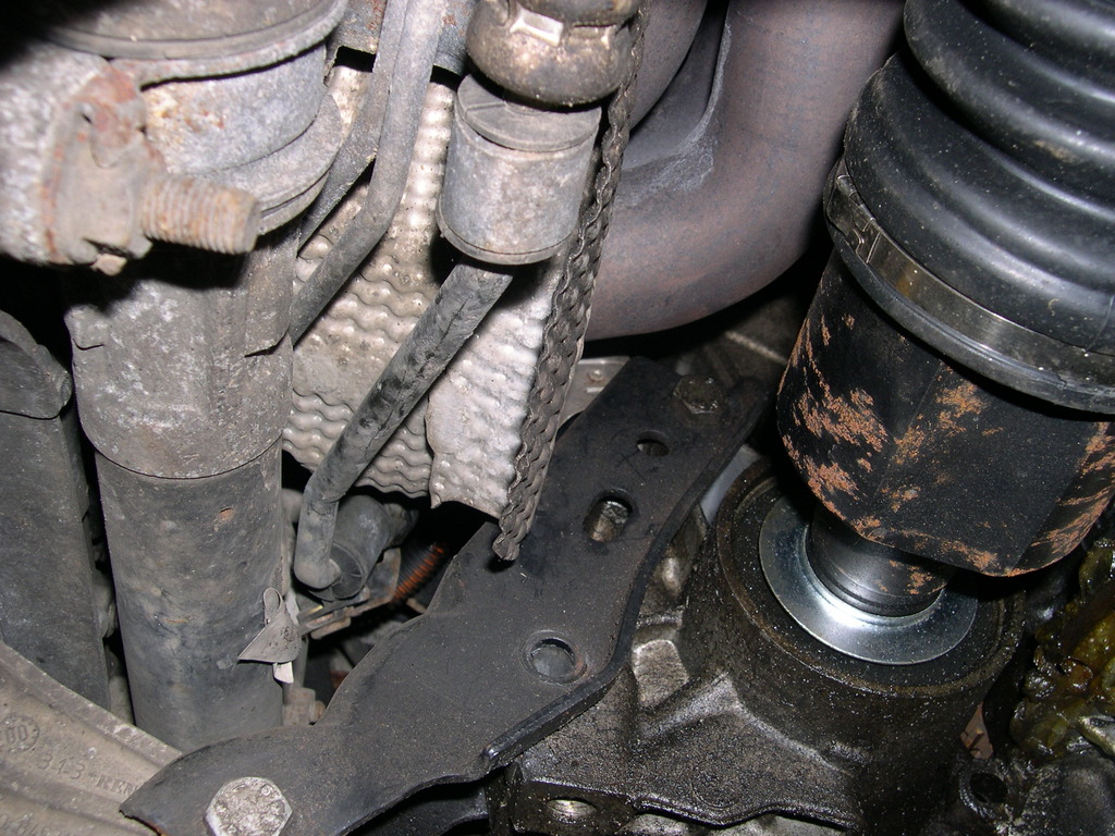

Got car up on axles stands, having a look around
In these photos, just in front of the dogbone (Yellow bushes) there is quite a shiny threaded hole.... would that be where the bolt come form? Shall i just screw it back in... any advice
cant see anything else hanging down, or out of place.
ED: its close to the drivers side drive shaft that was replaced couple months back. Wonder if its something they didnt tighten up>

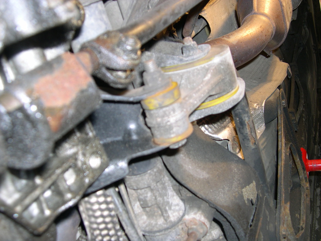

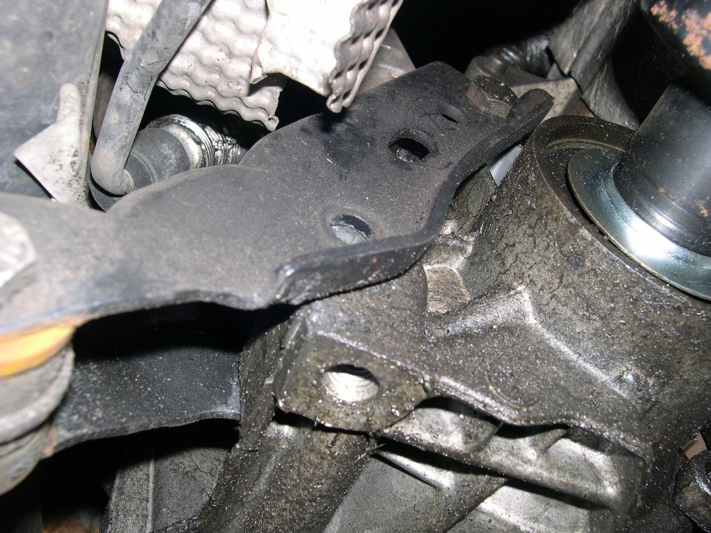

This photo its a bit more clear- can paintbox circle the hole if you wish
  330i. E30 Touring.
The black bracket the dogbone bolts to at the gearbox end should have 2x bolts holding it on.. I can see one of them, check the other is still there...

they shouldn't of needed to touch anything engine mount related, or anything inboard of the hub really for a drivers side shaft change
the bolt does look a bit like one of the ones that holds the black bracket to the gearbox, but never heard of one of those working loose before

Garage just phoned to say an engine bolt come out, and its the one i gave them
