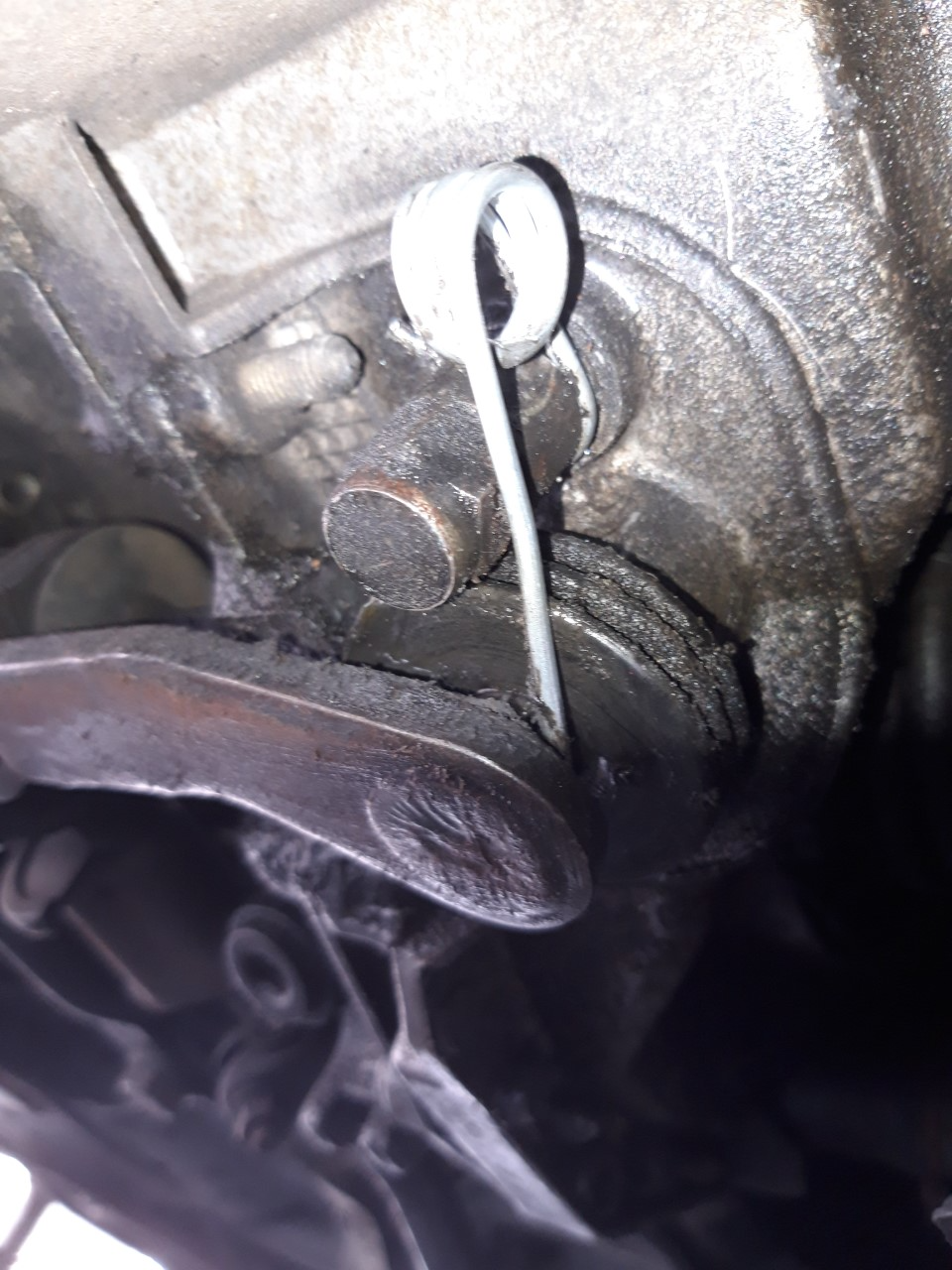

From your description, this selector spring may have failed from wear.
