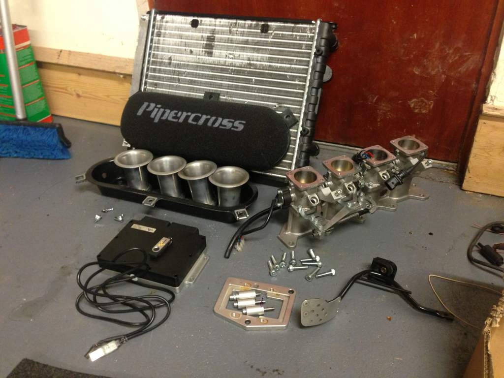

We were called by a lady asking for a pedal mounting bracket and engine mount support from our throttle body kit, which had been purchased second hand.
We have four members of staff who pick up the phone on the mail order side, some more experienced than others in this type of product.
As with a lot of the finer detailed products, I was asked about this and sought to try and check that the kit was in fact one of our DTH kits, as if it was removed from a car complete, the engine support block should have been present, if indeed that it what we were being asked for.
One of our team was phoned by the guy fitting the kit who confirmed that the pedal mounting.
The lady phoned again, asking for the same parts and wishing to pay for them.
I picked up the phone on this occasion and asked for confirmation, pictorially being the best option, that in fact the kit was one of ours and I could then see what she was looking for. She herself admitting that she did not know the first thing about cars and had been asked to call on her partners request.
OK, this happens a fair amount and for things like brake kits, springs or air filters, we can muddle through with reg numbers etc to make sure the customer gets the correct product, an ITB kit however is not the same thing.
This being the case I asked for the following:
What has the kit come from, i.e. Phase 1 172? Phase 2? How old is the kit? Which ECU is with the kit? Which TPS does it have? Do you have the correct TPS adaptor to work with the wiring loom depending on the answer to the first question?
These are sensible questions to ask when trying to HELP a customer who is trying to make something that they have purchased second hand function on a new application.
I then spoke to the same lady again later in the day who insisted on paying for the parts we had not yet identified, I asked once more for confirmation of the questions I had raised. This time there was a gentleman in the back ground who as I asked a question, was then asked by the lady, who then received a response, who then passed on the information to me, this appears to be because he was too angry to talk to me on the phone.
So after a triangulated phone call, it was agreed that on Friday we would receive a picture of the goods, and here it is.
I was off on Friday, so my colleague Mat, who is our newest member of staff, received the image and the information that the kit was previously on a Phase 1 172. Clearly this is a bit of mix and match of bits from Jenvey / Pipercross / KTR etc, but at least we were getting somewhere. We also now knew that the car it was going onto was a 172 Cup. This being the case the firmware and to a certain extent software setup in the GEN90 would also need to be changed to suit a phase 2 car. Interestingly enough though, those sharp eyed amongst you will note the phase 2 DBW connector loom tucked around the back of No. 4 Cylinder pot, hummm.
So, now we knew what we were dealing with from this kit point of view, we now needed to know what else was employed on this engine as a bespoke start up cal we do charge a nominal fee for. If it is an off the shelf application such as an otherwise standard engine, we do not. As of yet I am not aware we have received this information as Andy is on holiday today but will return to work tomorrow.
