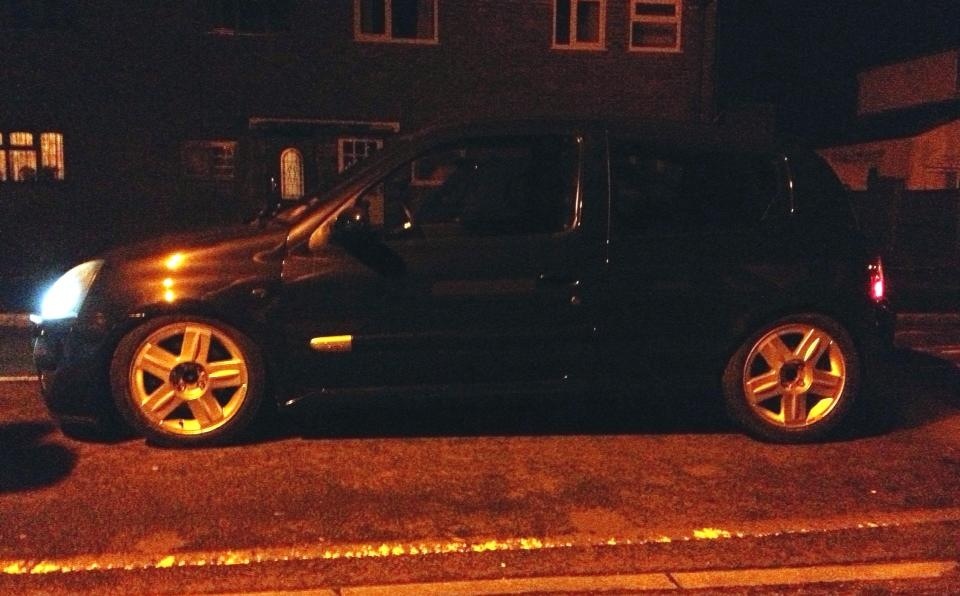

Heres a quick piccy of how low its sat atm
Not a very good pic

Yeah a bit low lol. My advice for what it's worth is take it to a good garage to be set up properly, not saying you can't do it but you would be surprised a few quid spent can do

Have you made that lower than what I sent them to you?
Surprised the wheel turns? You use be rubbing on the bumper brackets.
Not many places will be about to do a geo setup on a car that low. Needs to come up 30-50mm.

Thats as i got them sent danny lol ,going to raise it up in the morning. It scrubs like made. I drove it twenty foot and had to stick it back on the drive haha
