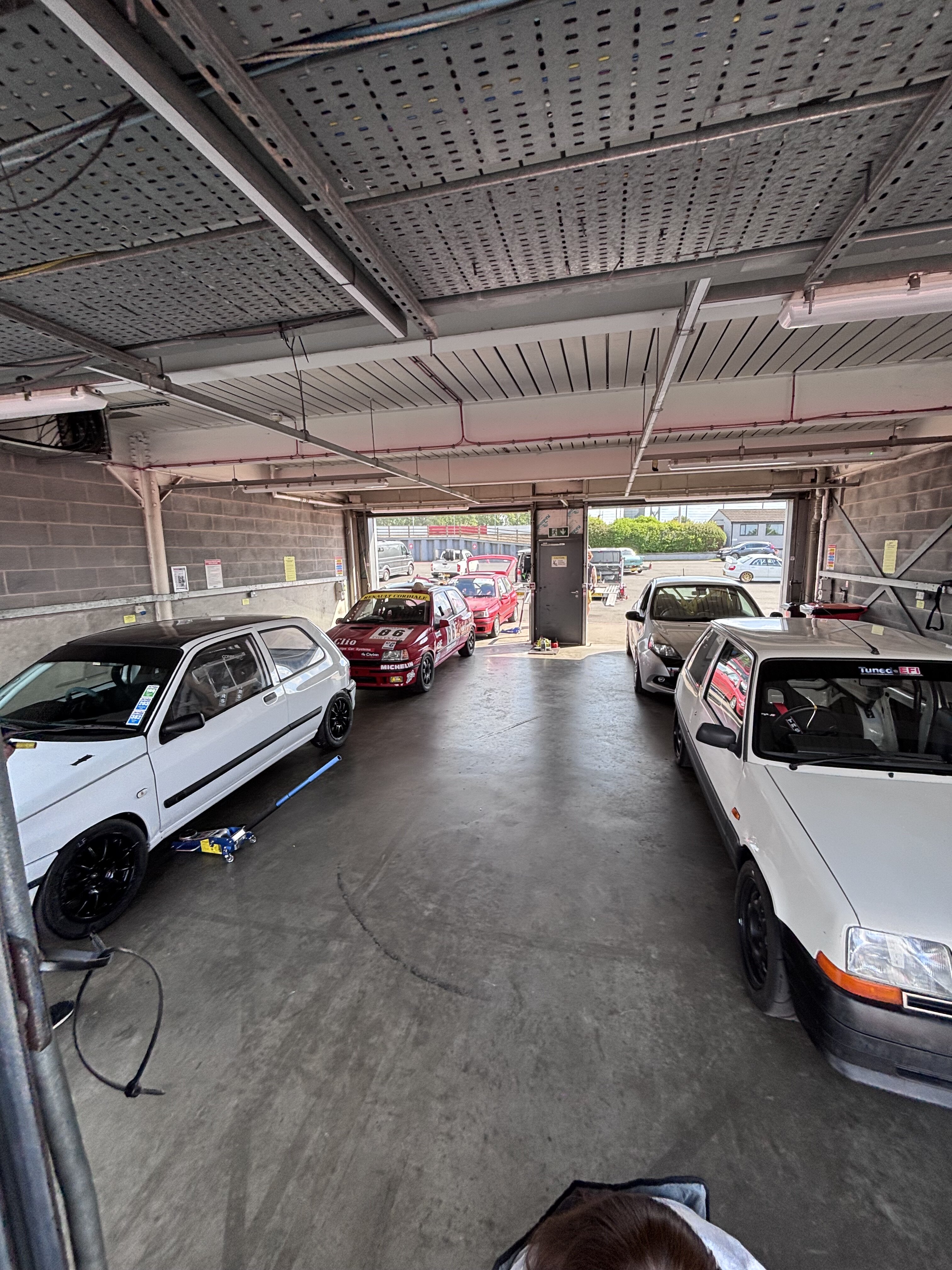

Straight of the back of Mallory, booked onto Donny for an evening sesh with afew mates. Been to donington loads but surprisingly never driven it even though its the track closest to me. Met up with @Dannyafro and had a steady drive down early afternoon.
@Dom4 was booked on aswell with his new mk1
Straight of the back of Mallory, booked onto Donny for an evening sesh with afew mates. Been to donington loads but surprisingly never driven it even though its the track closest to me. Met up with afrodan and had a steady drive down early afternoon.
Didn’t really prep the 5 as it was already track ready. Just check the vitals and away I went.

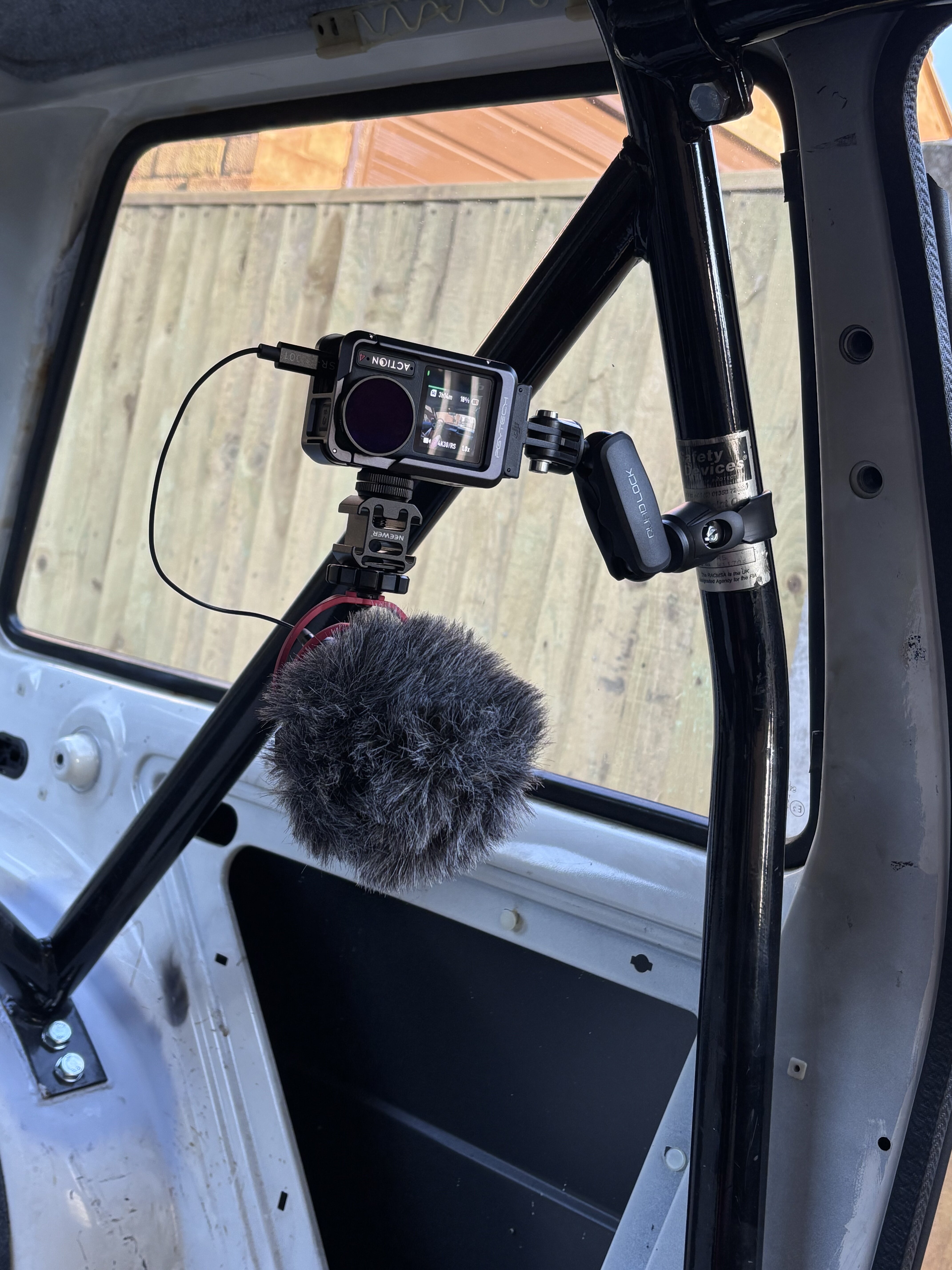

Had the morning preping a quadlock roll cage mount and new rode mic as my old one stopped working, used a dead cat aswell due to me having the window down on every trackday… stops all the wind noise and was loads better than my previous mic wind cover

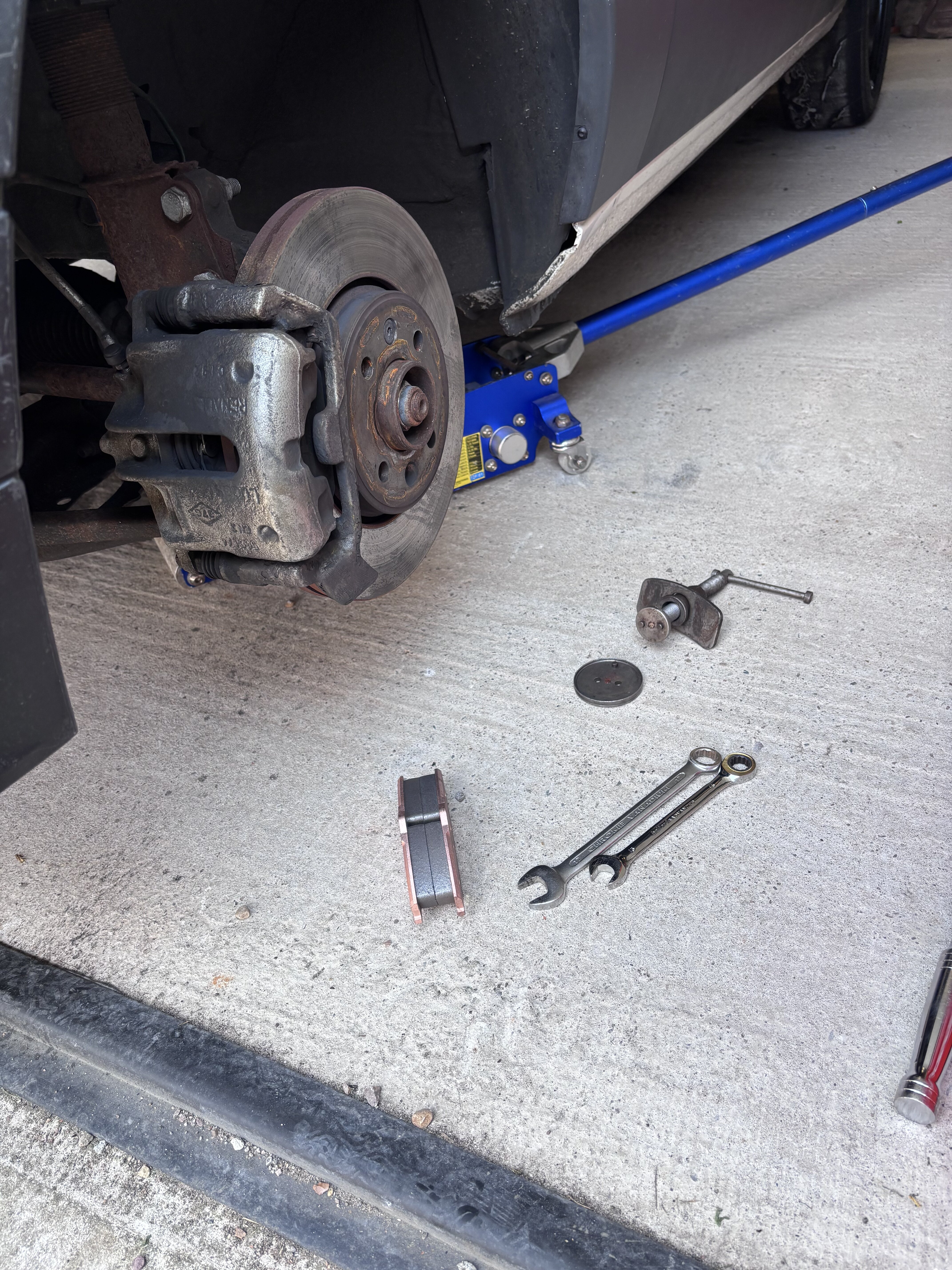

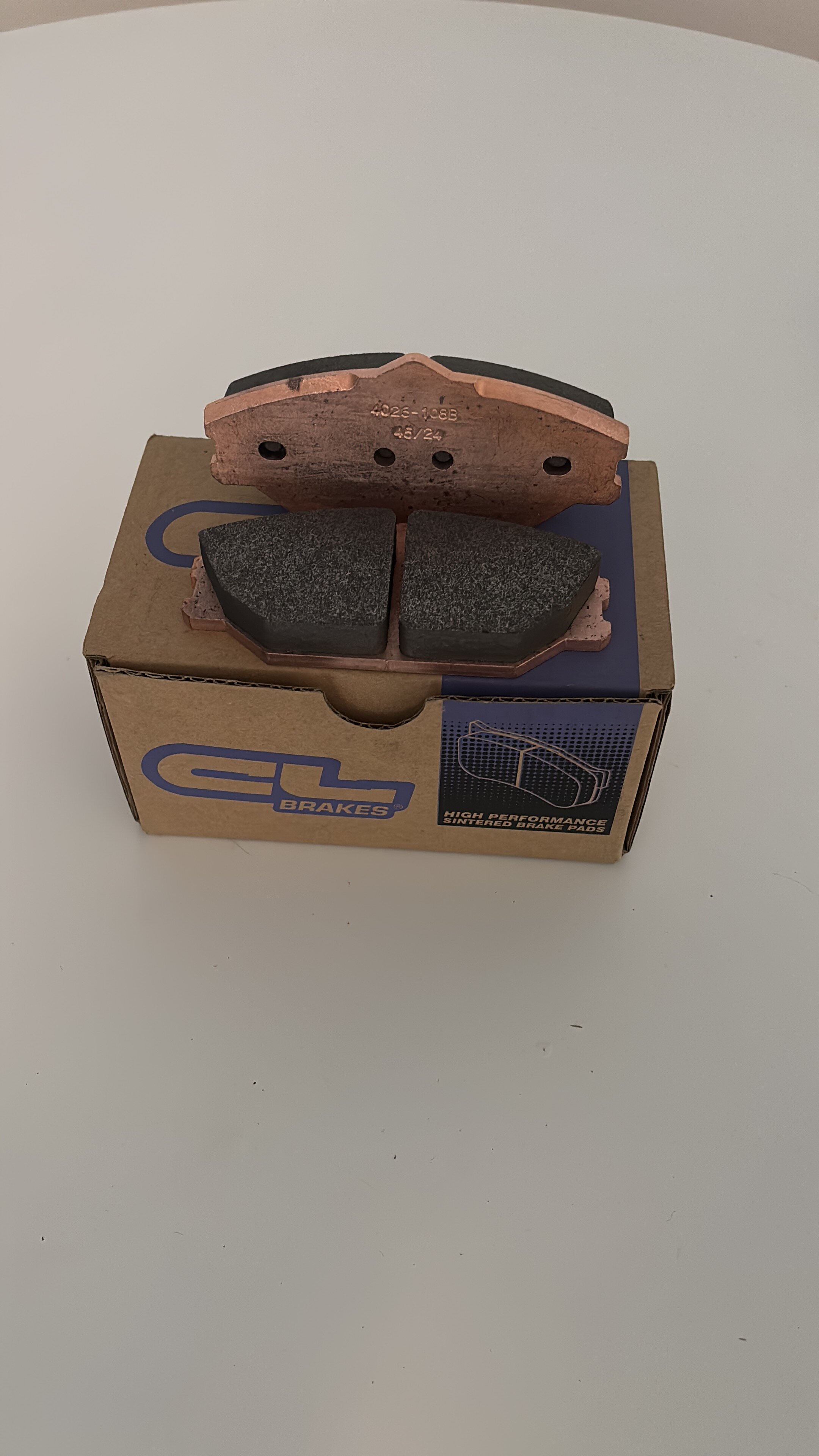

Following on from previously… decided to change my pads to CL RC5+
Whilst fitting the pads @Coops Mk1 sent me a message asking if I wanted a free track day at donny. Obviously couldn’t it down especially just after fitting new pads. Turned up later that day to a damp Donny.
After an hour the track started to dry out
Car ran really well, best it has tbh. Brakes are amazing now and had full confidence in the car to push hard
Had a good evening thanks to coops…. Thanks mate, I owe you one. Next time the 5 is out is next month at Mallory on the 22nd July and CSF. I’ll see some of you at one or the other or both
