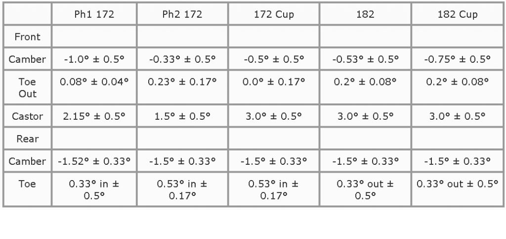

Does anyone have Renault's Specs for how the GEO should be set up on the MK2 172?
Looks like Kwik Fit used the Standard Set up specs so i need to take it back and ask them to change it to the sports spec.
(Along with checking the camber on the front once i have fixed it :/ )
Any links or info will be appreciated.
Ta All
found this:
What i have atm:
Current Settings checked on a Hunters rig:
Front: L R
Camber: -1.53 -2.37
Caster: 3.06 3.19
Toe: -0.10 -0.10
Rear:
Camber: -1.31 -2.13
Toe: 0.07 0.24
